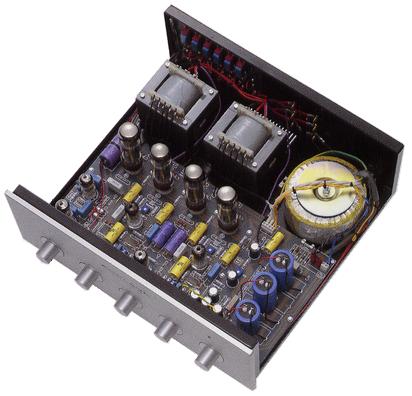

I have a Copland CTA 401 hybrid amplifier.
It´s from the early 90´s.
NOW: I have been recommended to upgrade some of the capacitors in this amp. Especially the yellow caps ( like on the picture )
Should I let it be, or should I do this upgrade ?
Any other upgrades I should think of for this amplifier ?
( I have just changed the tubes )

Hi !
Thanks for the replay .
To answer your question : the tubes has just been replaced .
More info about the new tubes :
Two : SED SVEL34
Three : JJ ECC803s / Hi-Performance 12AX7 Gold Pin
Two : JJ ECC802s / Hi-Performance 12AU7 Gold Pin
To answer your BTW question :
I´m in the process of finishing a pair of vintage altec speakers s and just want the copland amplifier to do the best job it can driving these speakers.
I must admit that I have not much knowledge about tube amplifiers. This is why I am posting - just wanted some opinions if I should do any upgrades on this amp.

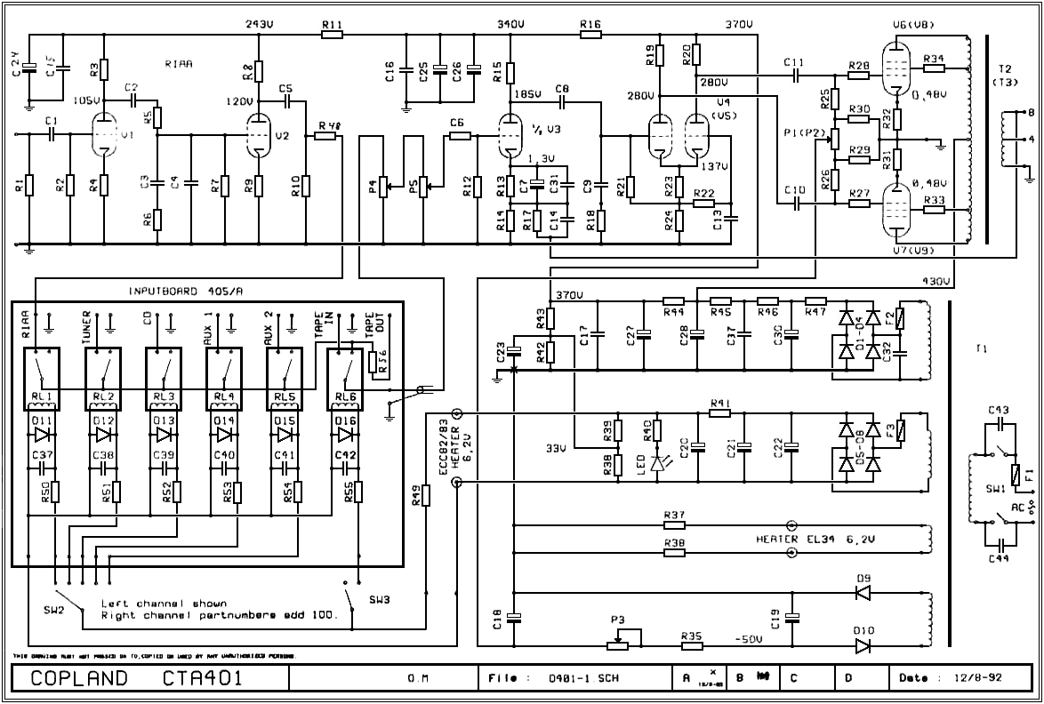

Is there a reason you keep wrtitng "hybrid"? I have found a CT 401 schematic and there are tubes in the audio path, not counting SS rectifiers. Just curious.
As to choosing SE vs. PP amp you should listen to the former. My personal recommendation is SE amp. 2A3 SE amp should be sufficient driving +100dBm speakers. I use 6C4C (6B4G equiv - 3,5 W) parafeed SE amp for 90dBm speakers and volume knob is turned to 2/3 max and is loud enough.

Searched around on the net... I have always thought it was an hybrid.
Copland do make hybrids. It looks like mine is not. Is it a PP or push pull?
