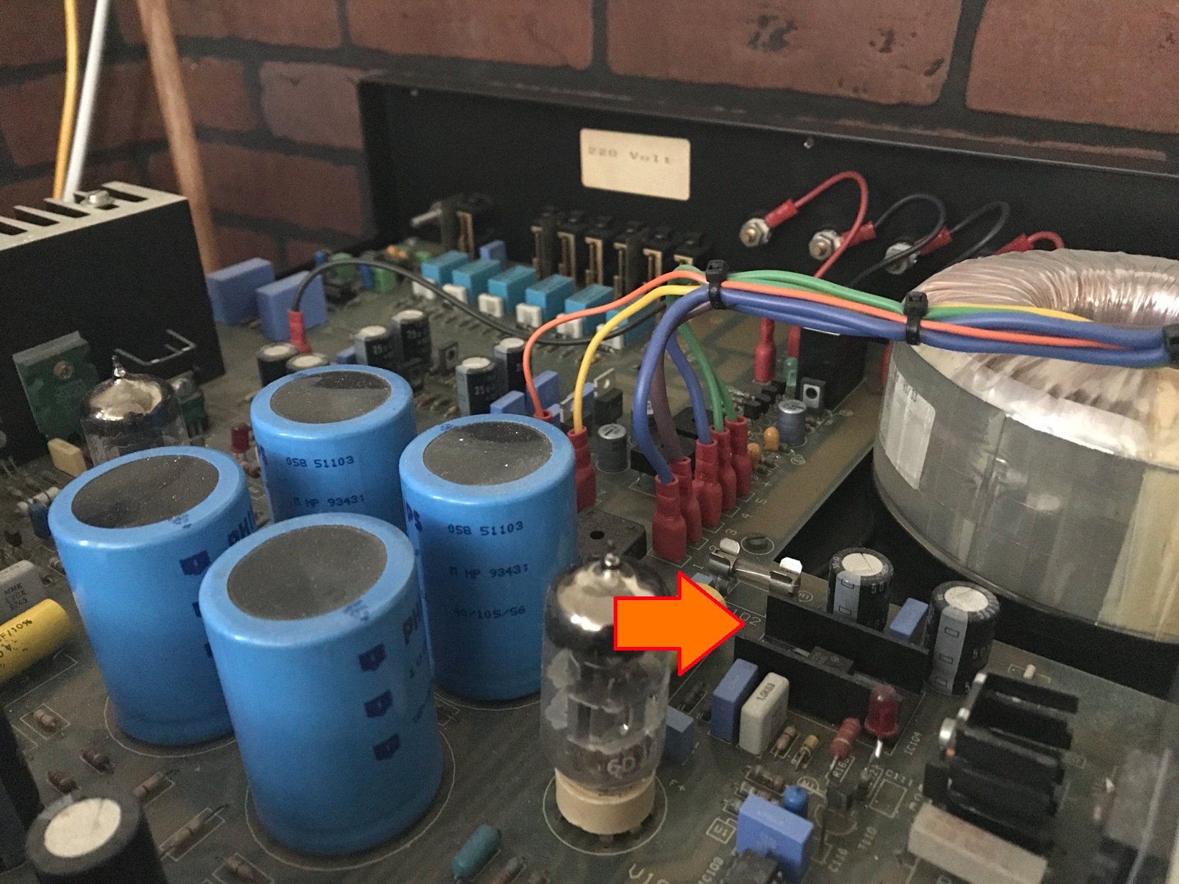

@ limono Which caps did you replace ? Those 10000 uF ? Thanks
No , I replaced three of the small 220uF/50v decoupling capacitors and a zener diode in the regulator circuit. I would replace them all with 105 degree 63V parts since they have 50v rating on 42V rail but it was a repair and not refurbishment. At least that was the case in the amp I worked on .
Another thing: I noted the IC 7806 (regulator for the tubes heating) is missing in mine, pls see the picture. There is a simple bridge but I don't know why, any thoughts ? Tks
