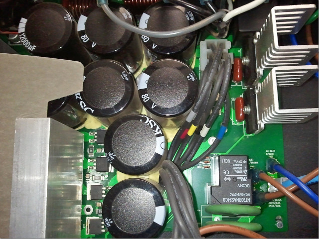

Well I finally got back to the project.
Light bulb was installed as per a previous instruction/ reminder.
I have now rewired the output from transformer in line with tnt pic 3. ie two bridges using One for Pos and one for neg. Each getting the 39vac
Then Spare pins from pos on first bridge wired to neg on second bridge and taken to ground.(star earth). No caps wired in at this point.
So measurements accross each ac input 39v ac.🙂
Measurement at correct v+ and at V- each (Bridge one + Bridge 2 -)
are + 69.9 volts and -69v DC .😡
References to ground/star earth. Not what I expected again.
At no point does the lamp brighten.
I then reversed one of the a/c input pairings to get simlair measurements.
I am now beginning to suspect both bridges are faulty despite measurement/check.? or is it simpler than that ?
I am off to get two more bridges from a different source.

the results confirm that the secondaries are connected out of phase.
Disconnect red from yellow and instead connect red to orange.
Power ON and remeasure the three secondary voltages. r/b, y/o, b/y
Ok now 38.6 on both secs and the
77.2 accross black/yellow
Secondaries are now in phase.
Mark the two joined wires as CENTRE TAPs.
This methodology is foolproof.
Does not blow fuses, does not risk damaging the transformer, does not depend on the manufacturer getting the labeling right.

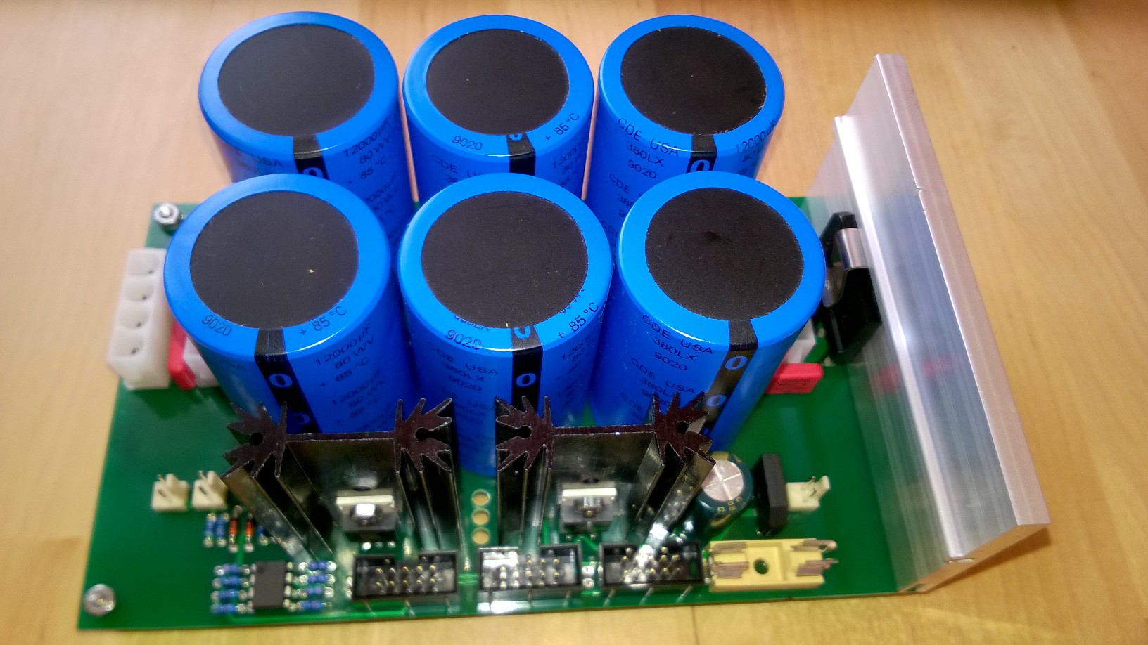

Thanks for progress so far.....Well its been quite a journey.
BUT
Im now assuming that I must use a single bridge based on previous comment ?.
This means centre tap to star earth.
Black to ac top and yellow to ac bottom.
YES? But I think I have gone full circle...
This just gives me the plus and minus 35.4 V DC when I am expecting and require plus and minus 50 ish V DC. Caps not yet wired in

NO ! Centre tap goes to the smoothing capacitor junction point......................

No ! two bridges are used when a dual secondary feeds the bridges separately. Once the dual is converted to centre tapped one MUST use a single bridge rectifier.and would mean using two seperate bridge.
This last para is all mixed up. Forget all that and just wire up a centre tap to a single bridge rectifier.To do this I would have do as shown in diagram under full wave capacitor load

Add the smoothing caps to the rectifier bridge, still with no load.
The bulb should flash briefly at start up and then remain unlit as the caps charge up.
recheck AC and DC voltages.
HALLEYLOOYA
At last,many many thanks, I now have the plus and minus DC of 54.2V.
The right way around.A very quick less than a second lighting up.
Wow I never would have believe that this was the way to wire this up and I am sure not alone.
I will now rewire the original 4 caps for 20k per rail and re install the 2 x 100 Nf accross the 39v ac leads.
I note in the TNT article it also shows a third 100nf .How important is that?.

Don't add any small caps across the secondary windings. The ~~ are also the secondary windings.
Sometimes these extra capacitors can cause some ringing of the supply if there is a step change in current demand.
You can test for this with a scope on the main smoothing.
If you have ringing, then you need a snubber.
A snubber is a resistor to damp the ringing. But a resistor alone will overheat due to the DC, so you need a series capacitor to protect the resistor from overheating.
The result is that we see an R+C across the secondary, IF YOUR PSU NEEDS such a device.
