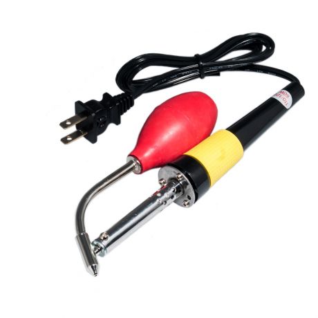

I use a Goot solder sucker with the largest tip on the iron I can fit in the area and iron on full blast, makes desoldering quick. I prefer the Goot over the Metcal rework station.

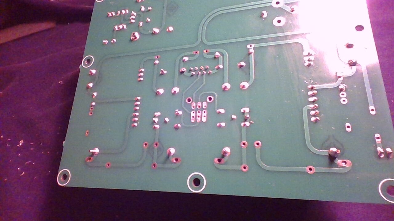

Don't stress them and do NOT overheat them. If you're removing parts with no need to re-use them, cut the
leads off before de-soldering. Adding extra flux before heating is a big help. Flux pens work great for this.
I use a Metcal iron that holds the tip temperature very stable and lately have been working on Ampex boards
from 1977 replacing faulty tantalum caps. Some of the ground plane pads have no thermal relief and it
takes a couple seconds to get solder melted for a radius of 1/8 to 1/4 inch and then use a solder sucker
to remove the clipped lead and solder. Pad lifts are very rare but not unheard of.
I was working on some older Sony consumer grade video monitors that the normal 700° (F) tip was causing
some pad lifts. Changing to a 600° tip cleared that up.
I've replaced caps on computer motherboards that have internal ground planes and no thermal relief pads.
The problem with those is you can't get the heat though the lead fast enough to melt all the way through the
board. For this I use a hot air tool set to just below the solder melt point so you don't 'blow away' any surface
mount parts. I preheat the board with the hot air and then the soldering iron can melt the solder and use the
sucker to clear the hole.
