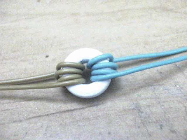

No, thanks, I'm not of that kind of people that has to pay US $54 to get 4 watts of "floating" unregulated DC power... See picture...
BTW: The first big SMPS prototype that I did (2KW, long time ago) already employed 5 fully-isolated active-buffered gate-drive cells that received both drive signals and power through the same drive transformer... I'm tired of winding transformers (the configuration shown produces high leakage inductance but it's OK when you want to pass a few mA of power to a floating circuit with absolute minimum capacitance and no dV/dt problems). I ended up not liking transformers because they take a lot of time to specify and build and custom models are expensive...
