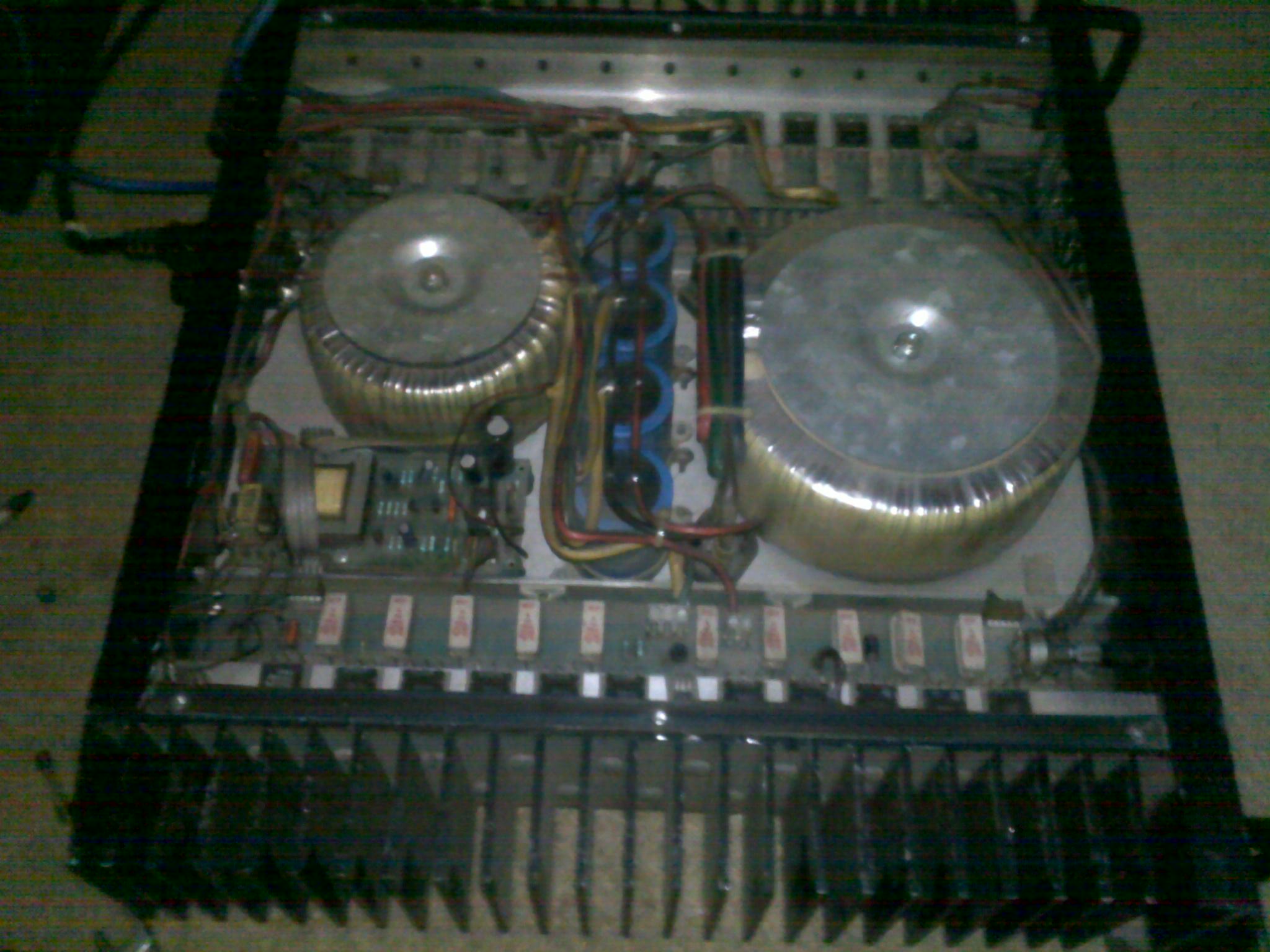

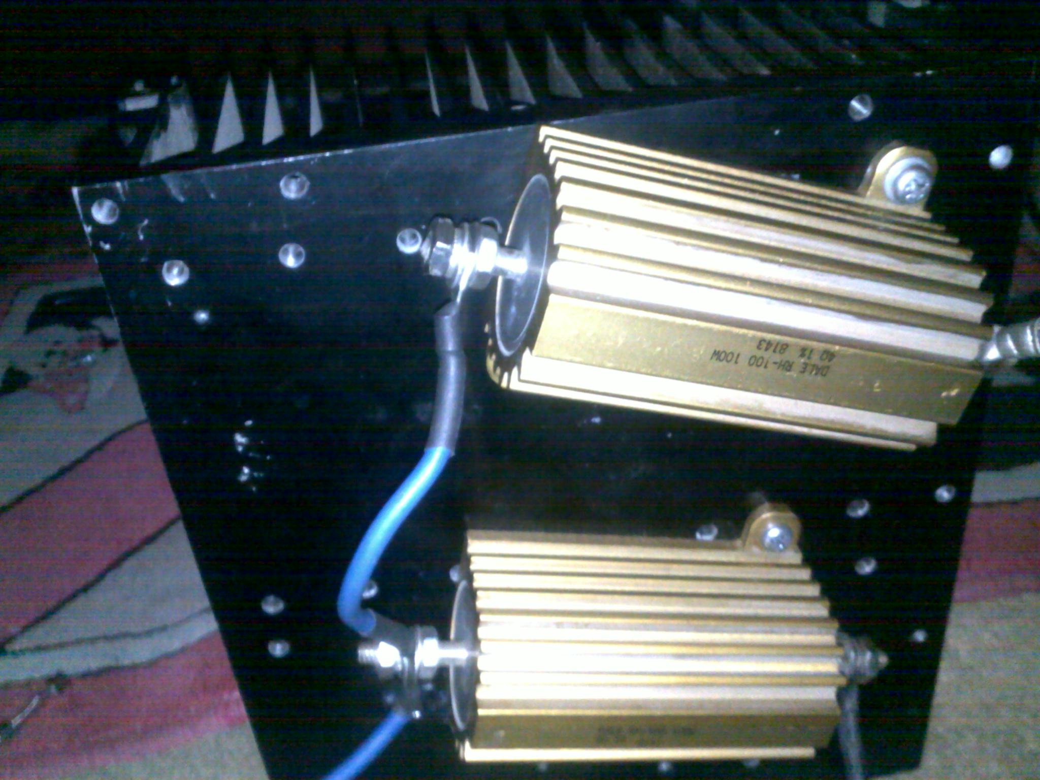

I have removed the primary inputs to output transformer from emitters of TIP35C and connected 4 Ohm 100W Dale resistors on emitter to ground.
I have adjusted the bias so the voltage at emitter is now 16V on each side of pull push driver so the current in each resistor is 16V/4ohm=4 amp with dissipation of 4*4*4=64W in each resistor and 64W in each TIP 36C bank so total dissipation is 128W per side and 256W total.
You can see that the toroid is prettty massive around 8 inch in dia and the smaller output transformer is around 4 inch in dia .
The floating differential voltage on both emitter resistors is OV fluctuates a bit.
I have not done listening tests as i am struggling to maintain bias steady because the voltage starts rising and i have to pull back the bias . i think i need to bolt the resistors with greater torque nuts on both sides.
any comments ?

the heatsink looks quite thin.
Do you have any idea of the dissipation capability?
Now that you have 4A of bias current flowing, how hot will the transistors be after an hour or two of warm up?
What voltage is rising? Bias voltage across the emitter resistors?
or voltage across load resistors?
Load resistors may use a wire that has +ve tempco. If you keep pushing the same current through a PTC resistor then the voltage will rise.
you never fail to impress. YUP that happening.
The 4A 16V setting rises steadily......16.5-----16.8-----in about 10-15 minutes after which i shut it down to cool it.
Now i have made it 2A, 8V to try and it has shot up to 10.5V in about half hour......both terminals....but the differential floating is around zero.
Andrew the transitors heat sink is just luke warm i think never went above 35-40, some transitors are hot to touch though i assume around 50 but not more you can keep touching them..so the driver part seems ok to me...however the 4 ohm dale resistors are getting nasty hot and are not transfering heat to the heat sink...the heat sink is barely above room temprature... i have connected the resistors with just one screw on available holes and will get it to mill to get holes for both ends of resistor and tighten it with high torque nuts for better heat and mechanical coupling .

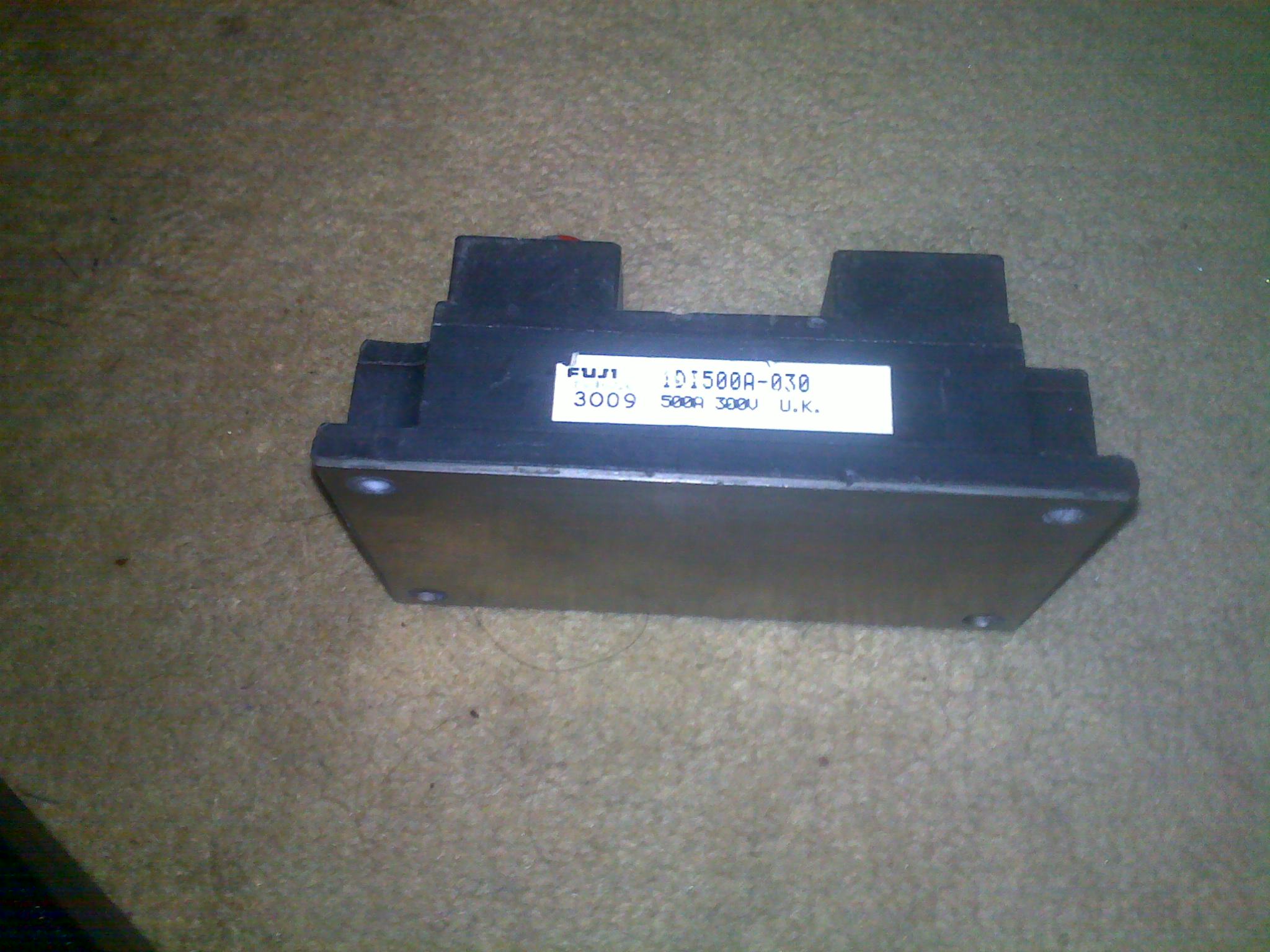

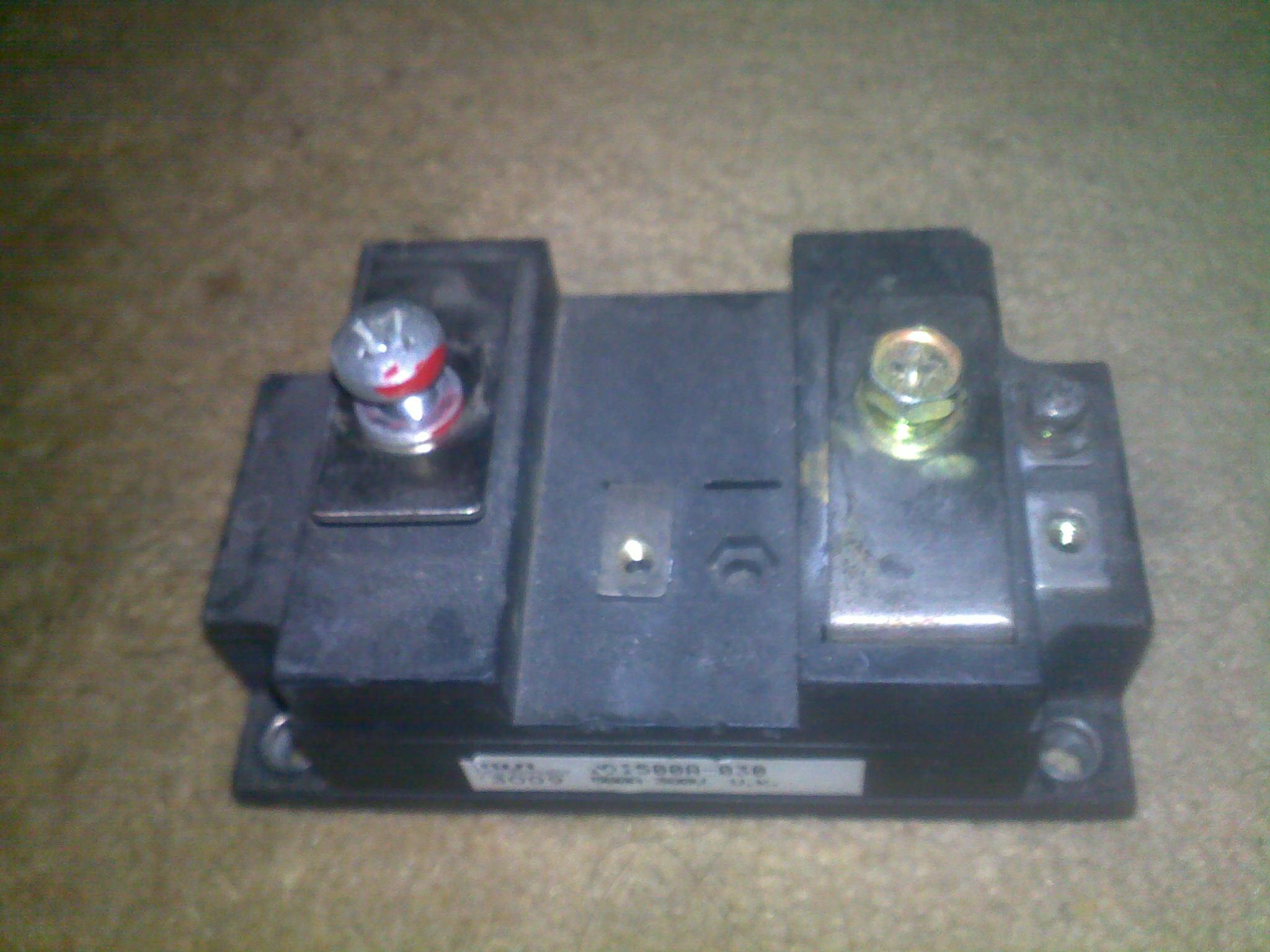

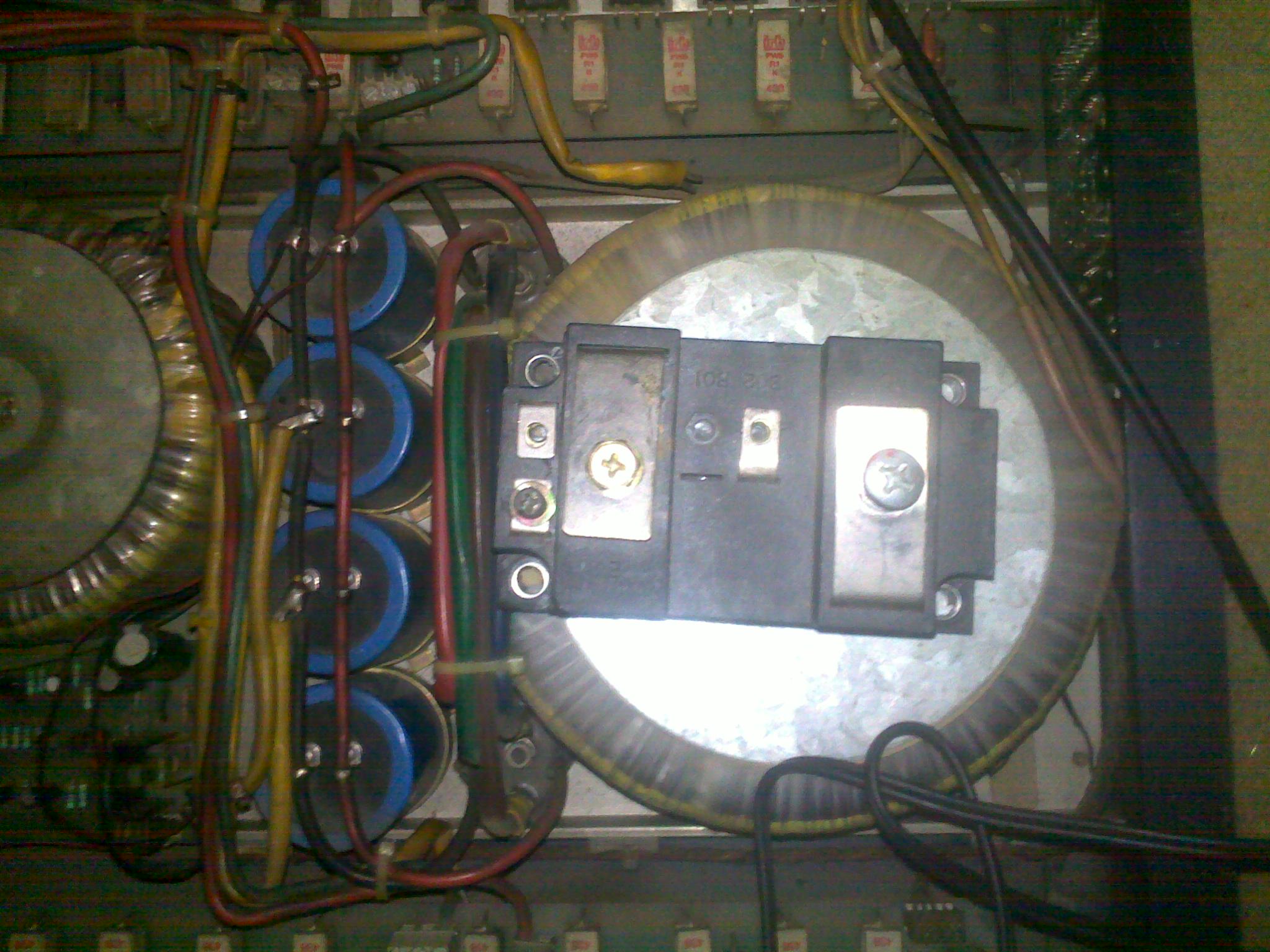

Now can any one suggest should i leave the project to resistive load or take up active current source....i have these module BJT rated for 400A, 2500W darglington modules mitsubishi.. and i can easily be made current sinks for each pull push pair...any comments on going active current sink rather than resistive loading of single ended class A .
here are the darlington BJT power module picture
it can take 400A collector currrent conitnously...total Pd of 2500W.
I have 2 of these and would need 2 more for the other amplifier.
Should it be a good choice for current sink rather than resistors which i assume would give biasing problems of current stablility.

No. the resistors seem not to like even 2A of current. after 45 minutes the emitter voltage i.e=4ohmx2Ampere=8V has risen to 12v meaning the current has risen to 3A.
I think either i would have to limit the current to 1 A using a 16 ohm resistor or go for active current source?
