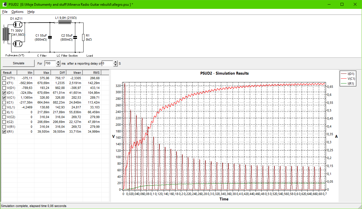

The power transformer primary winding has a DCR that should be included
Read and done, see screenshot :)
The AZ11 has about 5V lower anode drop at 20mA than the AZ41, so there is a significant difference
I understand, but I don't feel like defining the AZ41 from scratch. What my engineer mind says though, is with that voltage drop in mind, we can expect even lower output voltage from the AZ41 - correct?
The idle plate-cathode voltage of the EL41 is less than B+ due to cathode bias, and OPT primary resistance. Max design rating for anode and screen is 300V, but that could be exceeded in some equipment for idle conditions.
So, we design the output stage for a voltage value, which supposedly will be there after the output transformer and such, thus the difference vs. actual supply voltage - that's what I understood and of course, I'm going to read on it more soon.
Yet still, if I may ask you for a simple answer (yes/no is great) - are we exceeding the permissible supply voltage for the output stage/other stages (are we safe to power it up with the predicted ~326V)? It's not that I won't go and educate myself, but it feels better to have a confirmation from a proffessional.

You still need to estimate the idle Vak for the EL41 using your updated PSUD2 B+ level, and the estimated idle current and the voltage drops across the cathode resistor and output transformer primary winding resistance. Only you can fill in all those details. But it looks to me like you are going to be sitting at about 300V. Valves at idle are pretty forgiving - they have to be as mains voltage could easily move idle Vak around by +/-5% (ie. +/-15V).

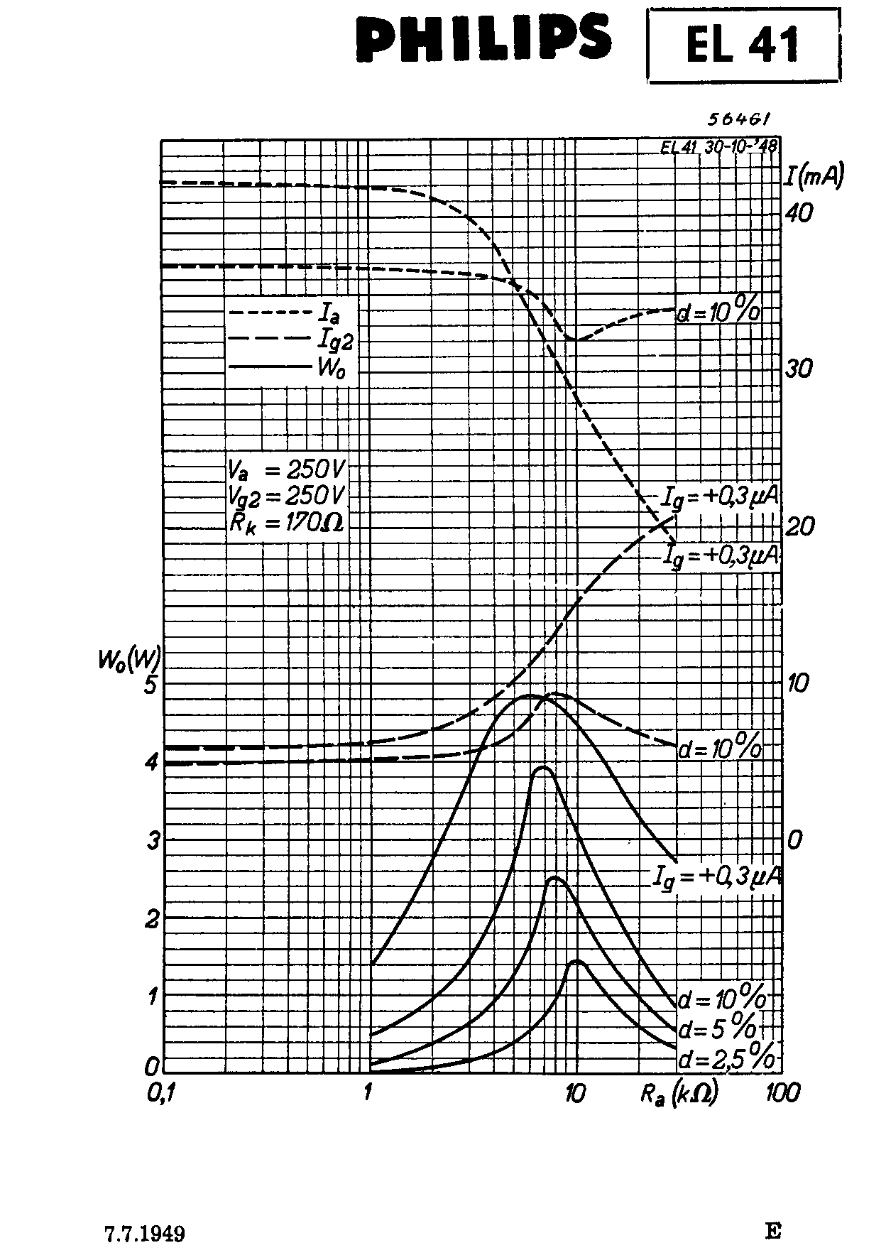

I printed some datasheets of the EL41- to have some graphs to draw on and I did not spot I have some great graphs here, until now - see attached. My brain is also (finally) connecting some dots.
I think I need to figure the exact parameters of the OT (output transformer), because the design process is always relying on its impedance (actual or reflected - I think reflected) and I can't just assume "it must be a 10k one" or so.

With our HT of 300V, and taking the data sheet value for maximum anode dissipation as 25W;
Zout = 300^2 / 25
= 3600 ohms
> And my attempts to draw something, which currently show, that the load line might be less steep than the datasheet 7k one - and I think it means higher gain; though it's actually unknown without the OT actual (design) impedance.

The transformer primary has very low DC resistance so only a few volts will be dropped across it, which we usually ignore. Therefore, the quiescent anode voltage will be the SAME as the HT, no matter how much quiescent anode current we choose.
and also:

Looking at the Va/Ia graph, at 2k we would exceed the maximum anode dissipation, therefore I think we may consider my previous results unreliable. Still, thank you very much for your input!

Datasheet specifies 7k Ra. I have:
a) 4Ω into OT -> 7.2k reflected (1,8k) or 8k;
b) 2.5Ω into OT -> 4.5k or 5k, but normally we wouldn't calculate it for DCR.
My guess is: The design is fairly close to the datasheet circuit.

...but not least - with around 325V on B+ we are exceeding the max ratings by the 25V. Is it okay?
Soon I will try to power up the supply section, see how high it goes with minimal load.
