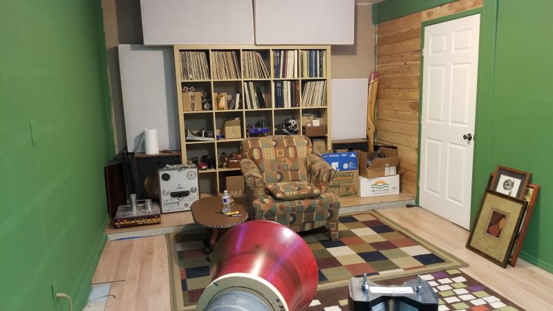

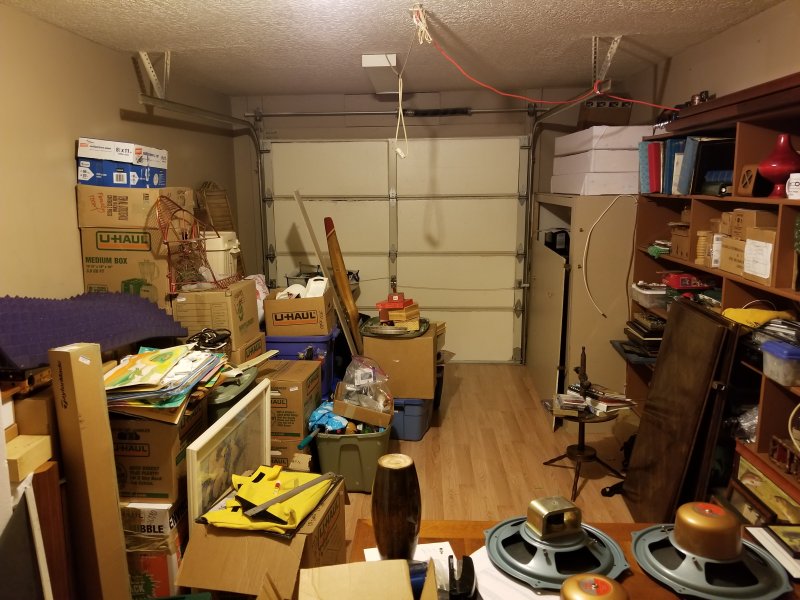

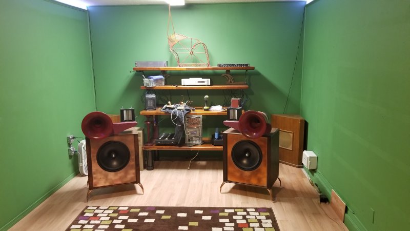

Here is a little bit of inspiration for you G. We moved into this place three years ago and I turned the third bay of a three car garage into my listening room. I am just now setting up my system but I think it turned out well.
Bass traps, first reflection absorbers, art work and it should look good.

The biggest thing that can be done to a room to improve its acoustics is to vault the ceiling.
Roof might be tricky, but you could get some benefit by making the wall in front of the window angled. Won’t make for a great closet, could be record shelves.
