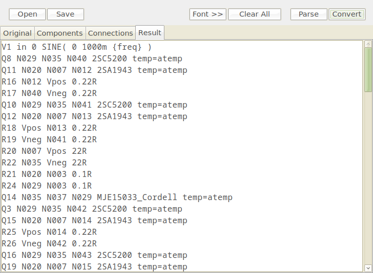

I am debugging and testing the first version of the software. At this point, the software only supports the most common components. Other components will be added in later versions.
My Integrated Development Environment is the Lazarus free suite. To compile (get an executable from source code) the software install Lazarus. Yes, I know Lazarus is a large project and it takes space to install. I am attaching the project source code for those interested. Be warned that this software is still in its very first stage of debugging and is experimental.
The active code which does the actual conversion is in in Form1.pas. To use the application load an Accel netlist. Create this using LTSpice export function. To use the software first press 'Parse' and then 'Convert'. The Accel netlist is loaded in the first tab. In the second and third tabs the parsed output is displayed after pressing 'Parse'. The fourth tab is used to hold the converted ngspice code.
My version of LTSpice, which is not the latest version, does some omissions when an Accel netlist is exported. Please, check the Accel netlist for errors of omission. These are easy to spot and correct.
I humbly ask readers to post working files for both LTSpice and their equivalent for ngspice. This will help me test the software on real examples using known ngspice files that work. Presently, the software does not know how to get the number of pins in an integrated circuit and what to do with a subcircuits. It is also not able to handle subcircuits. .MODEL declarations can also be automated. These are ideas which can be implemented in later versions.
I found working code examples online.
Now I have to add MOSFET and subcircuit support. I can also create more schematics using more components with LTSpice. At this point it is working but it definitely needs more functionality.
I am uploading the latest source code for this converter. Please, be advised that this software is still a works in progress. However, for converting Accel net files the code works but there may be syntax forms which may not yet be supported.

I added more functionality to the GUI application which translates Accel net lists produced by LTSpice into ngspice net lists. The functions which do the conversion are now encapsulated in a class of their own. I also added a syntax checker for Accel net lists (produced by LTSpice). The syntax checker needs more work, but it should do its job of detecting errors. Syntax checking works independently of other functions of the application. This was done to allow partial conversions even for net lists with some errors. The first line which is a comment is omitted in conversion. Do not include this line for conversions.
The executable produced by compiling this source code is about 25MB. For a much smaller file do not include debug information. That should result in a much smaller file of approx 6MB.
