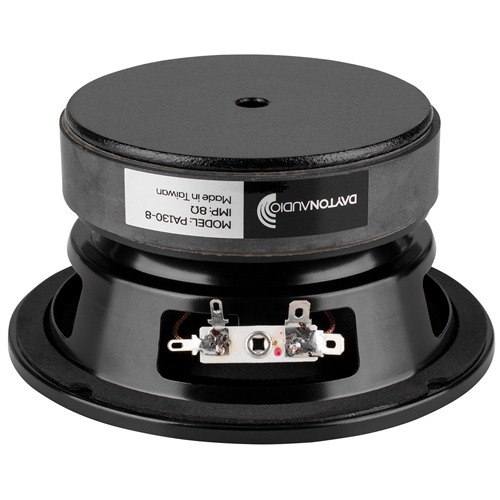

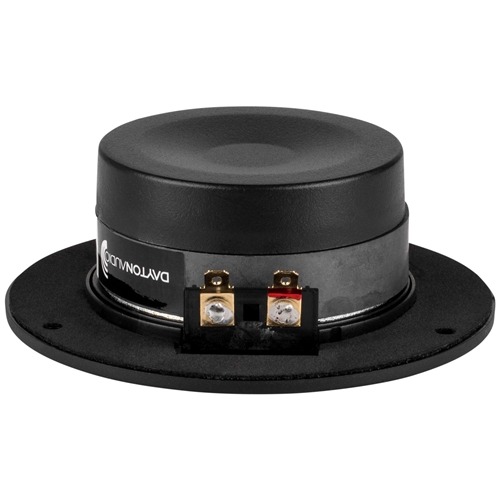

I can answer the first question.
The PA130-8 has an open back and must be in its own internal enclosure so that it is isolated from the back pressure of the subwoofer.
The DC28F-8 has a closed back so does not require to be isolated from the subwoofer. It can occupy the same enclosure as the PA130-8 if you like.

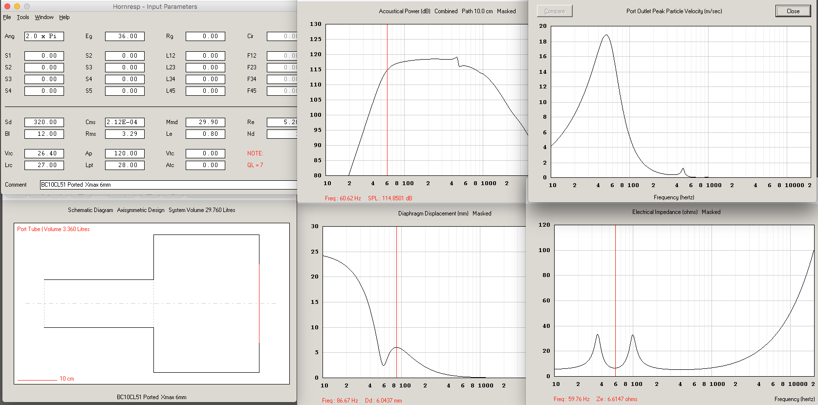

Also, what is your suggestion for the type of enclosure? Could a ported enclosure work within my size restraints?
A ported cabinet will work with your size restraints.
After excluding the volume taken up in the interior box required for the midrange driver, volume of the woofer, the port, and 1/2" cabinet wood and bracing, 31cm x 49cm x 29cm should leave around 26 liters net volume.
A port with an area of 120cm2, 30cm long should give around 59Hz Fb (box tuning).
With 36volt input, about 200 watts into the 6.6 impedance minima, excursion just reaches the B&C10CL51 Xmax of 6mm above Fb. Ideally, a HP (high pass/low cut) filter would be used at around 50Hz to keep low frequency excursion (speaker flapping) under control and useless power wasting.
The B&C10CL51 Xlim is around 12mm, suspension limited, in real life the speaker will never have the excursion below Fb that this Hornresp simulation predicts.
