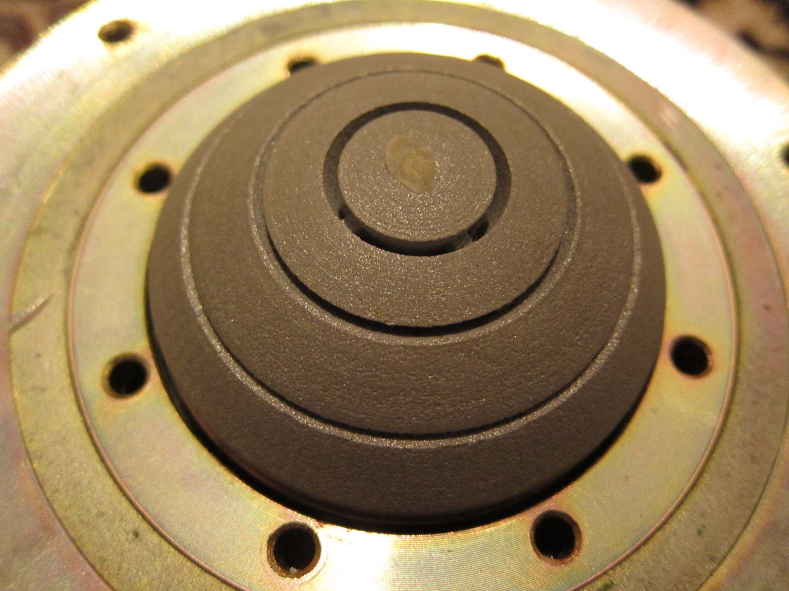

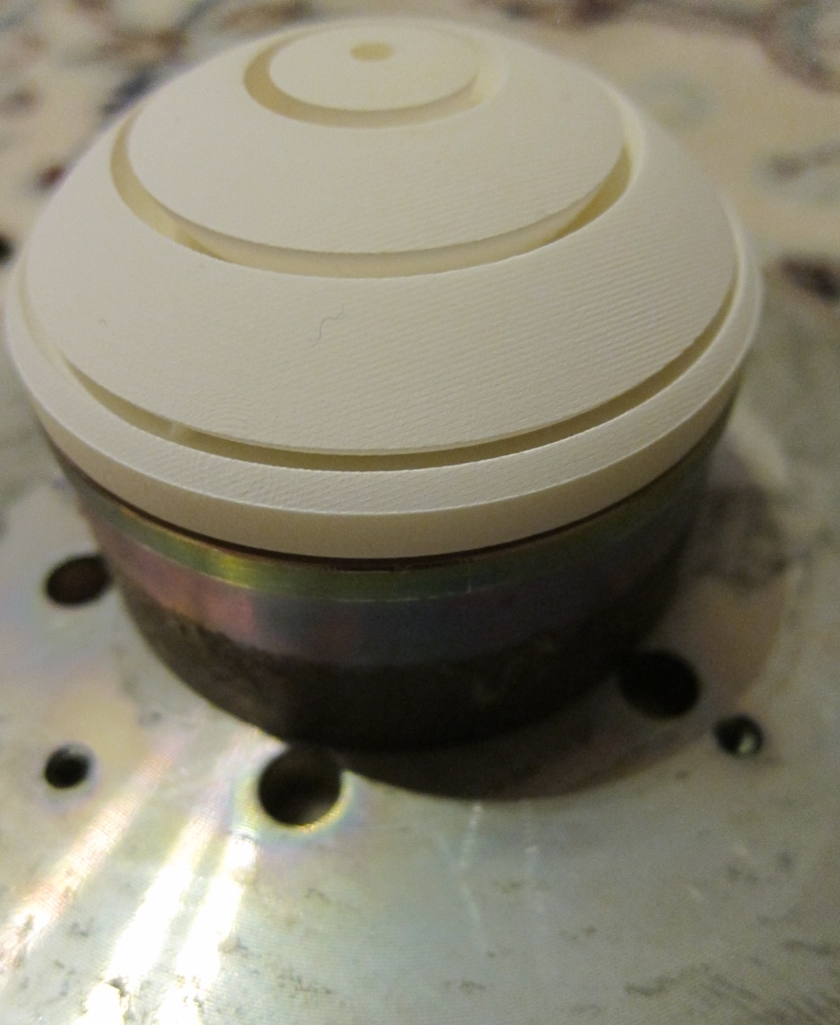

Well, no interest stirred, it seems. Hence lazyly on my end ...

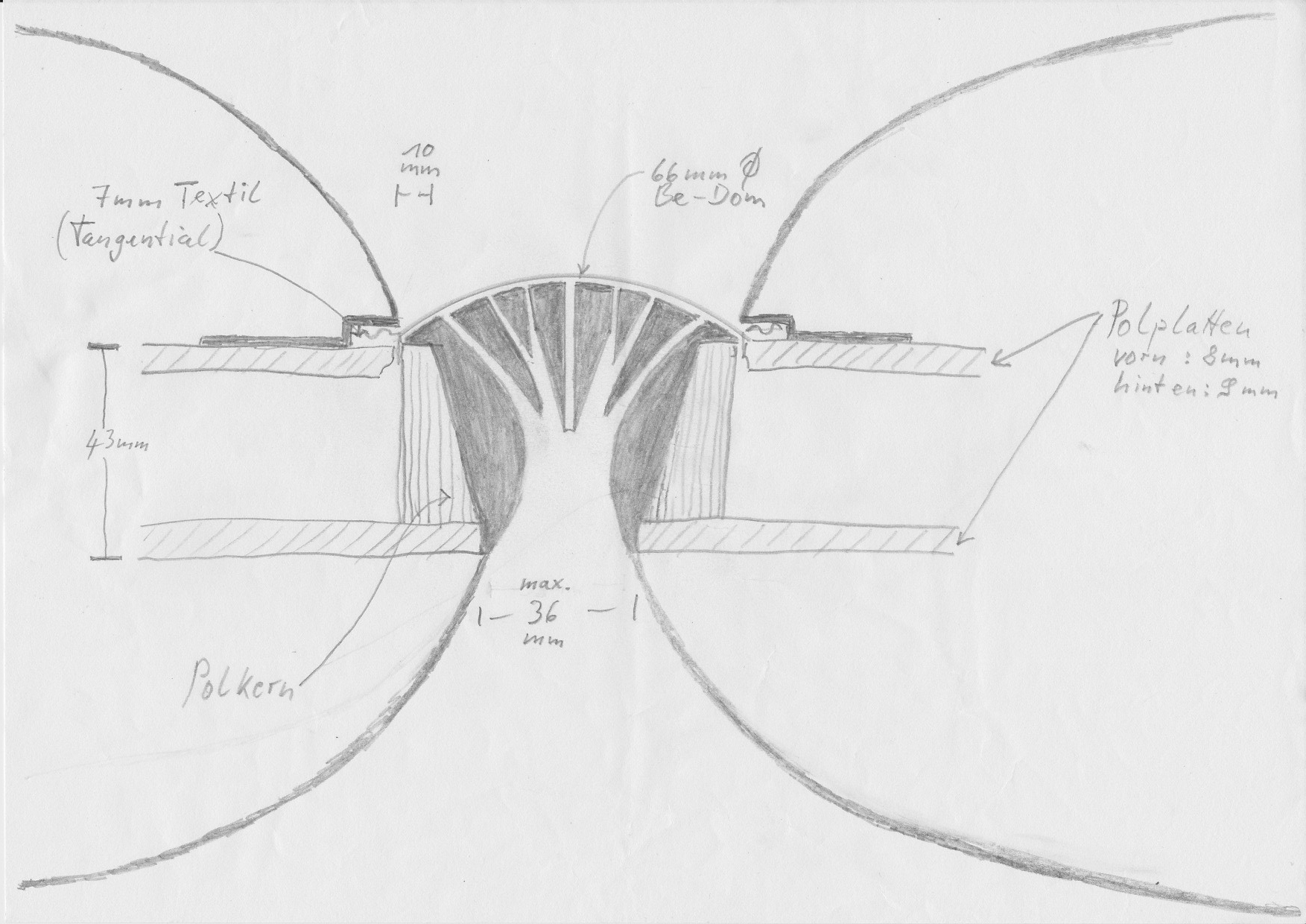

I made a dirty hand-drawing of the arrangement i had in mind.
Horns should not necessarily need to be mounted simultaneously😉

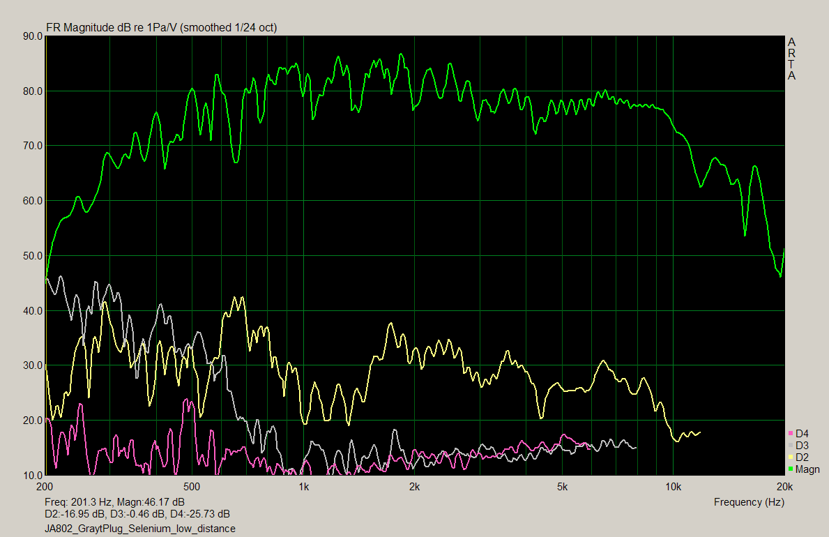

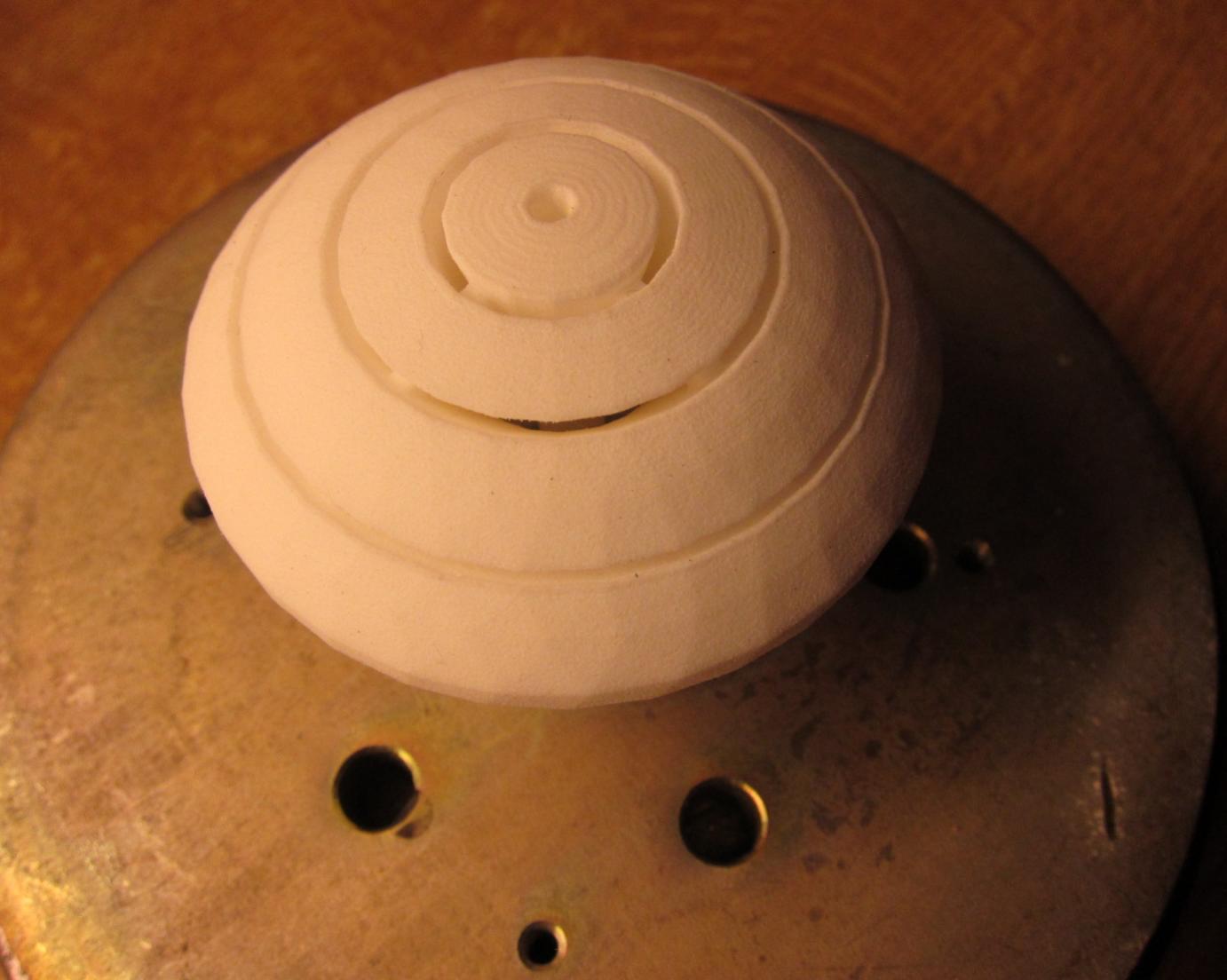

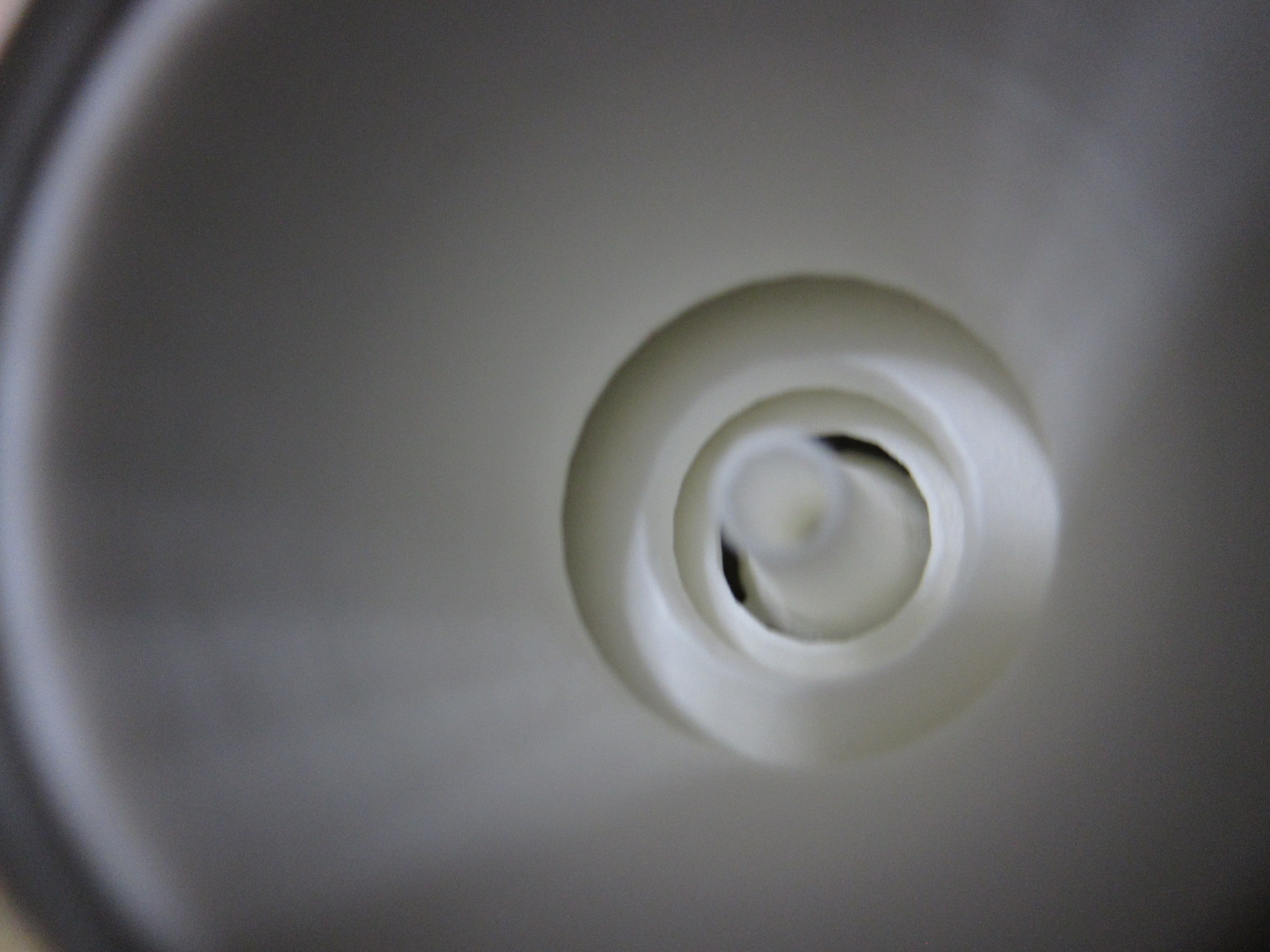

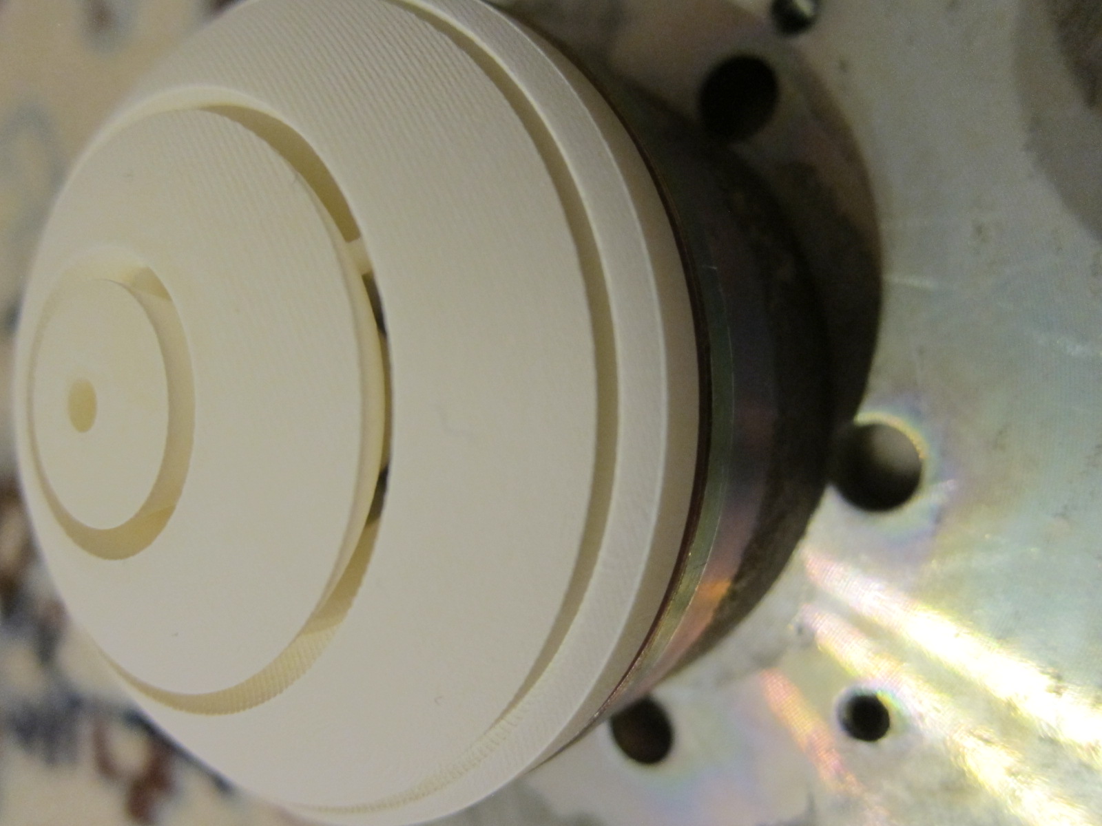

Also attached pics of two similar phaseplugs i had made in polyamide and alumide plus their results with a Selenium 1.4" plastic horn.
Plugs are slightly different in progression of the air channels. Channel location is same.
Next will be some variation of the channel entry location under the dome.
Ralph
Ralph

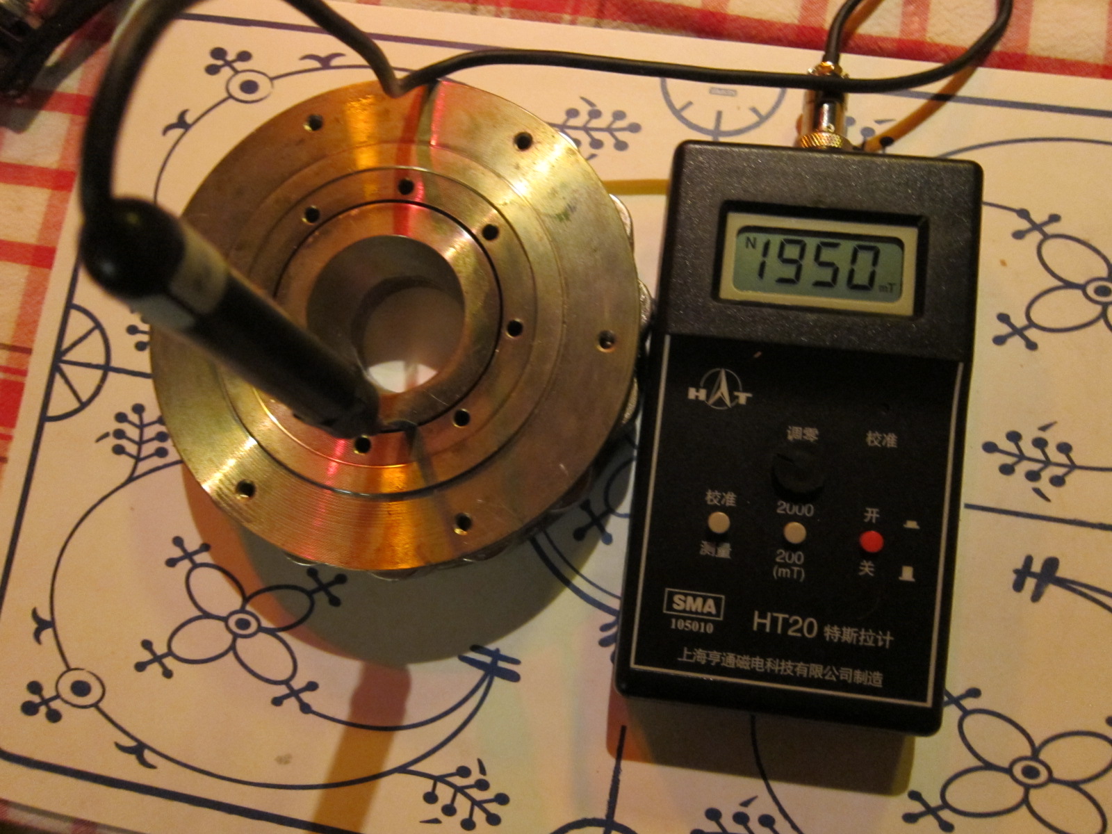

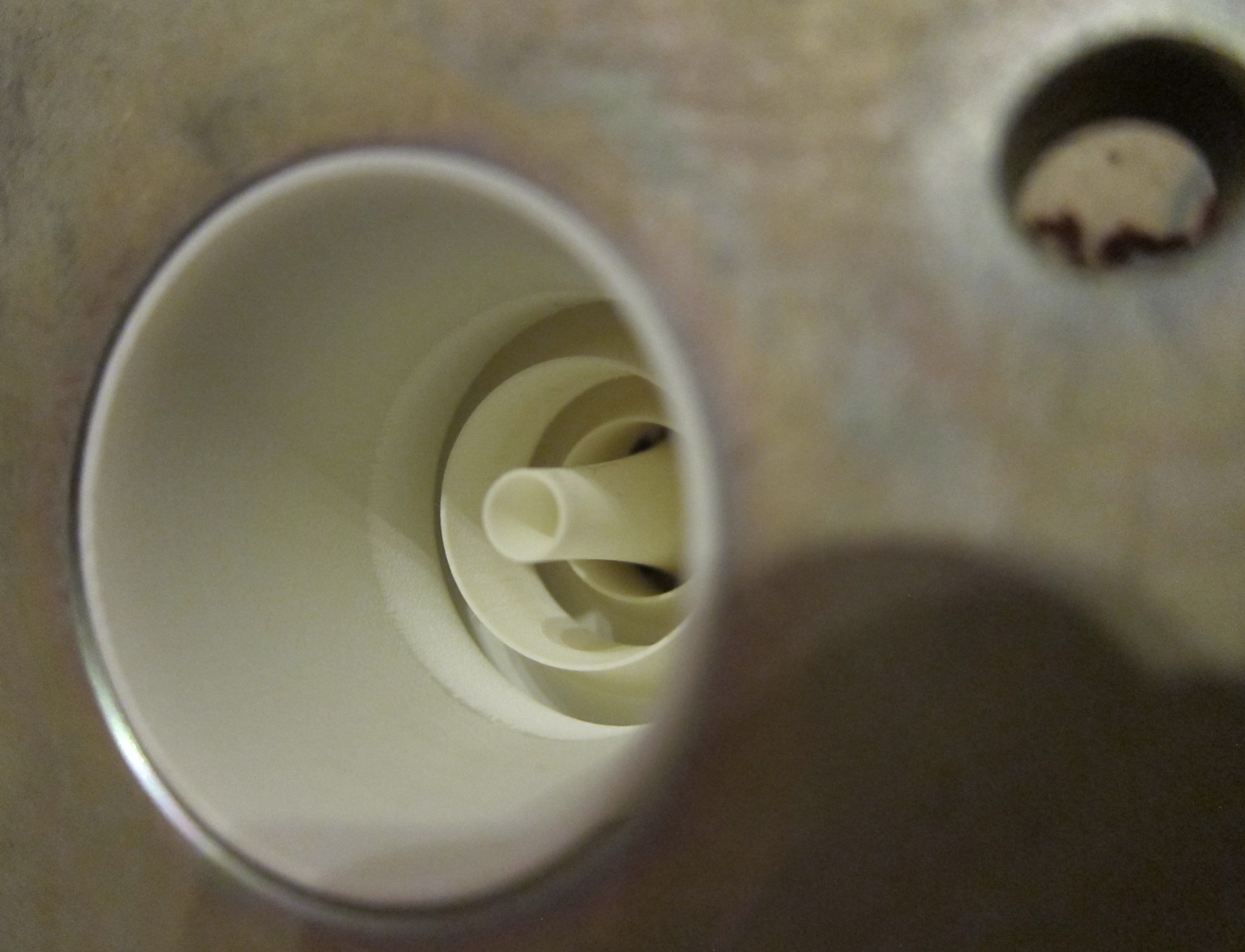

Next (fifth, actually) iteration did arrive today. Haven't measured it yet, as this one is wee bit shorter in order to accomodate for a trial using 20mm high N52 "tablets" instead of the original 25mm high ferrite ring. That ferrite delivers about 1.7T on average of several JA-801/802's measured. Same as JA-6603 or JA-6681 ferrites do using smaller ferrite but narrower gap.
Quite nice, given the gap accomodating the coil is *very* wide (sooo wide my cheap'n'cheerful Chinese HT20 fluxmeter's probe just fits in). Printing quality of this "MX3" material is better than the Polyamide (which was better than the Alumide). All nice then, but the Neo tablets seem to be stuck in Amsterdam acc to tracking info. Hope they're not stuck to the wall of the carrier craft for good
Anyways, will post ARTA results here once the thing speaks...

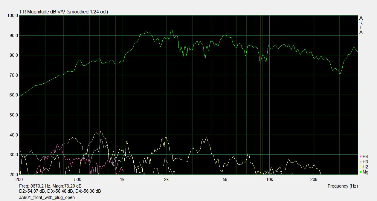

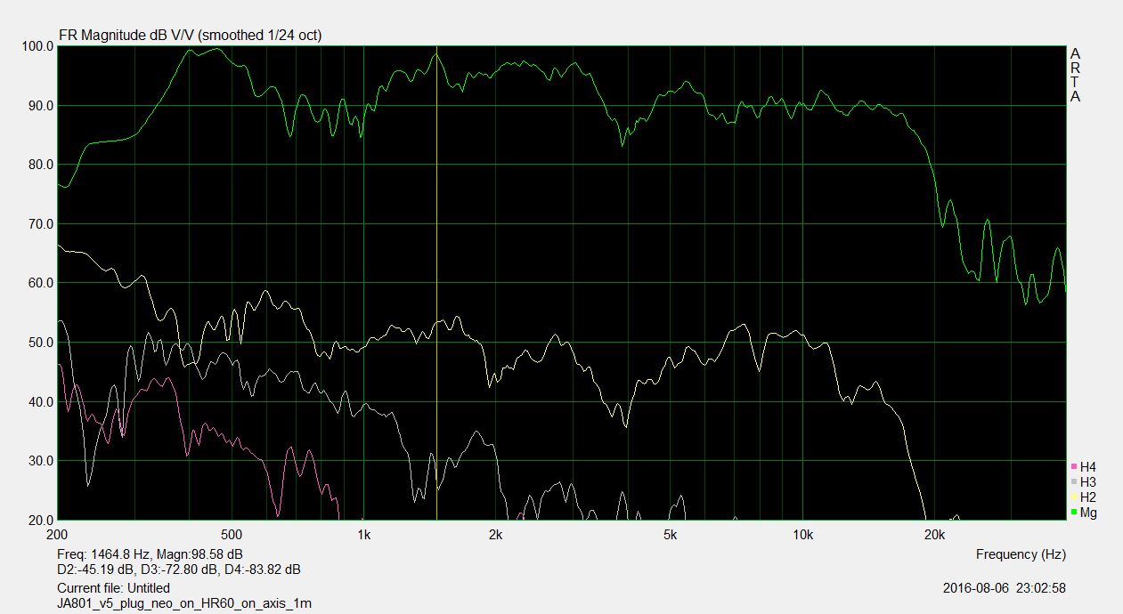

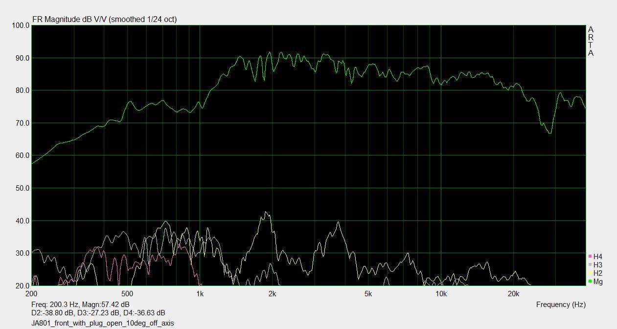

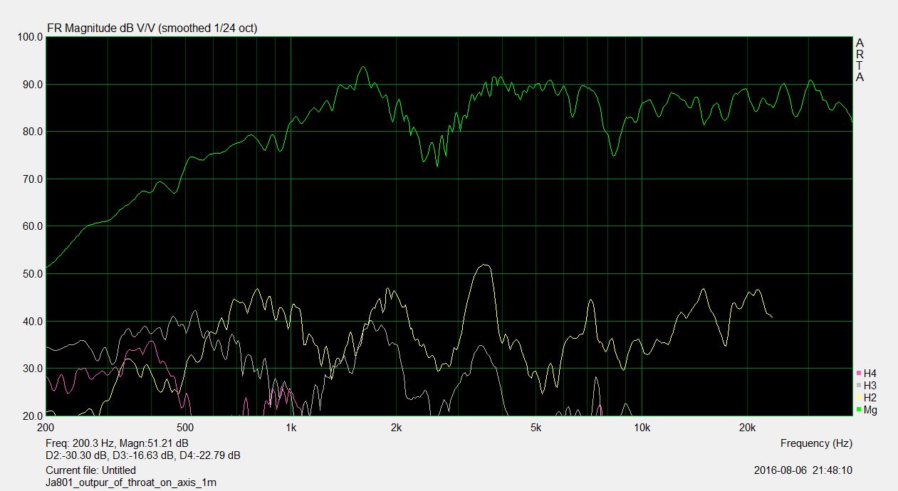

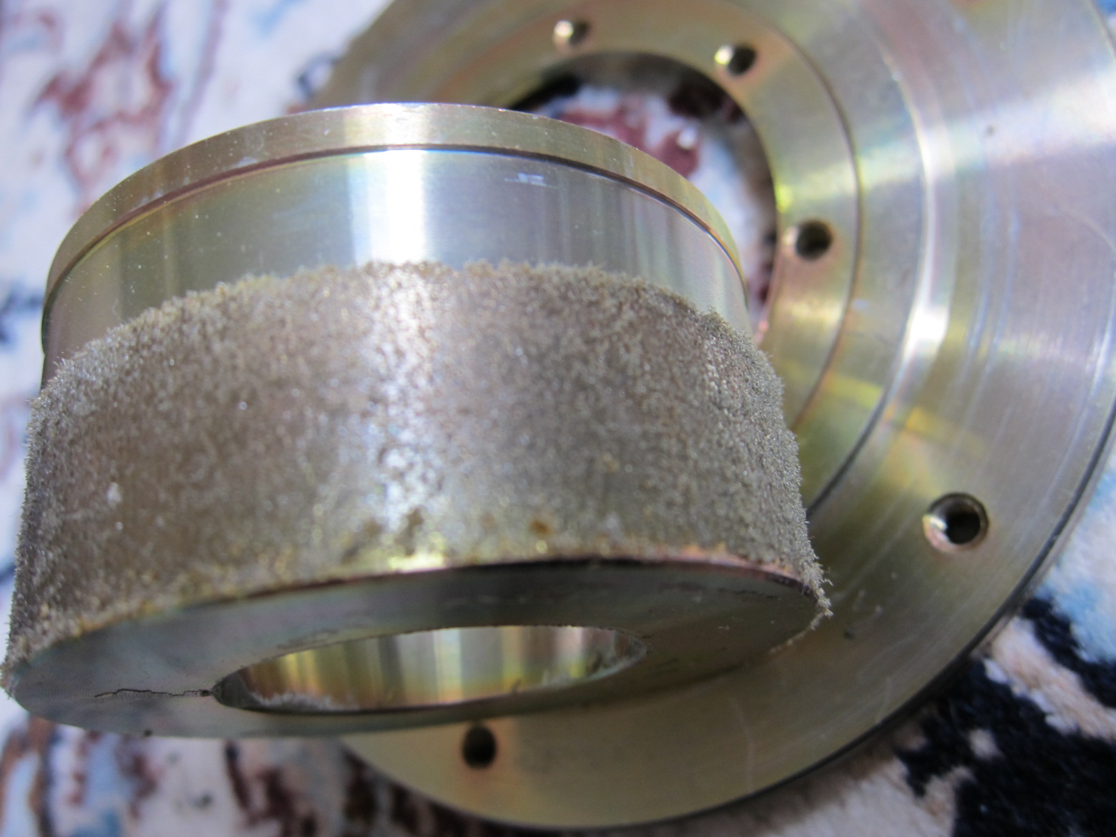

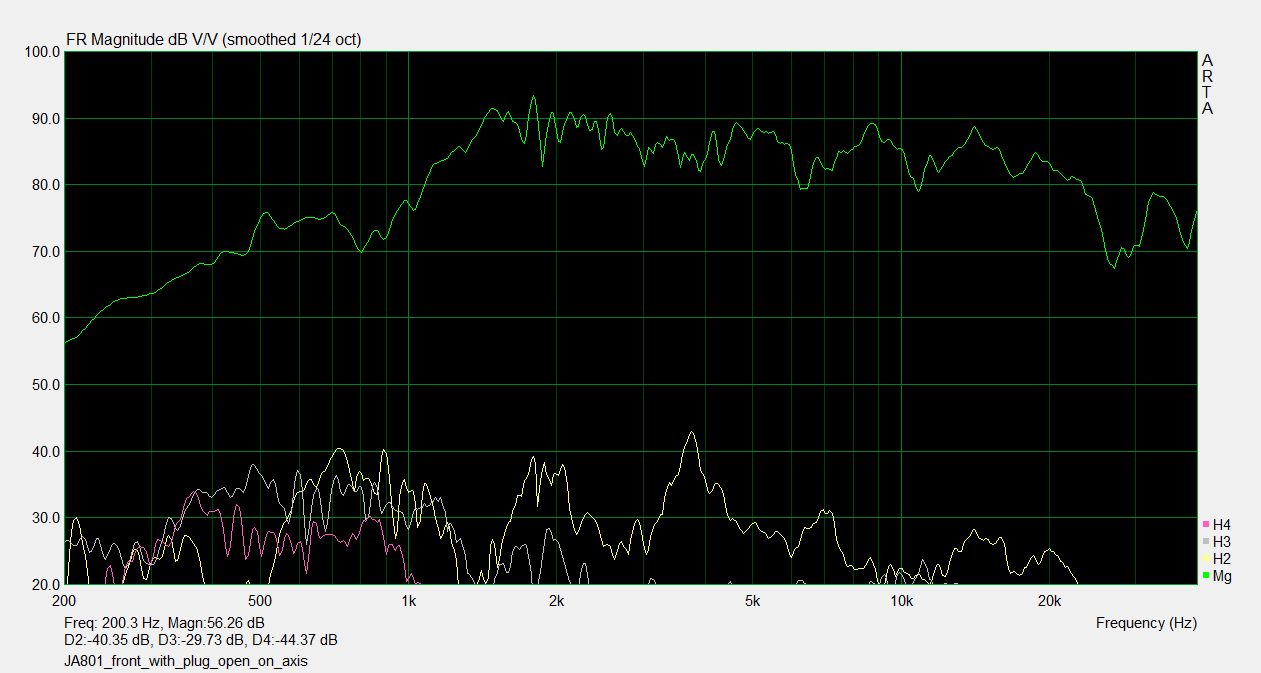

Alright, a pair is completed and magnets for another pair are already here. Results are a bit of a mixed bag...
Field strength went up to ca 1.9 T, and with more B you get more high-range output. This is very evident in the three measurements i did on the "normal end" (i.e. dome side) of the Yamaha JA-801. The phase plug was in place. Remember, the JA-802's would even reach slightly higher up due to lower moving mass. A fourth shot shows the dome side again, but with the orig. fiberglass stuck up the 'plug and the orig. metal cap (incl it own fiberglass filling) fitted over the plug output on the rear of the magnet.
Also attached in next post is a graph measured on axis, but mounted on a horn, SPL is good til 17kHz. This is on a 55x29cm EV horn -- not the 39x19cm exit Selenium horn as above
The dip visible just below 4 kHz in some of the plots might be attributed to a resonance in the magnetic system. The neo magnet is totally undamped internally and offers a ca 26mm path from voice coil to the magnet backplate and also (through eight 7mm-holes in the top plate) a ca 30mm long path from suspension to the magnet backplate. The original ferrite magnet has a layer of 1cm wide and 1.5cm high foam around the pole piece (and hence behind the vc and the suspension ventilation holes).
Why do i get lower output below 1.2 kHz as compared to ferrite? Fellow ETF'er Dietmar experimented with home-rolled compression drivers quite a bit. His guess is that the volume behind the coil/suspension is too big. I bought polyester resin and will fill the magnet right up to the top plate. Will post response graphs again if the lower end improves. My hope is for at least the 3.8 kHz resonance to disappear after that mod...

The "backchamber/coil" thing is what i was looking at. Those are 24mm and 30mm (48 / 60 both ways). Not sure what could be 45mm long single way (or 90mm both ways). The way through the phase plug itself would qualify. But that is an open ended pathway.
The two ways i was thinking of are under scrutiny, as i filled up the empty space inside the magnet altogether with resin.That will allow a backwave to the coil or suspension only beyond the audible range.
Unfortunately, some of the resin got into the gap and i haven't found the time to scratch out that seriously hardened stuff. Will run some meas once that's done.

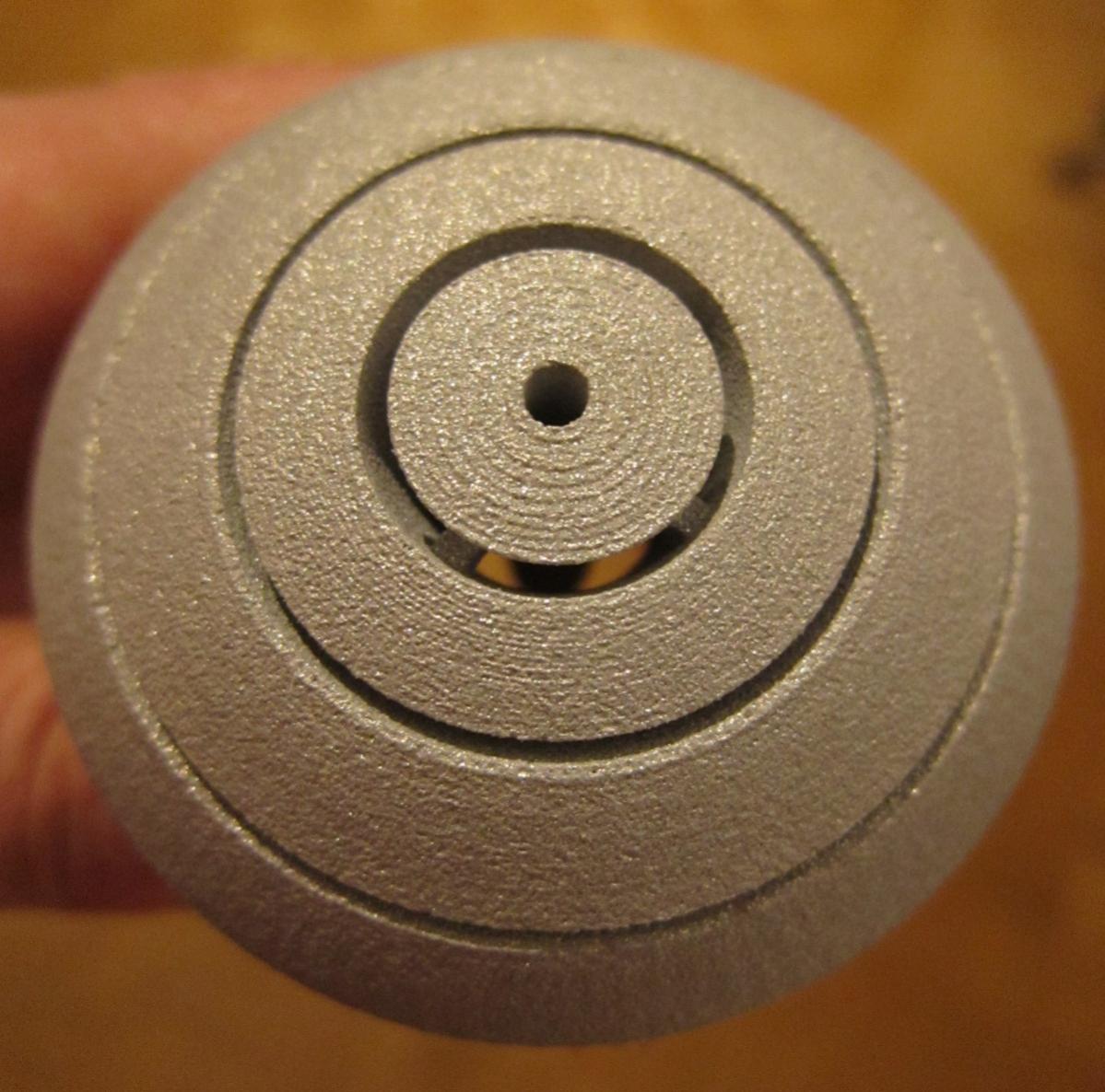

Three more designs were made in the last twelve months. Aim was to find out if there are audible fundamental traits to three of the 6 or 7 fundamental phase plug design "schools".
Each time, my chosen Yamaha soft dome motor (in modified form with 3/4" high NdFeB pills) was chosen. That yields two advantages:
a) independence of the variance that i encountered with non-centric backplate mounting on the many a stock Yamaha JA-870/JA-0801 driver magnet structure
b) ca 6mm shorter path from the Beryllium into the horn's throat.
If it wasn't for a), i would have given in to requests to make one of the earlier annular long versions available for the orig. ferrite structure available for order directly from rapidobject or 3D-Hubs, where i found great support for my model's "issues". Having 20 or so of the Be-domes, that admittably limited statistical sample size would lead me to say your chance getting a suitable mag is 15%. Another 15% allow mounting of the phase plug with an hour's worth of manual labor with a standard iron file😱, tape on gap😱
An new interpretation of Henricksen's (some say Hilliard's) radial design with a bit of annular thrown in for good measure:
Here's the take on the saltshaker aka pepper pot. Channels tapered. Also not straight as in the pioneering originals. So easy to do with additive manufacturing...
