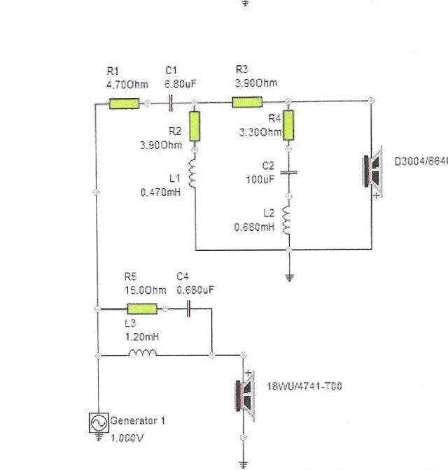

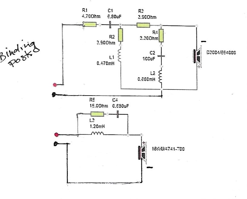

I'm currently building a pair of speakers designed by Troels Gravesen (illuminator 71's). The kit comes with a single wired crossover but since a have a nice pair of biwire cables I want to convert it to allow bi-wiring the speaker.
In all my noob wisdom I thought I knew how to do this but... Before I start blowing things up I thought I might post here to ask someone who definitely knows how to blow things up if I thought right.
First picture is the original crossover. 2nd picture has my modifications.
