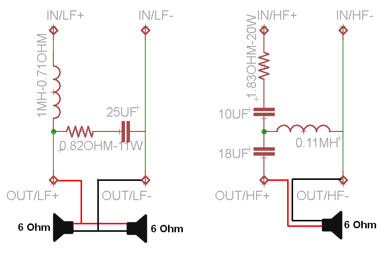

I am currently planning on bi-amplifying a pair of KEF C7's. I will take out the passive crossover and power the cones with some LM3886's amplifiers I have lying around. Before them, there will be an active crossover/preamplifier.
I am not sure on the details of how to accomplish all that, so I came here. As KEF states, those are 8 Ohm speakers crossed over at 2.500Hz. So I took out the filter and drawn it, attached is the schematic of it.
I took out the cones and measured their resistance without any filter. I had to use a plain multimeter to get their impedance as I haven't any LCR meter available. I read around 4.2 Ohm on both the tweeters and the midbass', so I can round it up and suppose all of them are 6 Ohm speakers, right?
I would like to draw the filter with some simulating software to see it response curve and to check (mainly out of curiosity) if that correlates with the 2.500Hz point that the manufacturer provides.
What I don't really know (I am quite noob regarding speakers/crossovers) is why they are labeled as 8 Ohm speakers while they don't have any, isn't it strange?. Even further, they have paralleled two 6 Ohm cones that gives 3 Ohm combined. Does the passive crossover make them appear as 8 Ohm's or something?
Then, the low pass filter seems to be a second order one, I think the high pass one should be of the same 2nd order but, it really is? isn't it a 3rd order one?

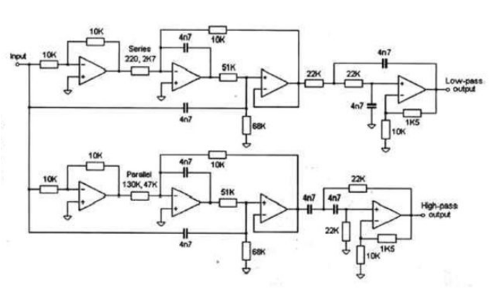

Then the next question should be, what active crossover topology to mount? I have seen those very nice boards to make it, seems to me the way to go. Their filter slope is 12dB/octave (it is a second order filter, right?), as far as I know for biamping a speaker I don't need to match the original slope so in theory I could make it be any order I would like, right? I have attached the schematic provided by the seller.
Line Level Active 2 Way Crossover Filter NE5532 PCB Only DIY Audiophile | eBay
Thanks!

You don't have to duplicate the passive filters' transfer functions but that is probably the best way to get the result to sound decent if you aren't going to measure the response of the drivers. Stock crossover filters may or may not work well.
If you are going to measure the driver responses then you can use any filter you want and see if you do better than Kef with the drivers.

IMHO, Kef, as a company that build drivers with their own needs, probably markets speakers with a correctly designed crossover (look at the pretty unusual values of the components). That said, you probably need to replicate the passive transfer function to the active crossover. Problem is that without measuring the in-box frequency response and impedance of the drivers you're not able to find the transfer functions, as they are likely NOT a second order acoustical (as evidenced by the driver polarity). What most people here fall to understand is that a second order electrical filter merge with the driver/box characteristics and produce often a different acoustical order, and this is what you need to reproduce. Look here for an example: Zaph|Audio - ZA-SR71
Ralf
Add a second order (2 pole) filter of the same frequency as the inherent roll off of the driver and you get a slower roll off but of fourth order (4pole).
If you spread the filter frequency away from the inherent, or natural, roll off of the driver you end up with a pair of cascaded 2 pole roll offs with a "weird shape" and that "weird shape" is probably not what you need.
It is generally accepted that what is required for good integration of two drivers is an acoustical roll off that gets very close to your theoretical "perfect" order roll off.
But to get this you must combine the natural acoustic roll off and the active filter roll off.
Then you have to include some EQ to correct for other response anomalies.
This EQ may interact with that "theoretical" roll off and require you revisit your active filter to counter the EQ correction. This is what they mean by "test and measure" the almost finished assembly.

1) Learn about acoustical measurement, frequency and phase response.
2) Learn about filter response and their phase response, and the difference between electrical and acoustic response.
3) To duplicate the acoustic response of the passive crossover will require a drastically different filter than the one you posted.
4) The requisite understanding of 1, 2 & 3.
5) The passive crossover components and the impedance response of the speaker in the box make for a very complicated LCR network that is critically tuned for a specific acoustic response.
If you think it is not difficult, you are in for a surprise when you start studying the TS parameters of a loudspeaker, which have very little in common with a resistor.
6) Active crossovers do have some potential advantages, but you would need to be at the level of the Kef engineers to implement them.

The guys here are making things too complicated. The crossover inside the KEF is most likely a parallel topology filter - separate for mid and tweeter. Then just use it and connect LMamps' outs to appropriate filter ins. Both amps should get full signal.
A more smart way is to use a minidsp 2x4 for each speaker to act as line level crossover before the amps. But then you must get a microphone, measuring software and skill to use them. It is not easy and it takes at least a year to get the skill level to match KEF engineers. If you try to create an active crossover circuit by reverse engineering or own design, that does the same as minidsp, I guess it would take you some years to make it work well.
