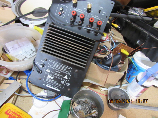

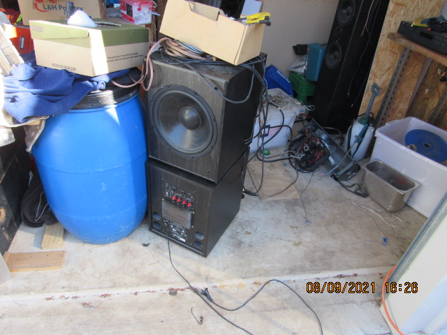

All the cheap amplifiers in my H/T speakers are on the way out, several have died already and these cheap amps seem to not worth repairing even if the faults are minor.
I'm considering biting the bullet and converting them all from ported active to simple sealed passive.
I have no data for the drivers and still no test gear apart from the multimetre but the 12" are reasonably sized magnets with about 8mm of travel P2P and the tens are a very common generic with bigger magnets and lots of travel
Pix later.
Had these for a dozen years or more so I've got my monies worth from them but I see no need to trash if I can make them work passive.
Any tips; hints; pitfalls; advice for me before I start?

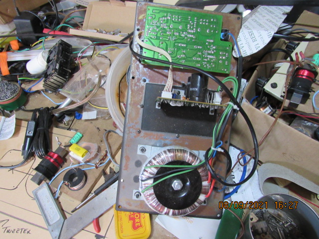

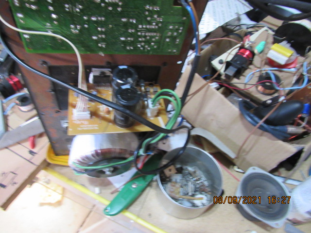

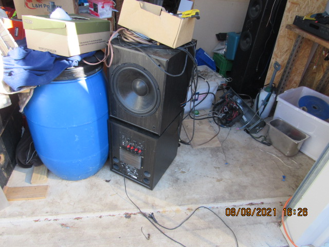

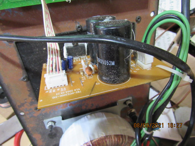

Here are the pix of the dead subs and the chip amp that powered them
I'll take pix of the drivers tomorrow and measure DCR but I think they are 5.6 Ohms each

Ported subs are easy to convert, simply replace the amp module with a piece of wood or aluminum with the driver wired directly to a speaker connector and drive it with an external amp, little no now EQ is necessary to get good results.. maybe a highpass to prevent unloading the driver below tuning. Sealed boxes are the same except that some EQ is necessary for flat response, but that also depends on positioning... if the sub is placed in a corner it may not need much.
It depends how the box is constructed, sometimes the amp module is sealed off from the sub enclosure other times it's not. A little more box volume will tend to lower reflex tuning slightly which isn't the worst thing to happen, but there are things you can do to consume some volume if it is an issue like glue a foam block onto the rear cover. Remember that the driver in a reflex enclosure may not be as suitable to a sealed alignment, it may be excursion limited to a lower output level. In any event don't overthink things, the simplest solution is often the best but don't be afraid to experiment either.
