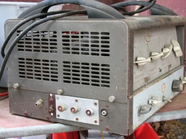

Is this possible? Ive always wanted a tube amp for my bass and I can pickup this Stromberg Carlson AU-35 for $25
I'm looking to get a really deep growling bass amp, if that helps with designing this.

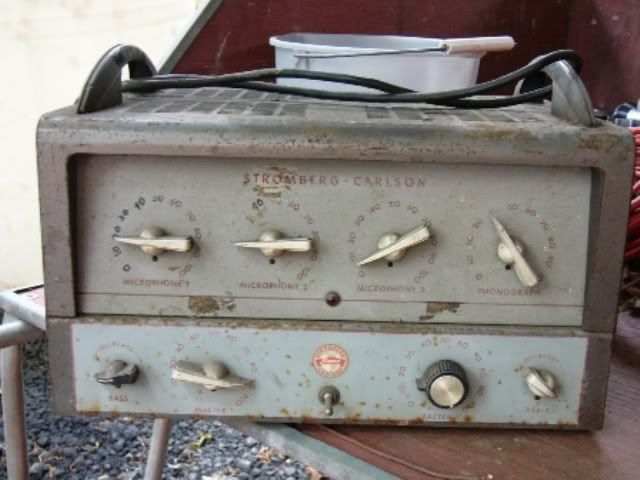

Here are some pics:
I would rate my skill level with electronics about a 7 on a scale from 1 to 10 and I'll also have help with this (my dad is an Electronics Engineer).

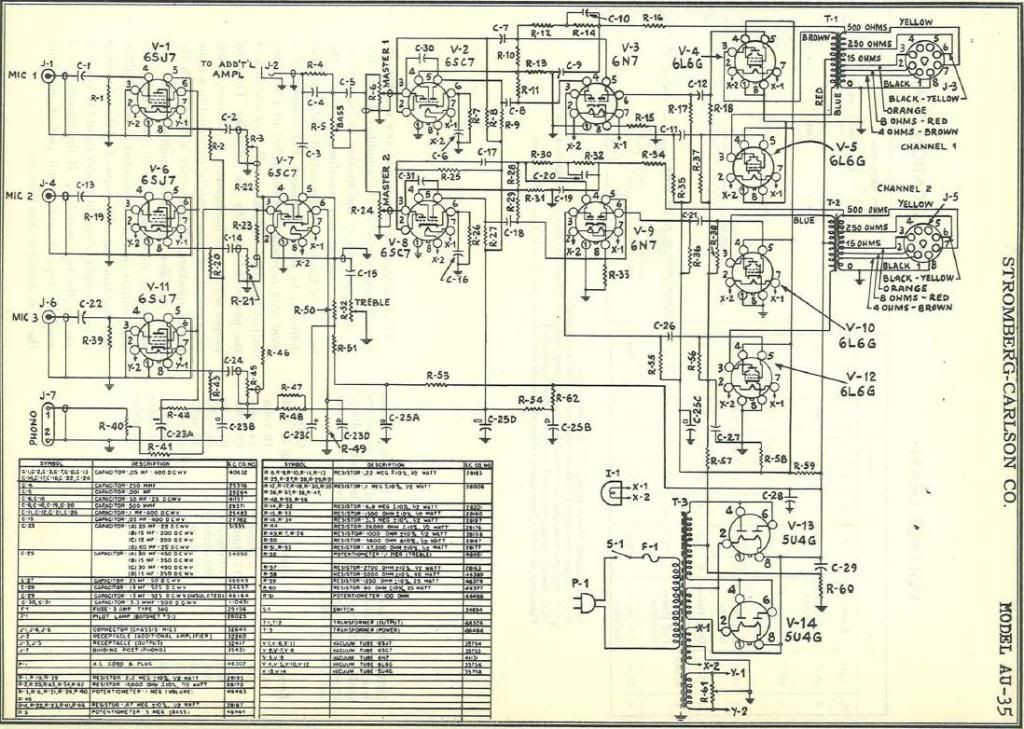

Here is a schematic that I have found for this:
I'm looking to get 45-50 watts in PP or 90-100 watts in dual PP. I have no problem buying different transformers, caps, resistors, etc.
The tubes used are (3)6SJ7, (3) 6SC7, (2) 6N7, (4) 6l6G, and (2) 5U4G

25 and 50 watts are more like it - should be plenty with efficient speakers. A little more power would be available by dropping 5AR4s or a solid-state sub into the rectifier sockets, and 6L6GCs into the outputs. But maybe not enough increase to HEAR...
I measured a similar Stromberg output transformer and it went down to 55 hz at 25 W - these look to be a little bit bigger. Bigger than a Bassman transformer, I would say...

50 watts would be alright for gigging I guess. This amp will drive a 100 watt 4 ohm 15" Jensen MOD
I wouldn't mind buying a new/used Marshall or Fender OT to gain more wattage if possible.

Personally I'd start a bass amp project by clearing out just about everything except magnetics and tube sockets! I'd aim for SS power rectification. The power transformer and output transformer are really the limits on maximum power output. SS rectification will help, freeing at least some current in the PT and removing some impedance from the B+. I'd check out something like schematic heaven or elsewhere and examine a bass amp with similar tubes for the preamp. You want high B+, proper DC bias (low distortion, more headroom) in the preamp. Expect to pay out the nose for coupling caps around 1uF 630v for good bass response, unless you DC couple or use feedback loops in the preamp. The power stage you should do the loadlines on to figure out where to bias it etc. If you need wires, grab an old computer PSU, plenty of colors, enough to follow the old RETMA style, looks nice and easier to fix later.
Ultimately, most of these PAs were designed to do a lot of stuff a bass amp doesn't, like amplify bass frequencies 🙂. It'd probably work as is, but you can do better with a redesign. Simple is better, keep B+ high and make sure to use a frequency response starting at the lowest note the bass can produce. You will want gNFB around the output stage or cathode feedback to get more lows through the OPT.

hey-Hey!!!,
Your '35 looks very similar to my AU36( my very first tube amp). Mine had its OPT replaced with a Stancor 8053 and its performance was very good. I made some connector mods and turned it over to a guitar player loaded with 6AR6's instead of the 6L6's it came with. Its power TX stood the extra 1.2A of 6.3V load w/o issues. Last I heard from him it was going strong and played often.

There are quite a few tubes in there, including four power tubes. It looks like the PT would be up to the task! The OPTs may or may not be sufficient. You may want to try cathode feedback like Leslie did or many on this site have explored, since that'll give you more bass response and better damping. The gNFB loop may be able to be tuned for bass depending on the transformer, gNFB is as close to voodoo as it gets without a scope though!
If you're feeling extra experimental, you can either parallel the OPTs (since they're similar) and use 4x power tubes or you can use the 70v taps on the first transformer to drive the grids of the second pair of tubes in class B. Paralleling seems to have a good effect on frequency response in my limited experience with it (dissimilar 6V6 transformers driven by 6AV5s). Good luck, that chassis is at least a great starting point, you can always replace the big stuff later.
