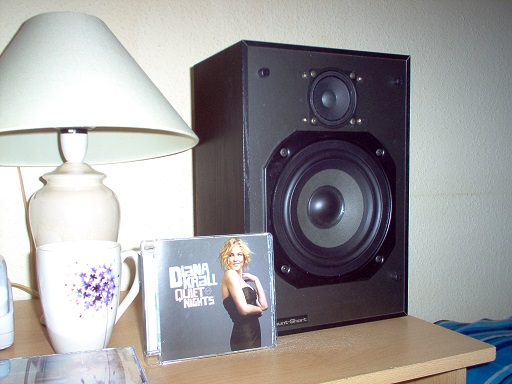

It's some sort of Elac 6" bass from the eighties fitted in the Mordaunt Short MS15. Rubber dustcap being an Elac characteristic. I use a Visaton TW70 with it since it fits.re: "little 10L speaker I usually feel like kicking round the room" - Steve, what drivers are they?
Originally the bass just had a 0.4mH coil, and second order 3.3uF/0.3mH Audax mylar tweeter with a 3.3R resistor. Sounded harsh and lots of cone breakup around 5kHz I guess.
I believe I have 2.5mH and 6.8uF bass with a tank notch of 33R and 0.33 uF around 6kHz, not too sure, and a third order 3kHz tweeter now. Cone tweeters need steeper filters IME. Cabinet is too small fundamentally.

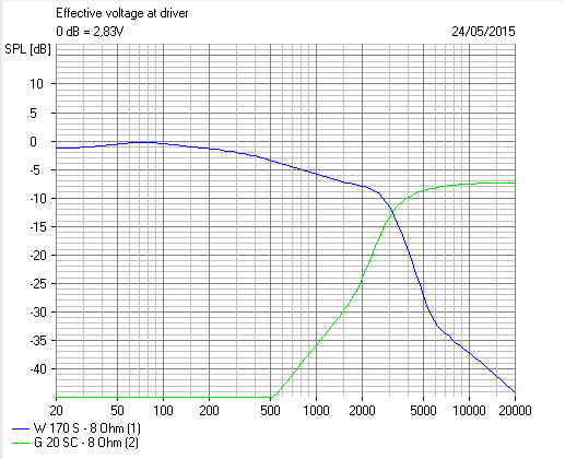

Steve, you are throwing stuff at me faster than I can digest! LOL😉
I will finish my current Peerless-Dayton_Audio bookshelf with the commercial tricks #1 and #3 that Gravesen quoted.
#1. Use an asymmetrical crossover usually consisting of 2nd order to the bass and 3rd order to the tweeter to make "proper" phase integration.
#3. Tilt the front panel so that with a listening height somewhere between the bass and tweeter we more or less compensate for the time difference.
I will re-examine the crossover by investigating the benefit of notch filters at both the woofer and the tweeter side.
I am giving up the acoustic Butterworth for the Peerless-Audax bookshelf. I could not figure out how to get the Martin Colloms' transformation equations to work right.
The time aligned LR2 will be for a future project.
I found this LRC calculator and like it.
CalcTool: RLC or LC circuit calculator

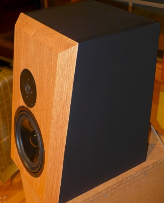

Sloped baffles seem to work well enough. Below is one that somebody built for a series crossover I rustled up with Visaton drivers that play nicely together. The tweeter is set back about 2 cm.

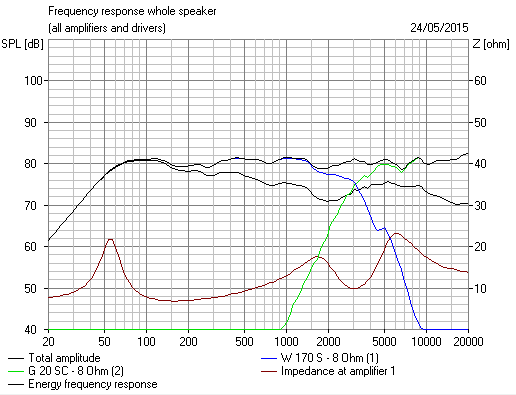

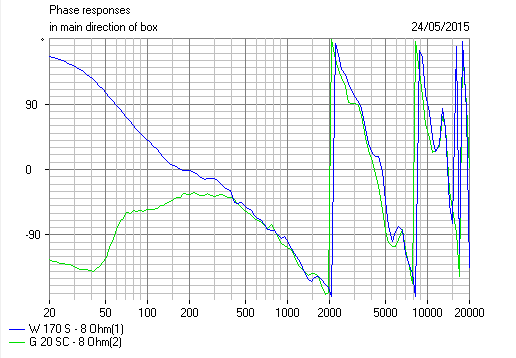

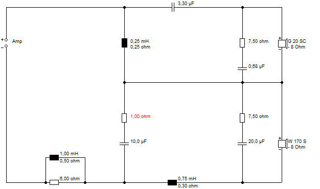

The series filter is quite neat, and includes a hidden tweeter Fs of 1.8kHz correction along with a notch on the bass around 6kHz. Apparently it sounded good. The 1 ohm resistor is optional, and just takes down a little 2dB peak at crossover to get nearer a pure 24dB/octave LR4. Each driver gets a Zobel that matches its inductance and DCR.
Impedance Equalization (L-Pad) Circuit Designer / Calculator

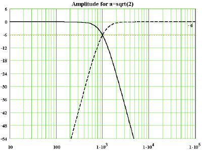

For me, this was more a theoretical exercise than anything. I had become interested in the 3:1 ratio of components in classic filters. That phase alignment is quite impressive IMO. Should sound very integrated. But as I said, this sort of design is not my primary interest. 🙂
It would be much harder to do this with notches on a parallel circuit.
