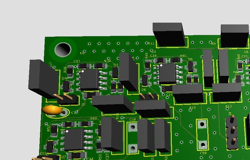

Ergo, yes that's it. The reason for conversion is that in the 214, the object color is embedded. In the 203 version, the object color can be set externally, which is what I want to do with my CAD 3d viewer.
See example, I hate all that black ;-)

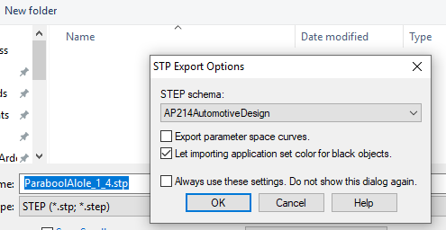

I'll see if I can attach a file that is in 214 to convert to 203. No, invalid file. I'll send it by mail.
