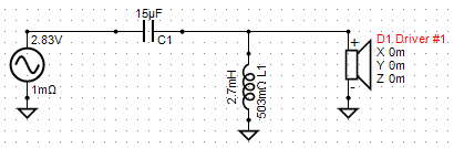

If a passive network has a second order topology, it is very likely that the net acoustical response is 3rd order or 4th order.
A second order topology has two reactive elements (inductors and caps). Shown below is a high pass
Are you looking to install an active filter and duplicate the response of the current passive filter?

To duplicate the response of the existing system, you will need a way to measure either:
(1) the electrical response that is presented to woofer and tweeter. You would drive the system with a sine sweep or a pink noise signal, and measure the frequency response at the driver terminals.
or
(2) the acoustic radiated response of the woofer and tweeter. You would use a measurement microphone and a software like REW to make frequency response measurements of the drivers as they are now.
