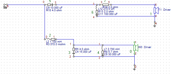

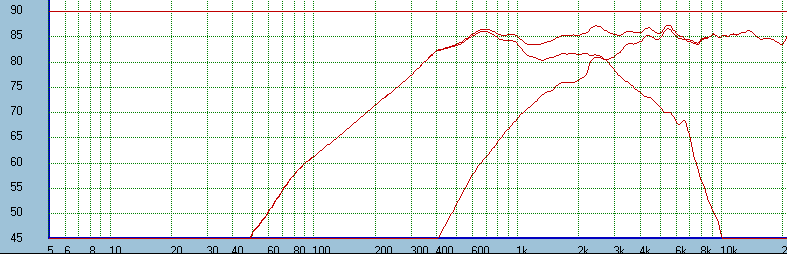

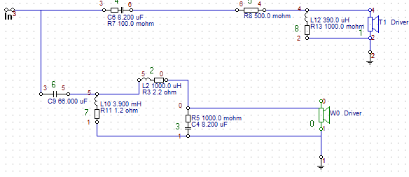

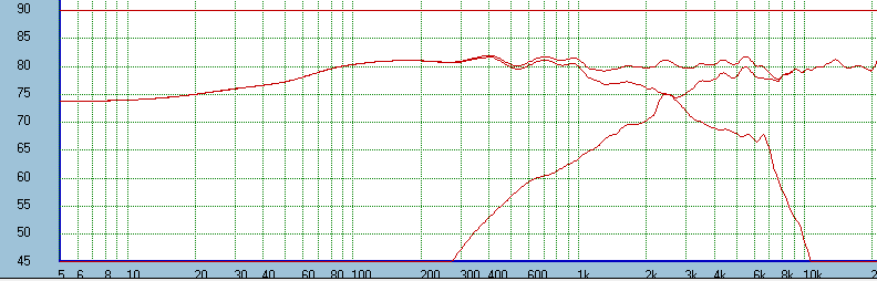

I took a look at Troel's Ellam 3W since I'm using the 15W and created a new 2 way crossover based on the mid/tweeter crossover of that design. With a little optimization I was able to get decent looking results at a 400Hz crossover:( I could not get satisfactory response and phase anywhere below 400Hz..... I guess on the up side, I gain back a bit of sensitivity... Decisions decisions.... I could just love them for what they are and stop wishing they are something they are not:) They sound so good that it makes me want to see if I can.
Attached response and xo designs mentioned above.

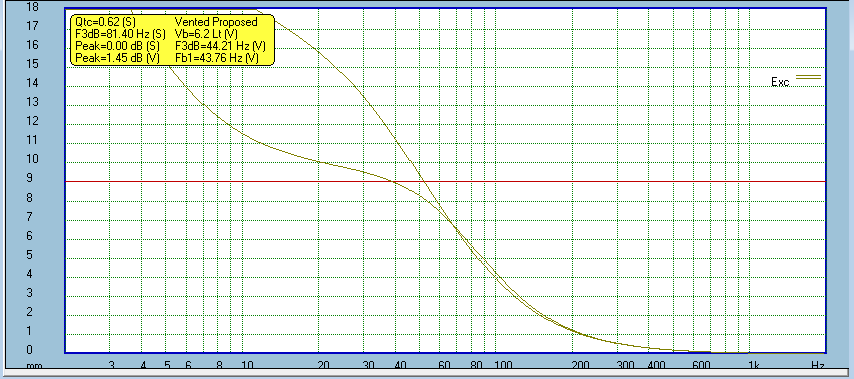

At this point, some people will cringe but you could fill the cabinet volume if you're trying to reduce the bass response. Just calculate for your 0.707 QTC or whatever bass tuning your looking for. I've put old diving weights in my cabinet volume to test out tunings before. Might be cheaper and simpler than a DSP.

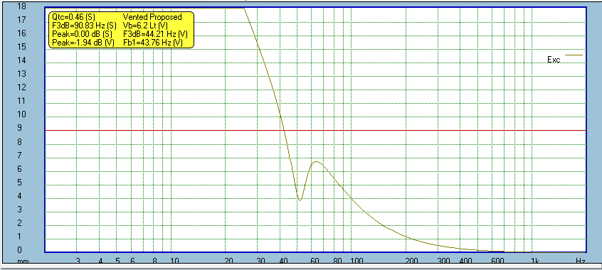

Thanks for mentioning this. The box is ported and tuned to ~52Hz. I guess I can adjust the box volume and seal it. I ran a sim on this using the drivers measured T/S parameters and came up with the attached results. The ported graph is as it is configured right now. The sealed graph has two traces, the lower excursion is at 4 liters sealed vs 11.5 liters sealed. That makes quite a difference! Frequency response looks fine on both with a 3dB in the 70's.
