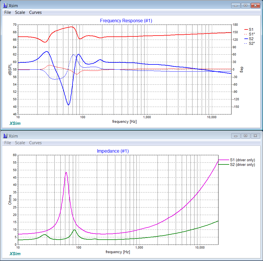

Could you please explain the results of the unfair signal sharing due to non-linear impedance peaks?If you put them in series the impedances won't share the signal fairly because the peaks won't line up.
I've used flat simulated responses so you can see only the variations, and added two random woofer impedances. (Never mind that one is 4 ohms and one is 8 ohms, all I'm showing here is the ups and downs.)
Not only are the responses different, the phases vary and this adds to the already different phases.
