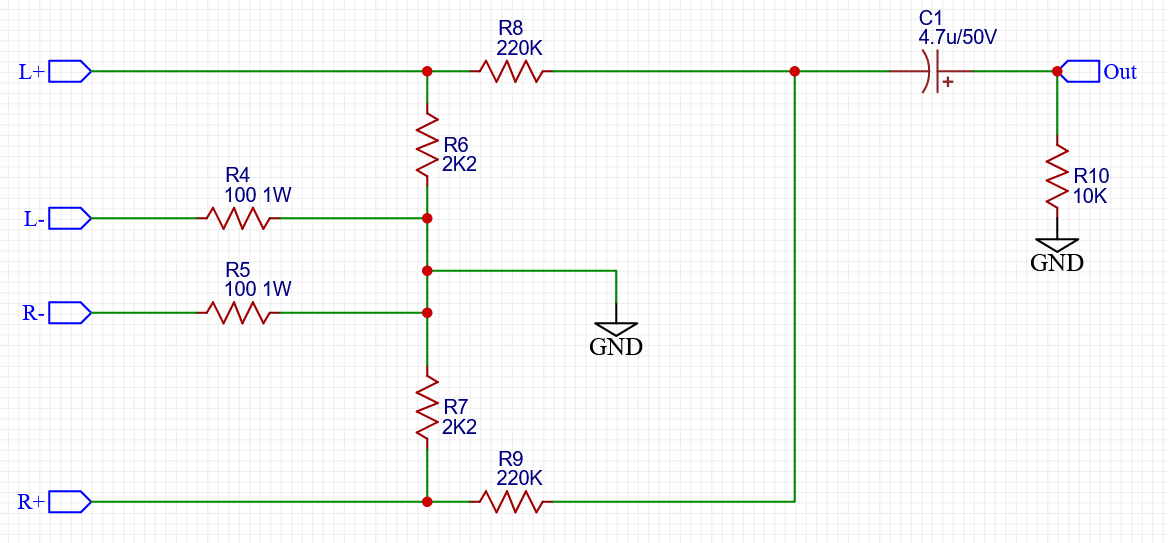

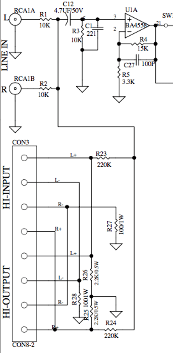

However I was able to find examples of subs (Polk PSW10 and PSW202) that don't even use an op amp before combining the signal with line input (attached). So I "isolated" what seemed the inportant parts of the circuit an pared it down to the second attached image. I threw it all together, using 4 27 ohm 1/4W resistors in series instead of the 100 ohm 1W as I did not have those available. And it seems to work. I say seems because I have no way to measure distorsion or any possible negative effects to the sound quality. All I can tell is that the sub produces sound, there is no hum and the amp has not blown up nor is complayining.
I wanted to post it here to get a second opnion on why this might or might not be a good idea, or if I missed something inportant from the original circuit. What is the function of the 100 and 2K2 resistors? Why would they possibly use 220K and 10k for the summing/voltage devider? What is the C1 221 (which I omitted) in the original schematic for?

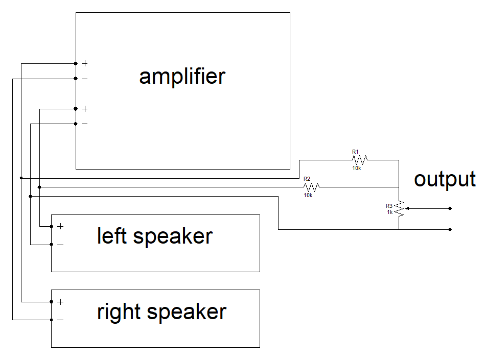

If your amplifier use the same ground for both speaker you may use this circuit.
It will mix to mono, will have attenuation to line level BUT it has no filter to isolate bass.
The filter must be in the subwoofer unit.

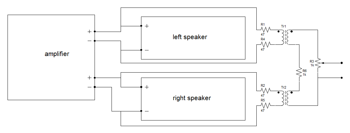

If you must have isolation you will need transformers and audio transformers are expansive.
But power transformers are less expansive, for full frequency and low distortion I would not use them.
But in your application it could work, here is an example:

Here is a circuit that should work
Put all 4 47 ohms resistors close to the amplifier, they are used as short circuit protection.
You will have to respect DOT convention on the transfomers.

Why is there a 1K resistor between Tr1 and Tr2?
Also as I was researching this, one reason stated for why the audio isolation transformers were so expensive was that they had to have relatively high winding counts, requiring very thin gauge wire, and some not standard core materials. My understanding was that otherwise there would be distortion at low frequencies. Does this problem diminish with bigger transformers as you recommend?
Thirdly, is there any problem with the circuit in my second attachment?

The 1 K resistor is to '' calibrate attenuation '' so if output levet is too low you may remove it.
transformer have a ratio 13:1 and with both resistor attenuation is around 26:1 if potentiometer is set for maximum output.
The transformer is made to work at 120 volts at 60Hz so th core is selected for these parameters.
But saturation voltage is proportional to frequency so 120V 60Hz will use same magnetic level as 60V 30Hz or 40V 20 Hz or 30V 15 Hz. and so on.
I dont expect saturation problem in your application.
