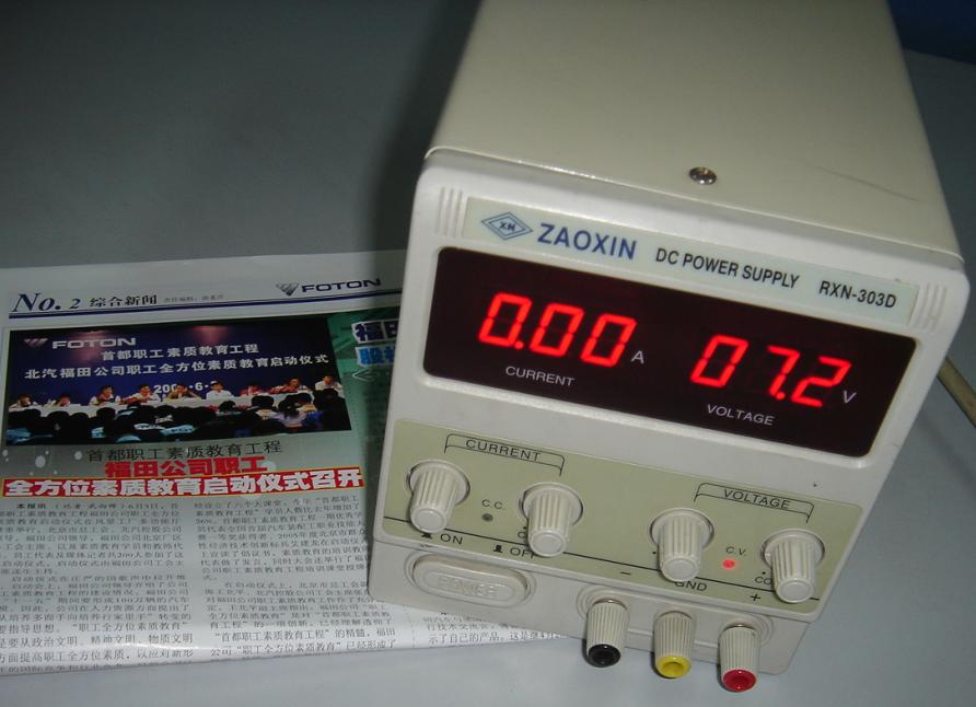

I bought one of these on eBay
but then discovered it was single rail supply not dual. the connection for GND is just that - chassis ground with no potential between the +/- and the GND terminal.
Is there anyway I can get some sort of dual supply even temporaly for low voltage testing before applying full power to a new project?
Otherwise it's a good little power supply

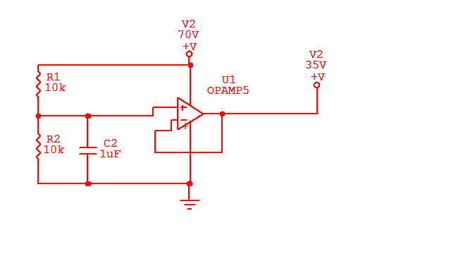

I have a feeling that audio power amp IC can be used as a power amp for making virtual ground. Select a 5 pin IC like TDA2030 or something alike depending on ground current required.
Not a good solution than a second PSU, but in case...

Still, your load must draw much less current than those resistors, or draw approximately equal current on both rails. It can work, but only under certain conditions.
