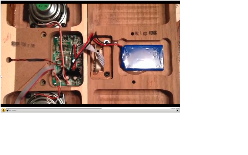

I have the below radio that currently has to get recharged for 3 hours before it can play music for 8. It doesn't play while plugged in, I was hoping you geniuses can guide me on how it would be possible to adapt some new wiring to allow me to remove the battery and solely apply a 5V USB Wall adapter or 5VAC straight to the radio. Again below is the link. I was told that the below item from Ebay via cutting the wires and rewiring will help. Not sure if I rewire to the current battery cables once I unplugged them from the radio. Right now the radio recharges via a USB cable. The radio is rated 5V

Mooley, I'm a total Noob, but regarding the polarity, wouldnt the red be positive and the black be negative. If I cut up an USB doesnt it have 4 wires, Red, black and the other two colored ones are for data. If I just use red and black and match it up I should be good right?

Red should be positive but I would never ever assume. Measure it on a voltmeter and be sure. For the USB, the outer pins are the 5 volt supply, again I would measure the voltage first and confirm which is positive and which is negative before connecting it up.

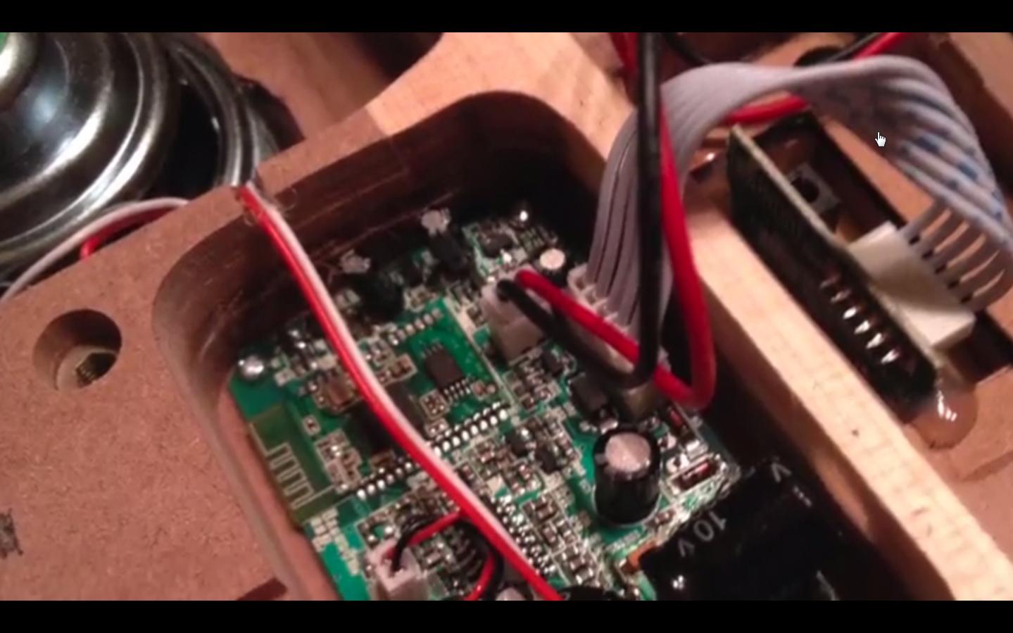

Here I have another thought as well. There's a module connected right now that feeds to the current amp that utilizes an Aux In and the USB side to recharge the battery. I was thinking is it possible to isolate the 6 wires from the board which is connected via a pin and identify what does what? I want to keep the Aux In wires to do what they do, but I was thinking of removing the power ones and redirecting this to the current red/black ones that are attached to the battery. Is this possible? See pic below. to the upper left is the Aux/USB module.

I can draw it for you if you want to do it. If you cut the red wire from the battery and connect the diode in series with that red wire then if red is positive the diode will be positioned with its "striped" end toward the radio and the radio will still work.
If you then connect the USB supply in place of the battery (still keeping the diode in the lead), then if you have the polarity correct the radio will work. If you have it wrong, the diode will block the current flow and stop any damage.
You still need to be sure the battery is a 4.8 volt type though (4 cells), or whether it is some other voltage such as a 3.6 volt lithium ion battery.

Identifying all the leads on that plug is one of those things where you need to be sat in front of it really.
Its a bit difficult to just visualise what you mean tbh. If the radio is fully functional on battery then I would think its just a case of making sure the USB input supply takes the place of the battery, possibly also disconnecting the supply from its normal route onto the PCB. If that makes sense...

Ok, will do. Lots of traction so far thanks to you. Diodes ordered-check, voltmeter ordered-check. I'll separate each of the 6 wires from the USB/Aux In Module and try to identify which one does what.
