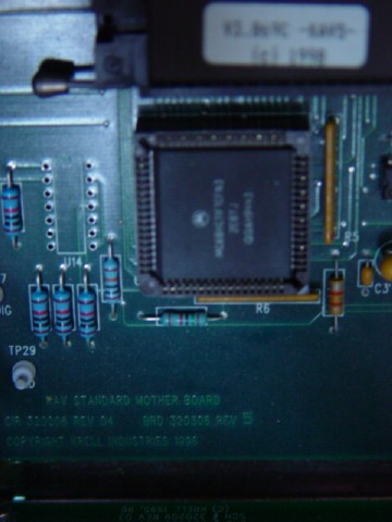

i gathered that you have done an oscilloscope for a few of your friends. can you tell me are the tracks in the same general location? ie is it near the microcontroller or near the transformer?
is there a specific number for the track? thanks
i have attached some pics of my eeprom

Am a bit confused; you're interested in checking if a different device uses the same method of frequency check to limit operation at 50Hz? Can you shared with us what device it is?
What you will need to do is to check with an oscilloscope if any of the pins on the mcu carries something resembling a 50 or 100 Hz signal. If you look at my original discovery post at page 13, you'll see that for the 300iL, it's pin 31.

to iampivot
actually my query was directed at philbyx. coz he mentioned that he has done the voltage mod for a few different units of krell by constructing the nand gates.
so i like to check with him if the track which he did the mod on(ie which detect the 60hz signal) is indentical across the different units.
you mean you did the mod too? and its done on pin 31 leading to the motorola microcontroller? not on the eeprom?
if u see my 1st pic, the eeprom containing the sofware version is above the microcontroller
