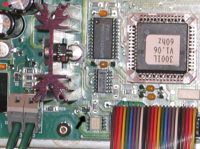

The check is done in software on the microcontroller, if done at all. Check if there is a white label on a chip on the board mounted inside the front panel. It probably states the model number, software release number and possibly frequency.

Can you supply C and R values for 60Hz please? 🙂
And do you know which pin the 68HC711 senses frequency on?

The values for C is 100 nF and around 100 Kohms for R (you have to adjust : this kind of oscillator is not very precise).
I don't know the pin, I just found the right track on the PCB where the opto give the 50 Hz in TTL level, I cut the track, and put the oscillator output (tuned with an oscillo at 60 Hz) on the track which go to the micro-processor.

The point of frequency measurement seems to be after a small diode bridge, just before the opto coupler (white yellow), marked as q206 03hs (I think, it was kind of fuzzy). I measure 100Hz again earth at this point.
Btw, can someone check if this layout is similar to other krell products' front panel board?

well guess what guys....i wont be needing the unit from fmak - mine "works nicely" as the dealer told me........it just needed the 60 hz.
so i guess krell did put the frequency detector inside this dated cdplayer......
