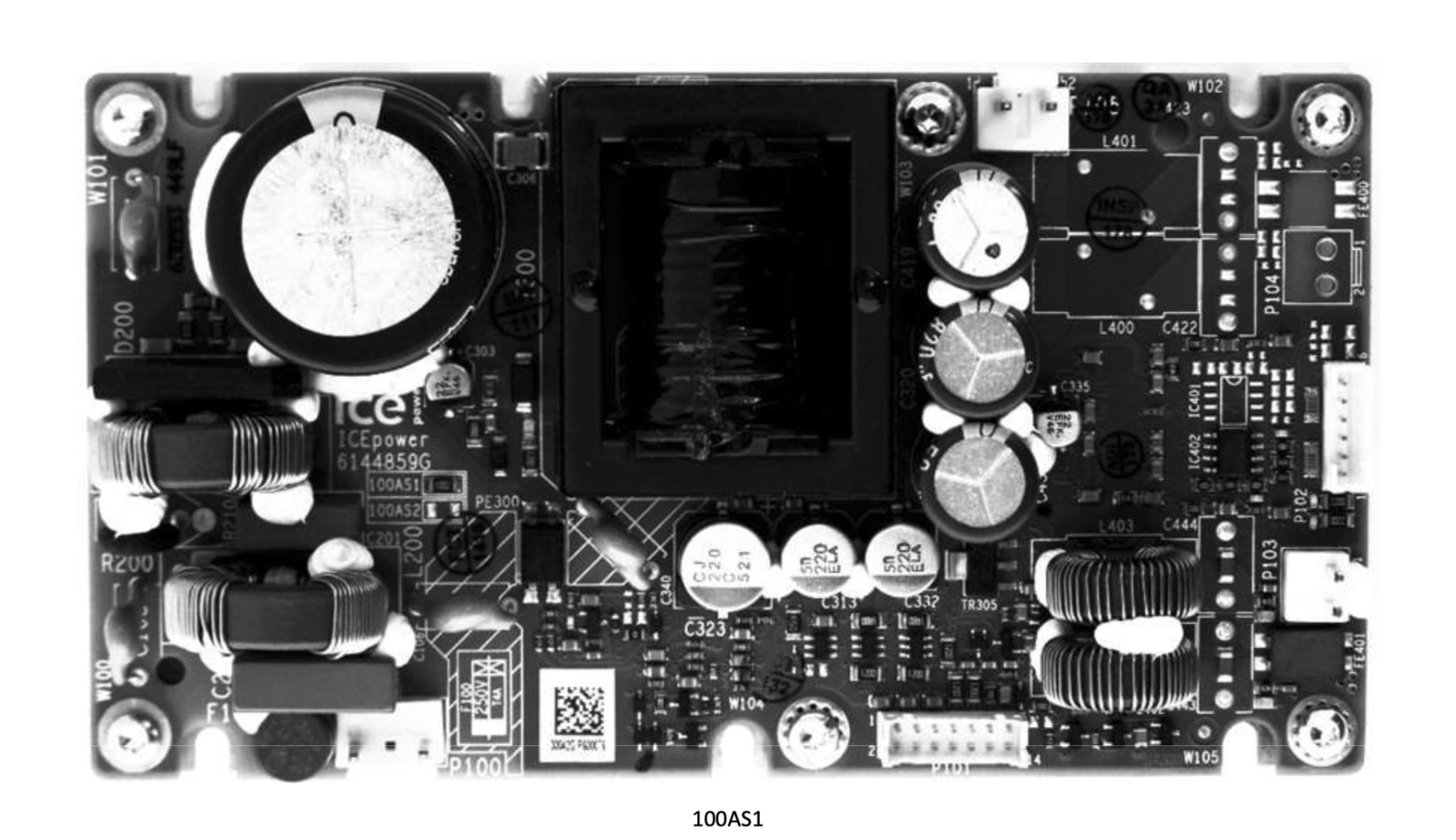

Taken from the ICE 100AS1-2 datasheet, pins 2&3 pins 5&6 balanced inputs. . Full datasheet attached.
6.4 P102: Audio Input Connector
Type: JST, B6B-PH-K-S (LF)(SN)
PIN Function Description Type
1 GNDA Signal shield, channel 1 Analog ground
2 In1+ Non-inverting input signal, channel 1 Analog audio input
3 In1- Inverting input signal, channel 1 Analog audio input
4 GNDA Signal shield, channel 2 Analog ground
5 In2+ Non-inverting input signal, channel 2 Analog audio input
6 In2- Inverting input signal, channel 2 Analog audio input

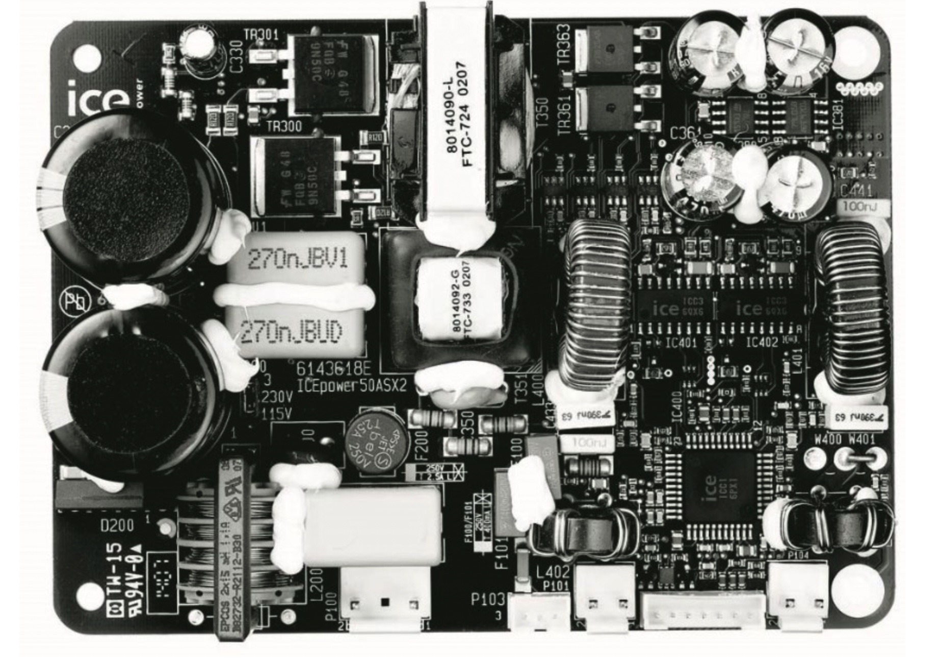

This Ice module would seem equivalent to an Ice 50ASX2 module in Btl. 👍Taken from the ICE 100AS1-2 datasheet
I didn't want to have to do this.....but not all ICEpower modules are the same! Like every company, they make a bunch of different products. They have 2 different series of modules, The AS and the ASX. One series does indeed have balanced inputs, and the other does not.I did see the above posts which is why I made the comment.
Yup, they are equivalent if you overlook the differences in the specifications and the design.

If people are questioning why I don't just pick an amp module that has built in balanced inputs, the reason is the noise specification of the different amp modules.
The ICEpower AS modules with balanced inputs are rated at ~80µV residual noise output. But the ASX (unbalanced) modules are rated with much lower noise output. The 50ASX2SE is 25µV. The 50ASX2BTL version is 20µV. The 125ASX2 is 36µV. The 250ASX2 is 20µV.
The rating of 80µV is respectable, but it is also the same as my current ampifier! And it would be a shame to build a new amp that performs exactly the same as the old amp.
