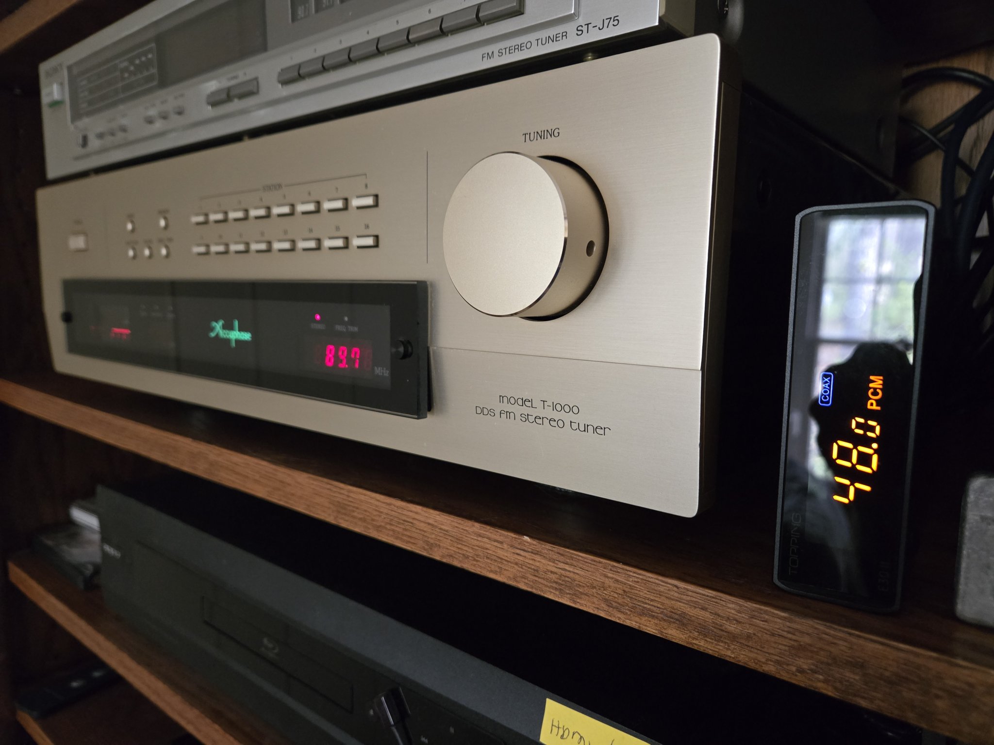

Post #40 gives the impression that you did not manage to convert the tuner to the American model but just built the filter I suggested to correct the de-emphasis. Posts #41 and #42 suggest that you did manage to convert it.
But, I did not convert anything inside except the power supply, from 100vac to 120vac. Just the filter, which is inside the end of each RCA plug.
I should mark the cables in case someone uses them in the future and hears something not-quite-right...
Oh so you just fixed deemphasis and use it to play that one station at the end of the Japanese band .

What you actually need is an RF frequency shifter. That would require an RF preamplifier to provide isolation and then a local oscillator with a mixer.
For decent results a two stage version would be best. Shift the entire band up well above what is needed and the down again to the target values.
However as you really are looking at a limited number of stations the design could be much simpler.
The phase noise of the extra local oscillator or local oscillators would worsen the ultimate signal-to-noise ratio, so it would increase the noise floor and thereby affect the sound quality under ideal reception conditions. Under less ideal conditions, suppression of undesired stations could get worse due to phase noise of the extra local oscillator or local oscillators (by reciprocal mixing) or due to intermodulation in the extra mixer or mixers.
