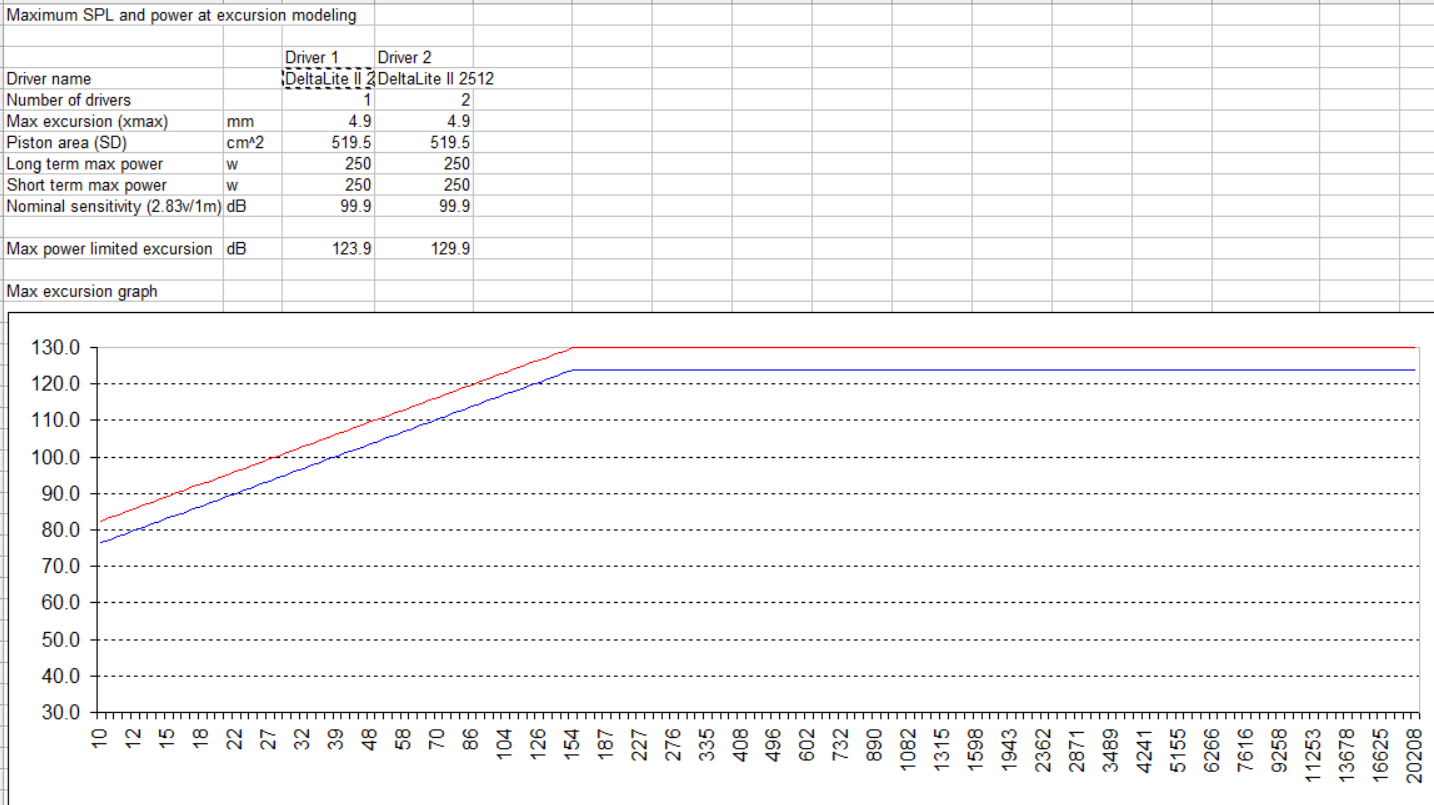

Unless my math is wrong.... peak SPL is a function of swept volume and limited by excursion at lower frequencies or heat dissipation capability of the voice coil at higher frequencies.
As such - doubling up any driver - doubles swept volume = a 6dB peak SPL increase
Here's the peak for a single (blue) and 2 (red) drivers into 4pi space (no enclosure loading / rolloff factored here):
The drivers become excursion limited at peak power below 123Hz and thermally limited above for max SPL
I am assuming the stated sensitivity is at 2.83v drive level (i.e. 1 watt for an 8 ohm nominal driver)
