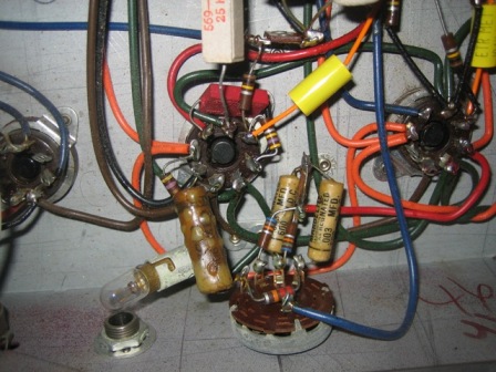

I recently bought an old tube PA amp. It has been converted with 1/4" input jacks and 1/4" output jacks. It is about 30 watts and uses a pair of 6L6G's.
My goal is to use it for bass. I know this is a little unusual I'm going to run it as one half of a bi-amp rig.
I will run my lows through an Ampeg B-15 and run my highs through this old tube PA head and a 2x12 cab I've got.
I had some questions about the controls. There is a single tone not that switches to four different settings. I was wondering if I could make some mods and change the sound of those settings.
I've included some pics. The tone control is there on the left/center side of the pic.
My main goal, I guess, is to cut out some bass without it getting crazy bright. I know that tone preferences are pretty subjective but with an amp this old and a switch like that I don't know where to start.
Anybody want to take a look and offer explanations/suggestions.

Hi Ya "bluehevy75" & welcome to the forums..
See if you can find a brand and or a model number somewhere on the chassis. With this info we all here can move forward and dig up a schematic.
From this schematic we can modify the circuitry all different ways.
Something I did see was someone has been inside & replaced some caps, also there appears to be a roasted cap in there (The blistered component).
____________________________________________Rick.......

The brand is Challenger Amplifier Co. After doing some searching online it looks either to be a very early Bogen or a Bogen "spin-off" as the amp has many similar parts to a Bogen.
The model is CH30.
Random discussion boards think the amp is from the late 40's or early 50's. But there isn't a lot of info about it and no schematic taped to the bottom.
I had a fellow teacher (engineering) where I work look at it and he thought that it was just wax on that one cap but I'm definitely open to replacing it.
I know the guy before me put in 1/4" jacks (input and output) and beefed up the output transformer and grounded the plug. I don't know what else he did. I sent him an email asking but he hasn't replied yet.
Thanks for the help so far. I'm definitely down to tinker and learn. Reading schematics and making them is completely new to me so thanks for being patient. I looked for one online and couldn't find one yet.
Anyway the switch has four settings I'll describe the resistors the best I can. The capacitors I'll have to do when I get home from work.
1st Pin=1st Postion=Deep Bass
2nd Pin=2nd Position=Mellow
3rd Pin=3rd Position=Crisp (So far I like this setting best)
4th Pin=4th Position=Brilliant
1. There is a 22K resistor connecting the 1st and 4th position. That is, going from the "deep bass" to "brilliant" settings. It is curious to me that they are linked this way as the "brilliant" setting actually has a boat load of bass. Which is counter-intuitive to me as I assumed "brilliant" settings would have less bass than "crisp" seetings but that is not the case with this amp--or at least the way it is configured.
2. The first postion seems to have what is a .003 capaciter that goes to a ground.
3. The second position has a 65k resistor running to a gound.
4. The second position also has a capaciter that runs to a ground but I need to check it out when I get home.
5. The third position has a 68k resister running to a ground.
6. The fourth position has that big gnarly cap running to a tube.
I'd love any ideas but will try to do something more helpful when I get home tonight.
thanks,
Kevin
