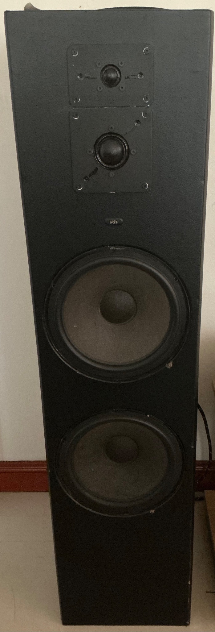

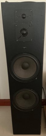

My music preference is about Disco, Dance, Electronic, etc. I own ADS L1590 speakers. They are floor-standing with dual 10” woofers configuration in sealed enclosures. I listen to them and I have ideas towards them. Firstly, they have excellent midrange and high. Secondly, they have very natural tone. Finally, unfortunately, they lack bass when compared to bass-reflex speakers or even modern sealed enclosure speakers. Regarding my listening preference stated earlier, I found their competitor from the same era; JBL L222 Disco, are passive radiator system and I believe their name clearly states what genre of music they were made for.
I just wonder if I could modify my L1590 speakers. Is it interesting and acceptable if I’m going to convert them to PR system? But, sure, I’m not going to destroy the original cabinets but build a new pair with same details and two new 10” holes at both sides and bottom of the cabinets to install the passive radiators there.
Next question is about the PR used. Assume I could find some L1590’s woofers, can I simply remove the magnets and voice coils from the units and use them as the passive radiator drive units? Because the remaining parts; cone, surround, suspension, and frame, should be identical to those woofers being used in the speakers. Is it that easy? Or does it require to redesign the cabinet dimension for PR system?

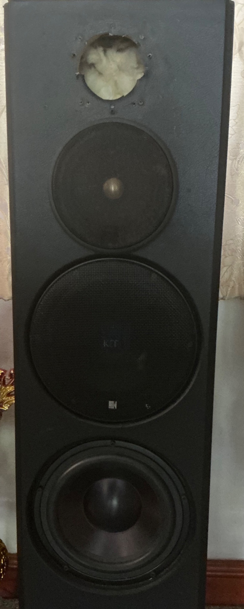

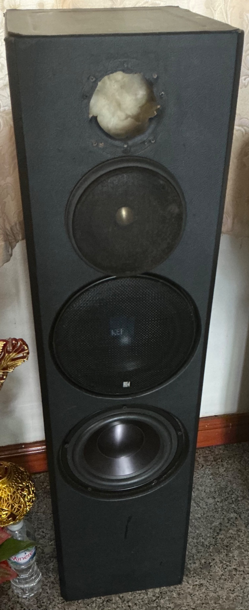

This is the first project: Floor-standing 8” woofers passive radiator 3-way system. Unfortunately, my car audio system needs its Canton pullman tweeters back. So I have to return them leaving the holes on these speakers.

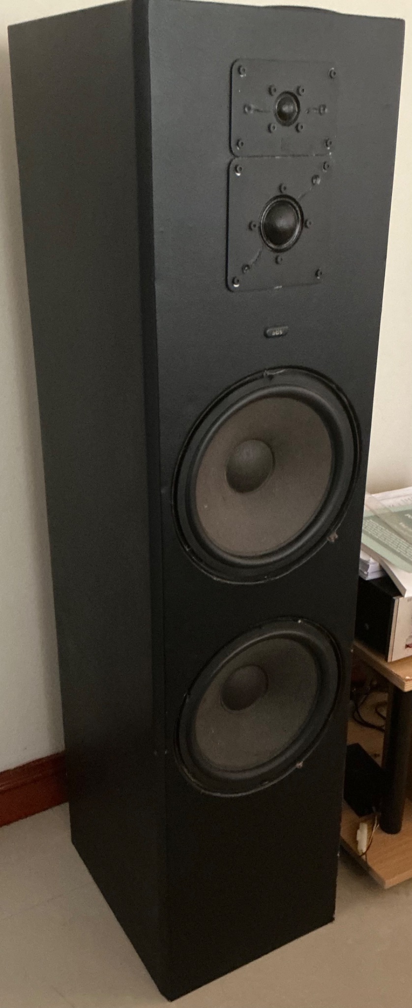

The second project is 3-way dome midranges and dual 10” woofers in sealed system. They’re complete and used daily in my bedroom.
