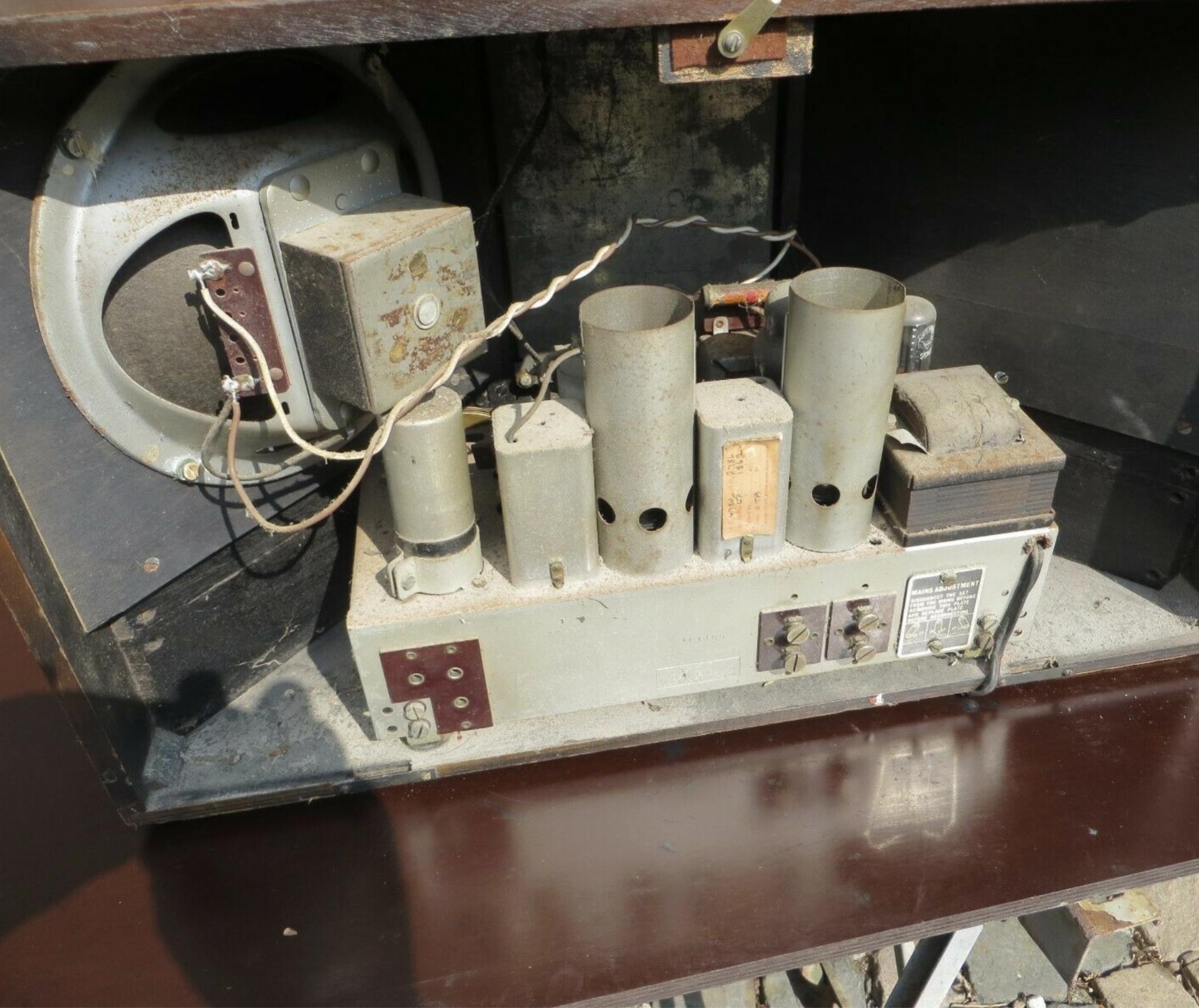

I'm converting a GEC radio into bluetooth speaker using the cabinet.
Will be stereo. max 50w/channel @ 4ohms
There are two panels where each speaker or combination (woofer/tweeter) will fit. Size of these panels are 9" high x 10" deep
I want the best sound possible; not interested in bass heavy bull full range.
There was an 8" speaker in there as shown on photos. Cabinet is all wood and I will be making it more rigid.
Any thoughts or recommendations about single speakers or pairs with crossovers and suggestions for make. ? thanks Tom

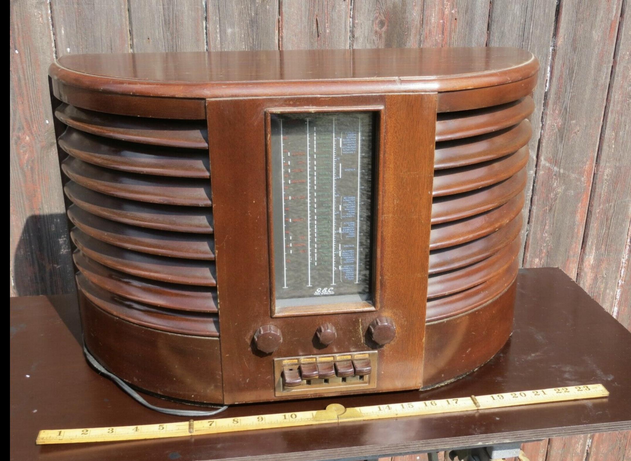

A frontal photo of the radio cabinet would be nice and would give a better impression of its size.

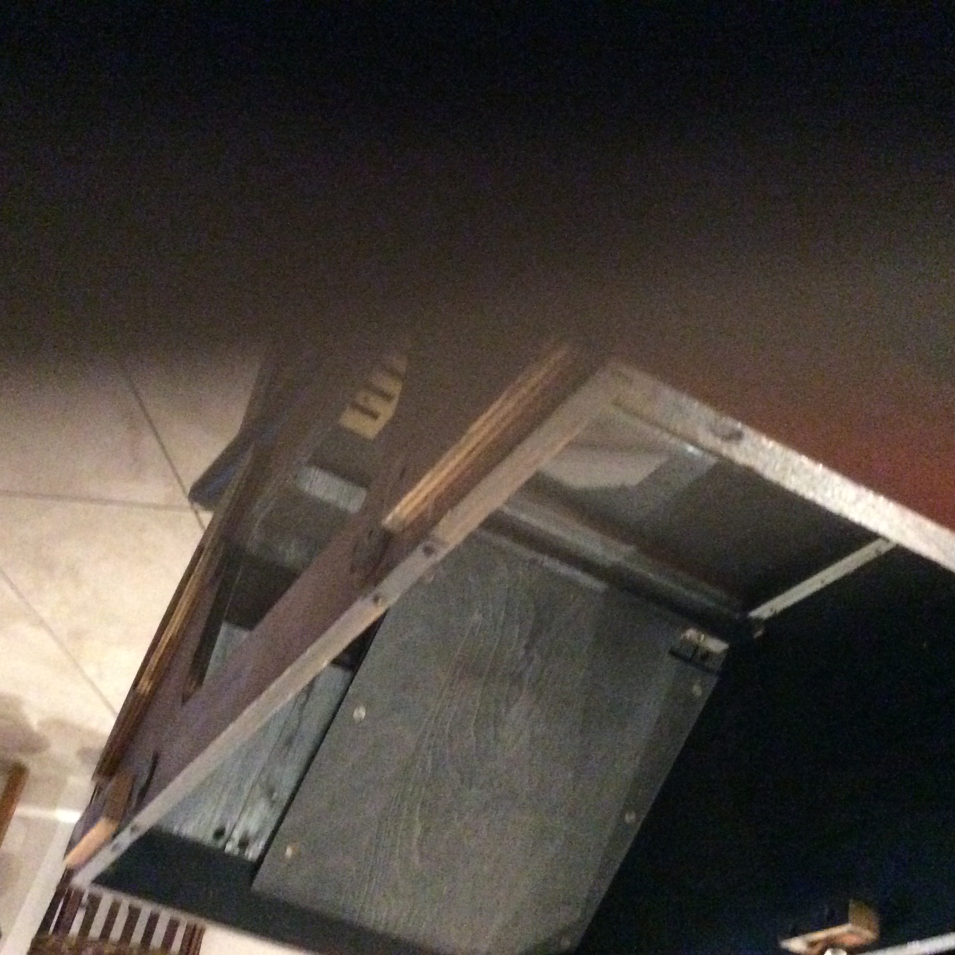

any chance we could see from the inside with speaker removed?
i bet that the curved louvers create a cavity space that may be resonant , might not want to use a two way topology just a good full range and equalize it, heck i'd try a pair or even a quad of TC9's

1947 GEC
image attached. the curved outsides are flat insides. This is getting interesting. Still researching, but I've looked at these and would build suitable crossovers. Buying a SB Acoustics SB16PFC25-4-COAX woofer? - SoundImports

well those photo's aren't what i was hoping to see...i take it that the side with the loudspeaker has a cloth between the baffle and grill and the other side is still a mystery as to whether or not removing the panel would access the louver space...the coax is a tad overkill...this is going to be a bluetooth speaker,no? what amp is going to drive it?

Amp is Dayton Audio KAB250V3; yes, a harp (my wife's)...well those photo's aren't what i was hoping to see...i take it that the side with the loudspeaker has a cloth between the baffle and grill and the other side is still a mystery as to whether or not removing the panel would access the louver space...the coax is a tad overkill...this is going to be a bluetooth speaker,no? what amp is going to drive it?
I bet turk might have been right, as most probably the space between the curved louvres and the flat inner mounting panels aren't filled with anything. Anyway, as it is going to become just another BT unit...🙄image attached. the curved outsides are flat insides. This is getting interesting. Still researching, but I've looked at these and would build suitable crossovers. Buying a SB Acoustics SB16PFC25-4-COAX woofer? - SoundImports
