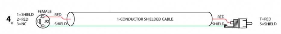

In the Amazon listing, I don't see anything about the specific pin connections but I was mistaken, it is an unbalanced cable. Do you think a DI box would fix my problem?
A DI won't fix wrong cable connections.
You need an ohmmeter to check.
This is how your cable should be wired:
The drawing shows XLR female but the same applies for male.

Pin 2 is the positive input terminal and pin 3 the negative input terminal, so those should definitely both be connected to the cinch connector, pin 2 to the centre and pin 3 to the shield. Besides, pin 1 should be connected to the shield if there is no other ground connection, or if there are issues with RF interference without it.
