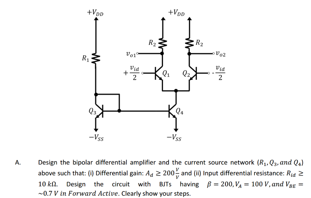

First of all, I am not sure why they have to use a "Gilbert cell" unless that is not the case. In the vid, Paul M. claims that they use something similar but not as complicated as the "Gilbert cell" but what it actually is anybody guess.
Why couldn't they use a simple diff amp and control the bias current therefore control the gain? For example in the circuit attached, you can control the gain by simply changing R1. But then at low bias current, you may run into linearity issue. So by avoiding using a pot, you do run into other problem that might be worse than what you started with.

....Why couldn't they use a simple diff amp and control the bias current therefore control the gain?...
The simple form will "thump". Unless the control signal is super slow relative to signal frequency.
There are of course improved versions. Gilbert has many. In audio, dBx was the pioneer and its brain-trust now works at THAT Corp. However the PA Audio pictures do not show THAT VCA packages. (And I do not know any other VCA product at this audio quality.) Unless what they are showing is just a 'tupperware' around a THAT.
Wouldn't the control signal be a DC source? I mean you could select different resistance for different gain but it is practically a DC signal which is controlling? Am I missing something?
