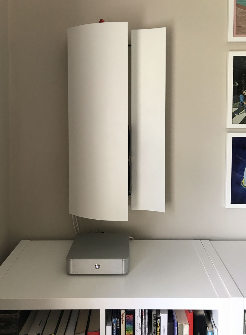

I was intrigued by the Jordon Aurora (photo attached, credit: Jordan website) as it claims to address the 'front wall problem' with what appears to be a simple and elegant arrangement. I've not heard it or seen a review. I don't now how it works, but it seems that it could simple re-direct the front wall reflections off at an angle and away from the traditional listening position.

Um, not sure how different this is from the Roy Allison approach of putting drivers as close to the wall as possible. Not sure what the board in front of the driver is doing though.

this is what it does in a certain frequency range

One solution would be to place woofer/s close to the wall and cross to a midrange that is far enough forward for the quarter wavelength of the crossover frequency to be well above the distance to the front wall. A narrow tower configuration would seem to fit.With all the worrying about pulling speakers fwd off the wall why are there so few options that offer something able to stay close to the wall?
Another solution is drivers arranged to emit a cardioid radiation pattern with the null directed at the front wall.
Me tinks that this is not a good idea.
First, the driver is 4" fullrange in a narrow box, with high directivity above 4kHz.
1) sideways near the wall will boost bass below 200Hz (good)
2) but directs high frequencies 90¤ away, (bad)
3) the reflector throws some of high frequency towards the listener (compensates a little the previous) but also makes more interferences from the nearby front wall (bad)
4) increased portion of reflected energy deteriorates stereo imaging very much (bad)
No wonder we don't see more of this kind of systems...

I find some of the statements on the Jordan site confusing. Free standing speakers are said to provide the best sound, without describing what is meant by either. The wide baffle, shallow designs are said to provide best imagery placed close to the wall. The Aurora seems to be an attempt to have a wall mounted speaker with the advantages of a free standing speaker
I think it is perhaps more of a defractor than a reflector given the panel appears to be close to 90 degrees to the front baffle. The high frequencies will defract off that edge with a fair portion sent towards the listener and a fair proportion sent towards the front wall to be reflected back towards the listener. It looks like a mess but there might be some sense to it if you work it through. Then again there might not.Me tinks that this is not a good idea.
