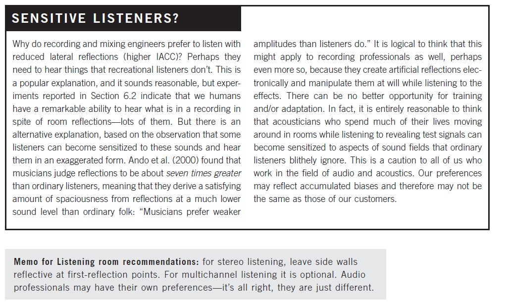

To suggest, as you have done:
that a person's personal preferences are wrong because they contradict your interpretation of an author's conclusions is...
well, rude, to say the least.
well, it's pretty rude and also unfair to suggest that I have done something I haven't
because nowhere I have suggested that Remlab's "personal preferences are wrong"
BTW this would be utter nonsense as preferences just CAN'T "be wrong"
I only have suggested that making a general statements and especially "advices for newbies" purely out of such personal preferences is not right. And please tell me - do You sincerely believe it is?
what is also pretty rude is to write things like "when you learn more ... perhaps you'll better understand", don't You agree?
BTW, Floyd's actual statement:
does not imply there's something wrong with absorbing first reflections, he merely claims it's not necessary. Seems to me you've made an incredible leap of faith to decree that room reflections are required.
to suggest that I misuse Toole's book as a reference is rude too, don't You agree?
hereby I post a scan of Toole's concluding statement on the subject of sidewall reflections
