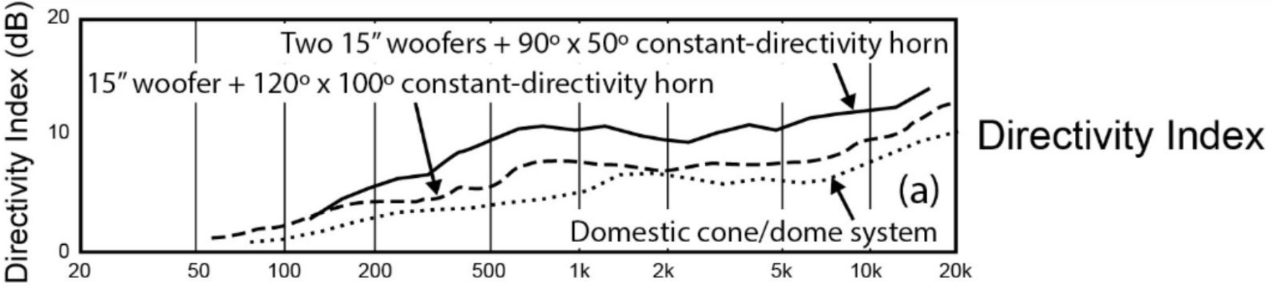

In the industry guideline I referenced earlier, a spec range for directivity index is given. The JBL's I listen begin to have constant directivity starting around 400 Hz. I have reviewed the Kii THREE and Dutch and Dutch 8c which have constant directvity starting around 100 Hz using cardioid tricks.
attachment.php
The graphic above shows the measured directivity over frequency for a double 15” and 90 x 50 CD horn, which are the JBL 4722’s (what I listen to). The 15” woofer and 120 x 100 CD are the JBL M2’s and the Domestic cone/dome system is the Revel Salon 2. The KEF LS50 is a cone and dome system and likely similar to the Salon 2 from a directivity perspective.
For harsh music, which unfortunately has a lot to do with the loudness war with extra midrange distortion due to too much dynamic range compression, a narrower directivity speaker may sound less harsh than a wider one. This is because the wider directivity speaker is adding more room sound at those same midrange frequencies and just accentuate the harshness (assuming both speakers have similar frequency responses). You can hear the comparison on the binaural recordings I referenced earlier between the JBL 4722 (very narrow directvity) and the KEF LS50 with much wider directivity.
