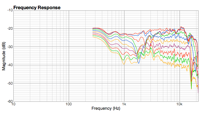

Talking about directivity. Just measured a pair of Behringer B2031P. Unbelieveable performance for such a cheap speaker.
The measurement is windowed and measured with 1.2m distance.

I posted that same speaker on my web site in the Polar Maps App. Yes, it is incredible how good a cheap speaker can be. Its only downside is the limited SPL capability. It is a small dome tweeter and thermal effects will limit its high level performance. Low end too since its a small woofer and extended low end so excursion of the woofer will be an issue. But at low levels its directional performance is very good.

Sounds like they are perfect as surrounds. That's how I use them currently.

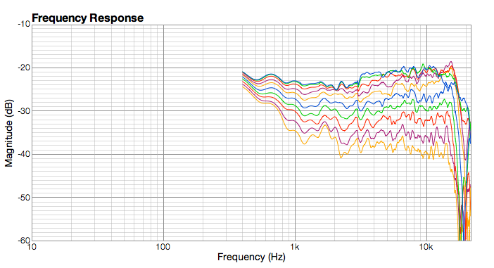

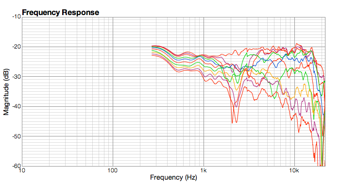

Vertical is not so great but that's a "drawback" of the concept. I've attached 0°-90° upwards and downwards.

Verticle (I left this spelled wrong just so that the Germans can correct it:)) is never "great" at the crossover of any speaker. That's a principle reason that I write off Multi-way direct radiators is the fact that as you try and increase power handling you need more and more passbands and more and more crossovers. There is no such thing as a "good" crossover, only lessor and lessor bad ones. Active surely helps, but it is not a complete solution.
I would like to compare this Berhinger with the Harper as the size is about the same, but the Harper is a little more expensive. The Harper would easily have 10 dB more Max-SPL than the Behringer however. The latest rev of the Harper is really quite respectable.
