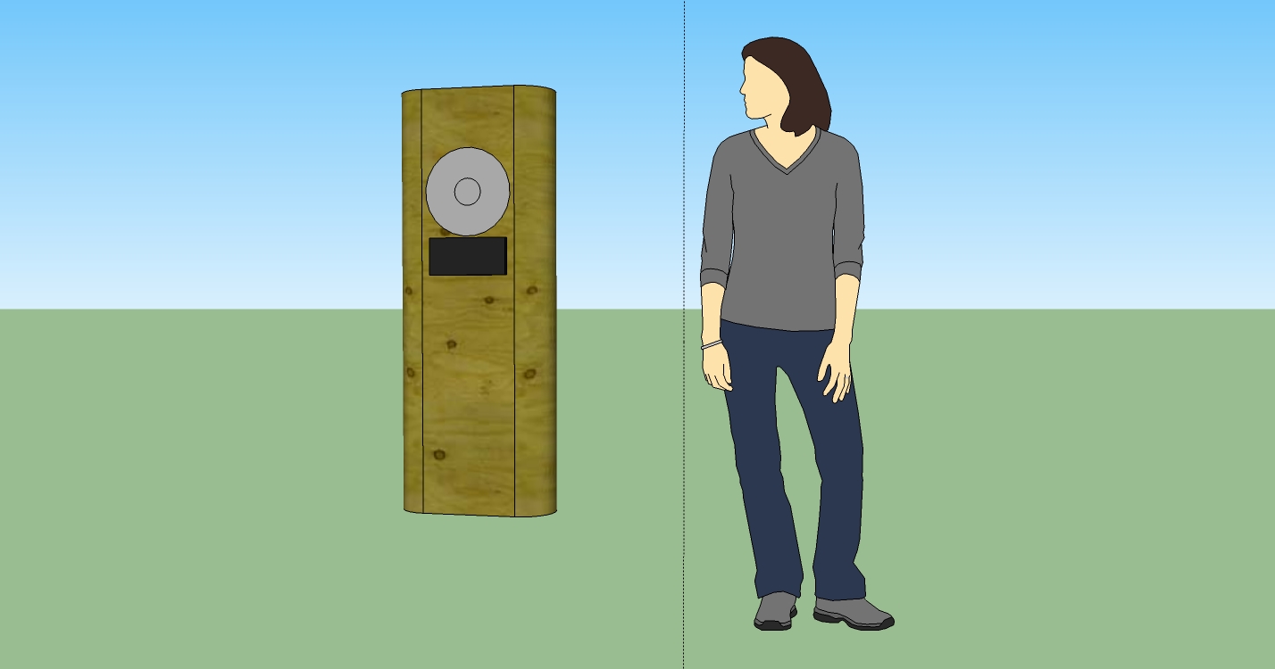

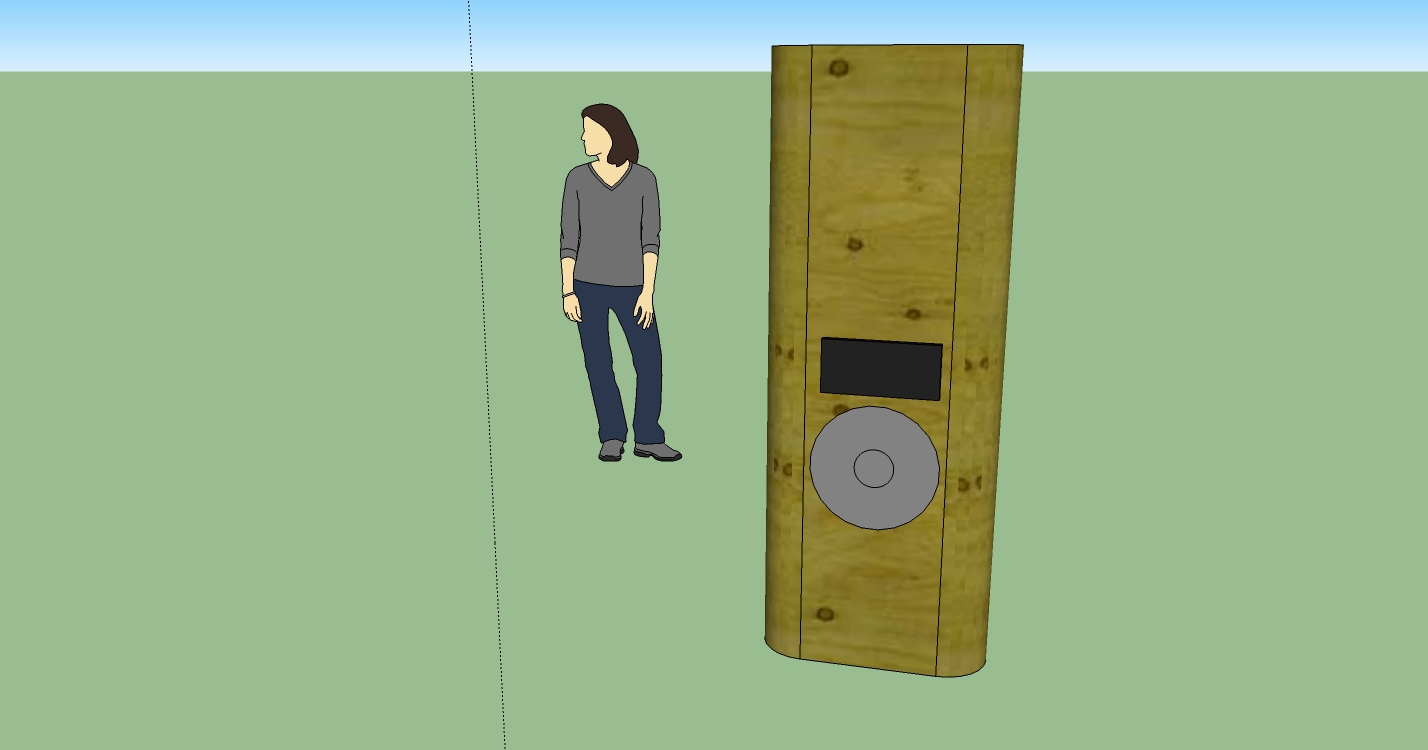

Thinkin' about giving this a try myself. I'm assuming you balance the individual horn/midwoof sections just like you would in a 2 way, but without addressing baffle step (assuming you would have been)
Extrapolation from the no-baffle-step monopole case can be a decent starting point, but the crossover should still be "voiced" with all the speakers in the box they'll be used in. Also, you'll need to take into account the in-phase summing below the wrap-around frequency region which boosts the low end somewhat, relative to the semi-random-phase summing above the wrap-around frequency region.
Naturally, re: starting point and voicing, I'm just wondering if there are any additional issues I may be missing.
The in-phase summation is just the wraparound which makes bafflestep unnecessary, no? I'm sure in many rooms there's also some boundary gain at LF, but it doesn't sound like there's anything I'm overlooking.

That's my hope- the impetus for the build was that I have in my posession 4 3/4" thick, 5.75" radius (or so) semicircular columns of 75" length, paid only $80 for all 4 ($90 per normally) and thus have the perfect start of an extremely smooth wraparound .

In your article you're very clear on wanting the rear woofer at the floor height- I was planning to do an inverted assembly, with my taller speakers having space for the woofer higher up. Is there any reason that the floor is special, or is it just that with normal cabinet heights that's the best way to distribute the woofer locations in the vertical?
Rear woofer down near the floor helps to fill in the floor-bounce dip and reduce the octave-higher floor-bounce peak, and also reduces the depth of the wrap-around notch. However if you plan to listen from either side of the speakers, then imo that takes priority, and you might even go with a symmetrical bipole. Just try to make it considerably wider than it is deep.

Okie dokie. Width is fixed by the driver panel size and half-round width, and depth is fixed by the half-round at abt 11.5". The overall width will have to be between 25-29" depending upon whether I use JBL 123A (12") or a 15".
