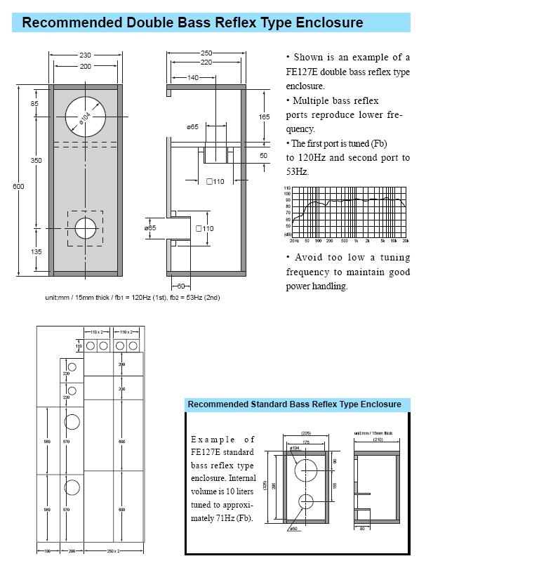

Contemplating This Fostex Fe127 Project
I am contemplating building the attached Double Bass Reflex Type Enclosure for a Fostex Fe127. The project is recommended and designed by Fostex. I think I can build this cabinet. I'm going wait until the weather warms and do the cutting out of doors.
I want to build it using 3/4" MDF. I built a sub cabinet in my basement but the MDF dust was too obnoxious, hence my reasoning for doing the actual cutting out of doors.
My question is this. What do the experts think of the attached project for a newbie builder? Any thoughts about the sound?

Jim,
I'm not sure what the experts might think, but it looks fairly simple, so why not? You'll gain some experience constructing a speaker cabinet and it'll give you something to listen to while you build one of the Frugal site designs.
Just remember that the "experts" are usually those with a fair amount of experience, and experience starts the moment you begin.

ttan98 said:
Planet 10 is the expert on this driver, he may you recommend the Fonken cabinet, with more bass and few other mods to consider at a later stage.
gee Terry, since I've built at least 8 different designs for this driver, does that make me an "expert"? :angel: Frankly, this driver is capable of much more than either of the "factory recommended" enclosures can deliver. The same can be said of the FE126E.
"Fonken" has really morphed into a family of enclosure designs of different configurations, but using essentially the same loading/ tuning criteria. Dave might want to elaborate on that detail - I just build and listen to them. The original multi-slot port, bevel sided cabinet is by far the most PITA construction of the bunch, but still edges the others out by small margins in delicacy of lower midbass & down articulation. They are my "daily driver", well sited they can do quite the disappearing act.
For a builder looking for a relatively easy project using the FE127E, I think it's fair to say the "Classic GR" or "Floorstander MkII" would be a safe bet. The latter can particularly be made very wife friendly, and don't need stands, but due to their very narrow baffle, could require either BSC ( 😱 ) or corner/boundary loading. (and don't forget the sand / shot ballast or enlarged plinth - they can be more than a bit tippy)
A slightly larger pair of enclosures (as in wider) that squeeze a bit more low end extension from the FE127, at the price of refinement, and with the risk of exceeding the driver's X-Max when overdriven in a large room, are the Mileva and Brynn. These are also floorstanders, and with the appropriate cosmetic treatment, can earn huge WAF points, and sound excellent.
and please, if not plywood, then at least particle board instead of MDF :clown:
As for maximizing the bass from this driver - careful how you approach that - you could well sacrifice what it does so well from the lower midbass up. Outstanding performance can be achieved with ScottMoose's BVR designs - i.e. the Brynn could be considered a "half-sized" enclosure - I can assure you their is nothing pint-sized about the sound! However, for those domestic situations wherein a 60" tall double mouthed horn might be a hard sell, another approach would be a pair of active woofers crossed over anywhere between 80 -120Hz . The new CSS SDX7 is a dynamite performer, and works great in pretty small sealed enclosures, and sub amps are so damned cheap these days .....

ChrisB-
" If not plywood, at least particle board".
I thought I'd read every thread every where on this subject and though I agree regards baltic birch I don't think I've seen your statement before. Why? You can't run a router on particle board, it'll chip so roundovers are out and it's lighter so I'd think sonically not as tight.
Bluto
Bluto said:
ChrisB-
Bluto
guilty of chumming the waters....
It can't hurt to try thin particle board (1/2" or 5/8") with strategic hardwood or plywood bracing - it could sound faster than MDF . Why is "lighter" necessarily not "soncially tight", or even a bad thing for a full range driver enclosure?
The quality of joinery and assembly will have at least as much impact on the musicality of the sound the enclosure contributes to the system as the material.
Having said that, my experience with multiple versions of at least 3 different enclosure designs has lead me to the conclusion that some materials are more "noble" than others. For example, 3/4" bamboo plywood is lighter than 1"MDF, but is an absolutely brilliant material for loudspeaker enclosures.
Can't run a router on particle board - maybe you're thinking of OSB? A large percentage of melamine, PVC or thermofoil wrapped panels used in lower grade furniture are particle board core, and include a lot of routed / shaped and machined profiles edges, and even glue-lock mitered joints.
Sure the exposed grain would need much more prep for paint grade finish,(or will absorb more glue than MDF) Proper finishing of even high grade MDF takes skill and once you fully account for the time and materials, can cost more than veneering. Of course, I'd prefer the speaker cabinet to look a much like real wood as possible, and that's what works for me.

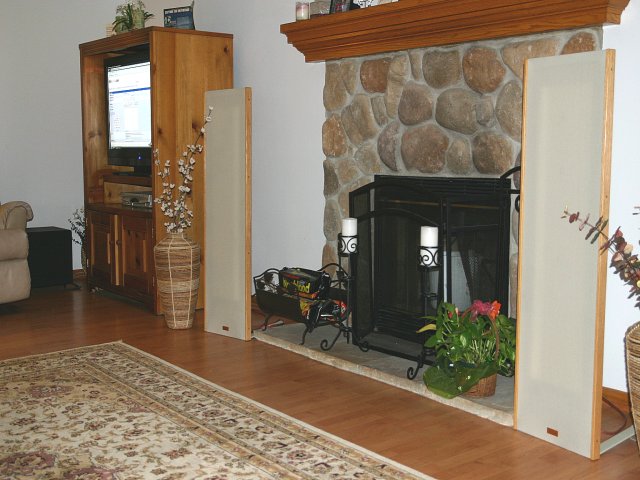

The room is 18'X24'X8'.
The amp is a PS Audio C-100 inegrated amp with 100w/ch @ 8 ohms, 200w/ch @ 4 ohms. This is an ICE digital/class-d amp.
High WAF needed. It MUST look good and non-intrusive. Currently I have a pair of Maggie MMGs in the living center. The wife is OK with that. See attached picture of room and MMGs in the attached thumb-nail. Keep in mind the wide angle lens makes the room look much bigger than it is. The black box is my Parts Express 10" Titanic subwoofer.
Will my proposed project work in my room?...thanks .....jim
Jim - I'm thinking that for a room that size, the FE167E might be a more suitable driver, and can suggest the Demetri, or the half-sized (Chili) Chang BVR enclosure.
I'm currently running both the scaled down versions for the FE127 ( Mileva and Brynn respectively). One of my rooms is much smaller than you've indicated, and the only issues result from room compression - but in the larger room (15x26x8) either can certainly "hit the wall" if driven hard enough - this is not a problem with the Demetri&FE167.
If you already have the FE127E in hand ( or on order), for a room your size, you'd probably be much better off high-passing them ( my initial guess would be between 120-200Hz) to a pair of active woofers . In which case the enclosures for the FE127E's could be relatively small (i.e. mini-monitor size), and with appropriate selection, the bass drivers could be incorporated into stands. Such an arrangement can certainly be made wife-friendly, and could occupy less foot-print than the Maggies.
