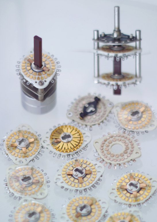

What will be the contact resistance of a very high quality gold or silver contact rotary switch ?
It should be much less than 10 mOhms if it is a well made switch.
The gold-flashed silver contact Elma miniature "01" series is 5 mOhms as a guide, and the NSF "JMK" series is <3 mOhms.
Even a cheap (less than 1 Euro) Lorlin "CK" series with brass/silver-plated contacts claims <10 mOhms.
All these examples are 'initially', so they probably do detereorate with use as a Grayhill version suggests 20 mOhm initially, with a max. of 50 mOhm, but I think that is a poor example of switch contacts.

I agree
when you have clean metal to metal contact, as intended, the figures are a few milliohms. Note that dirt and oil can affect all metals even gold. Silver Oxide is a conductor (good) but silver sulphide (from atmospheric contamination) is an insulator. Gold is preferred for small signals, low power, silver when there is some current being switched.

Can 8mA be regarded as some current ?
I need to switch currents up to 8 mA to ground through resistors that have values as low as 30 milliohms.
For I/V conversion.

I think the variation in switch resistance (repeatability) is going to make achieving accuracy difficult.Bernhard said:thanks

8mA is very little current, OK for gold contacts. Have you considered the effect on your circuit performance when the contact resistance of two switch positions may be different by 10 or 20%? You could ask the maker of the switch what is the tolerance for contact resistance. In your application you may need this tolerance to be quite small (what is 1dB in ratio? I think about 5%) and it is not known what tolerance the switch maker will state. I have never seen a switch specification that gave a tolerance for contact resistance, the only thing you see is a general specification of the nominal value, maybe 3 milliohms or 10 milliohms with few details given for current, signal type or voltage. Maybe you are asking for too much performance from a switch that perhaps it was not the intention of the switch designer. But maybe I am being too cautious, maybe you will enjoy the experiment, why not?

lowest volume step -60dB = 0,031 ohm
+ 0,005 ohm variation in contact resistance = -58,8 dB
second lowest volume step-57,5 dB = 0,043 ohm
- 0,005 ohm variation in contact resistance = -58,3 dB is very close to -58,8 dB, so the last steps could become very uncertain.
If the variations are that huge. In that case I would use two switches with one 0,062 ohm in parallel with each switch.
Also as mentioned before, I can use 62,5 ohm for 0 dB and 0,062 for -60 dB if I want.
As for the sketch, the rotary switch switches the different I/V resistors from Iout to ground, that's all.

oshifis said:Alternatively, you could create an L-pad for each switch position, then the I/V resistance could be constant.
Not sure if I understand this one.
oshifis said:In any case, I would avoid connecting the switch contact in series with the resistors.
I could use 26 dividers and select each divider by switch , so the switch does see full voltage and current swing. I need another switch for the impedance matching resistor.
I was looking at the same thing.
The only difference was I was going to use a 4:1 step-up transformer as a passive output. For more details, see the RAKK DAC passive output stage.
The advantage is that the contact resistance is reduced by the square of the ratio (in my case by 16).
