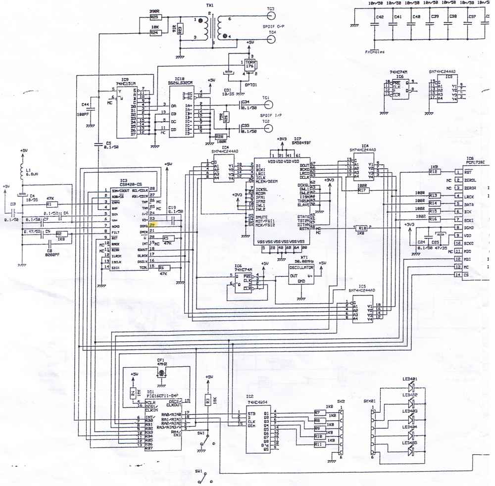

If what you want is to convert the coax spdif digital out from the cd player to 5 volt TTL level signal take a look at this schematic and do likewise, it works and it´s simple. 26ls32 diff. line receiver
