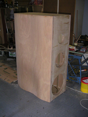

Some very interesting posts ... thanks guys. I have a number of comments and questions to bring up, but I'm out of time today. Back soon ...
I used three layers of plywood and a a very strong "matrix bracing".
I used polyurethane glue. It swells during drying so it fills all possible air pockets.
Getting a suffisient pressure by using screw clamps was more or less impossible so I used several screws to attach plywood. I tooks the screws out after the glue had dried. I put the screws in different place in every layer and the swelling glue filled all the holes so there was no downside using screws. I veneered the sides of the encluse by using contact glue.
http://www.dvdplaza.fi/forums/attachment.php?attachmentid=775
I use 1/8'' baltic plywood on radii as small as five inches no problem and 1/4" on radii of twelve inches and up, so this box should take 1/4" easily. You just need to make internal bracing to screw it to ala boat or aircraft frame/skin contruction. Cylindrical walls are almost impervious to vibration, so even with a sub I suspect two layers of 1/4'' would suffice. Use only 3 equal thickness plies; plywood with thin veneers over a thicker core don't bend well.
