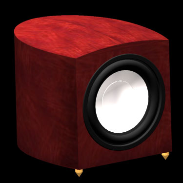

I have worked out how to do everything except the top curve. My plans so far:
1. build the matrix bracing, which will also form a template for the curves
2. flat MDF sheets will be added for the top and bottom and the front baffle
3. 3mm sheets of MDF will be bent around the matrix bracing to form the curved sides and rear of the box
The construction will include constrained layer damping - a box within a box with liquid nails between. I won't go into this as I have resolved how I want to achieve this. The most difficult part is:
4. adding the top curve. Moving along the top of the box from the front baffle to the rear there is a gentle curve reaching a peak in the middle so that the edges around the box are at the same height (excluding at the front) but the middle is raised. Note: very similar to B&W subwoofers.
My query: how to get the top curve
* I don't want to do it by planing a single flat sheet of MDF with a belt sander or any similar technique! I have done this before, the results are less than ideal, and it is extremely time consuming. I can live with tedious if the result is just right, but not if it doesn't look quite right.
* The finish is piano gloss black so accuracy is important
Suggestions? ......

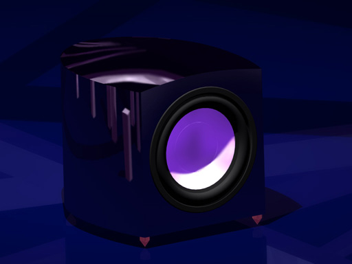

Bill Fitzpatrick said:Still too dark. Ditto with the graphic on your home page.
How come so dark?
Bill,
To my eyes, sites with black text in white background is very glary and hard on the eyes. I find mine easier to look at, and it also has the kind of look that I want. If you can't make sense of the image, then perhaps you could adjust monitor settings. I have noticed a lot of people have their monitors set so that they lose shadow detail.
But still Bill, I changed the image for you and still no response to the actual question!

Your method sounds a little bit arbitrary - ie sounds a bit like how you would create a sculpture, not the level of accuracy and precision I'm looking for. I have already worked out a way to do all of the box except the top. A piano gloss finish means I need to achieve this, as the reflections will show up imperfections readily.

I don't understand the problem. Do it the same way you are doing the rest of the cab, by using braces to get the proper bend. It's only a slight bend, so having different degrees of curvature shouldn't prove too difficult. Experiment with a thin piece of plywood and mdf first to see which works better.
It looks like a compound curve. Not easy to achieve in wood.johninCR said:...I don't understand the problem...
Perhaps it would be easier to use a very thick flat piece for the top, then carve it down to the required curve.
