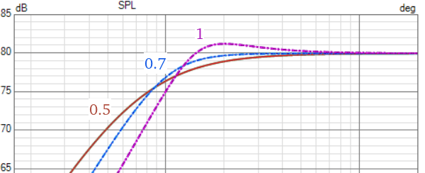

What do you want to know?to be able to better understand the Bode plot implemented for the responses of the woofers,
Me gustaría saber si lo he entendido bien. Lo que entiendo es que en el eje Y están los dB o volumen, y en el eje X las frecuencias, por lo que donde la línea del gráfico esté por encima de -3dB, se escuchará esa frecuencia. Pero no sé por qué la mejor respuesta es la máxima plana.¿Que quieres saber?
Are you having trouble with google translate?
Approximately maximally flat helps you to get more bass and it allows it to be presented smoothly.
Yes that is generally correct. Q=0.7 is about the average, a little more or less is OK. You can still hear below -3dB.I would like to know if I understood it correctly. What I understand is that on the Y axis are the dB or volume, and on the X axis are the frequencies, so where the graph line is above -3dB, that frequency will be heard. But I don't know why the best answer is the flat maximum.
I understand,
What do you mean by Q=0.7, a little more or less is fine?
And if below -3dB you can still hear, why is it generally said that this is the cutoff of the frequencies?
Why does the maximum flat give more bass? What happens if I have a dB peak up to 2dB at 50Hz, then drops to -1dB at 70Hz, and then continues rising flat, wouldn't there be more bass in a response of this type than in a completely flat one? (the situation I raised is an example)
Maximally flat means Q=0.7 😉What do you mean by Q=0.7, a little more or less is fine?
It is the half power point.if below -3dB you can still hear, why is it generally said that this is the cutoff of the frequencies?
More upper bass but less lower bass.What happens if I have a dB peak
what do you mean by this?More upper bass but less lower bass.
Ah ok, thanks!Maximally flat means Q=0.7 😉
I don't understandIt is the half power point.

This is CLASSIC sealed box Q info.View attachment 1322250
Below this point, less than half the power is delivered compared to the passband.
Yes, I probably didn't have to sim it just now but I seem to recall last time I went looking for this same information I didn't like the plots. Some don't show the change in frequency, some might need to be explained since they have extra unneeded information.
In this one you can see 0.7 has the lowest f3
