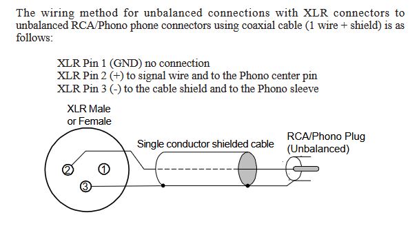

Hi... my Lynx PCIe card allows me to change its digital I/O from AES to SPDIF via a jumper on the circuit board. I have the Lynx digital I/O breakout cables but they terminate to 3-pin XLR. So, in order to connect the digital signal to my Topping DAC's RCA coax connection, I need to build a short length XLR to RCA adapter cable. Lynx offers one (see pic) but since I already have a Monoprice 75 ohm RCA coaxial cable I'm not using, I thought I'd splice it and connect the other end to a female XLR jack.
Could someone help me with wiring the XLR side of the cable? I've seen a few diagrams online but I'd like to get the information here.

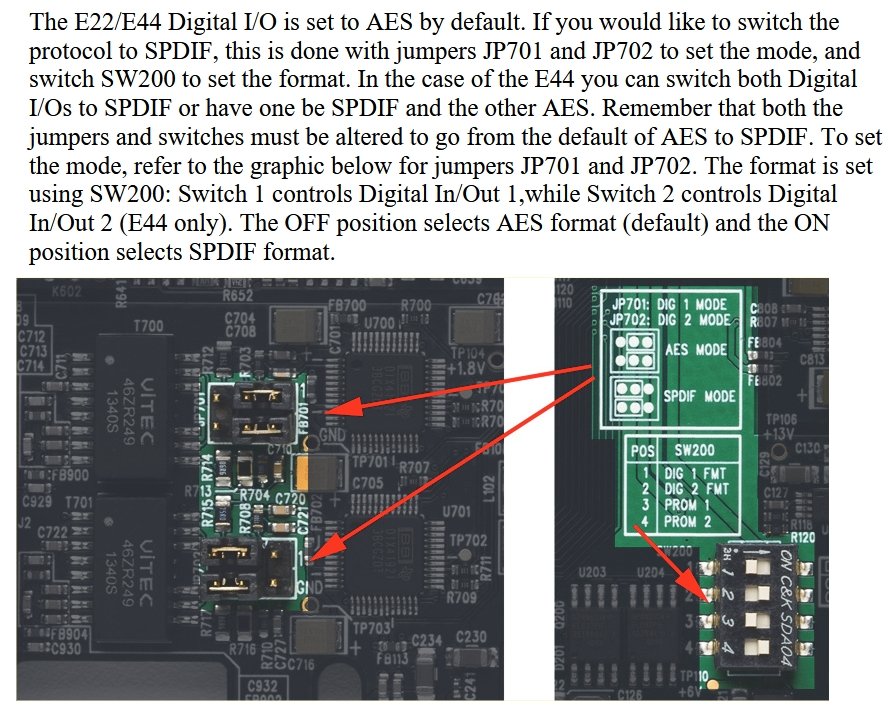

Is there any indication what this switch does: only change some subcode bits or also change impedances and levels?
When those subcode bits don't matter, like for most DACs, you normally interface an AES3 output to an S/PDIF input with a special transformer and a few resistors. If the output is already transformer-coupled, you might be able to get away without the transformer.

It seems Lynx has 2 almost identical looking XLR-RCA adapter cables so it is possible they are wired differently. Hot wire (XLR pin 2 to RCA center) should be the same but cold wire connection may be different. But likely only 3 possibilities for cold wire: pin 3 to RCA shield (as in picture), pin 1 to RCA shield, pins 1 & 3 to RCA shield.

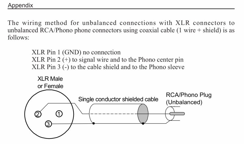

This is from the manual of another Lynx audio card. Based on the manuals the digital interfaces in these Lynx cards with selectable AES/SPDIF are transformer coupled.
Hey thanks for posting that. I got a response from Lynx today and that's exactly the diagram they sent me. I'm not sure if it's viable for Audio connections but it is for S/PDIF connections.
