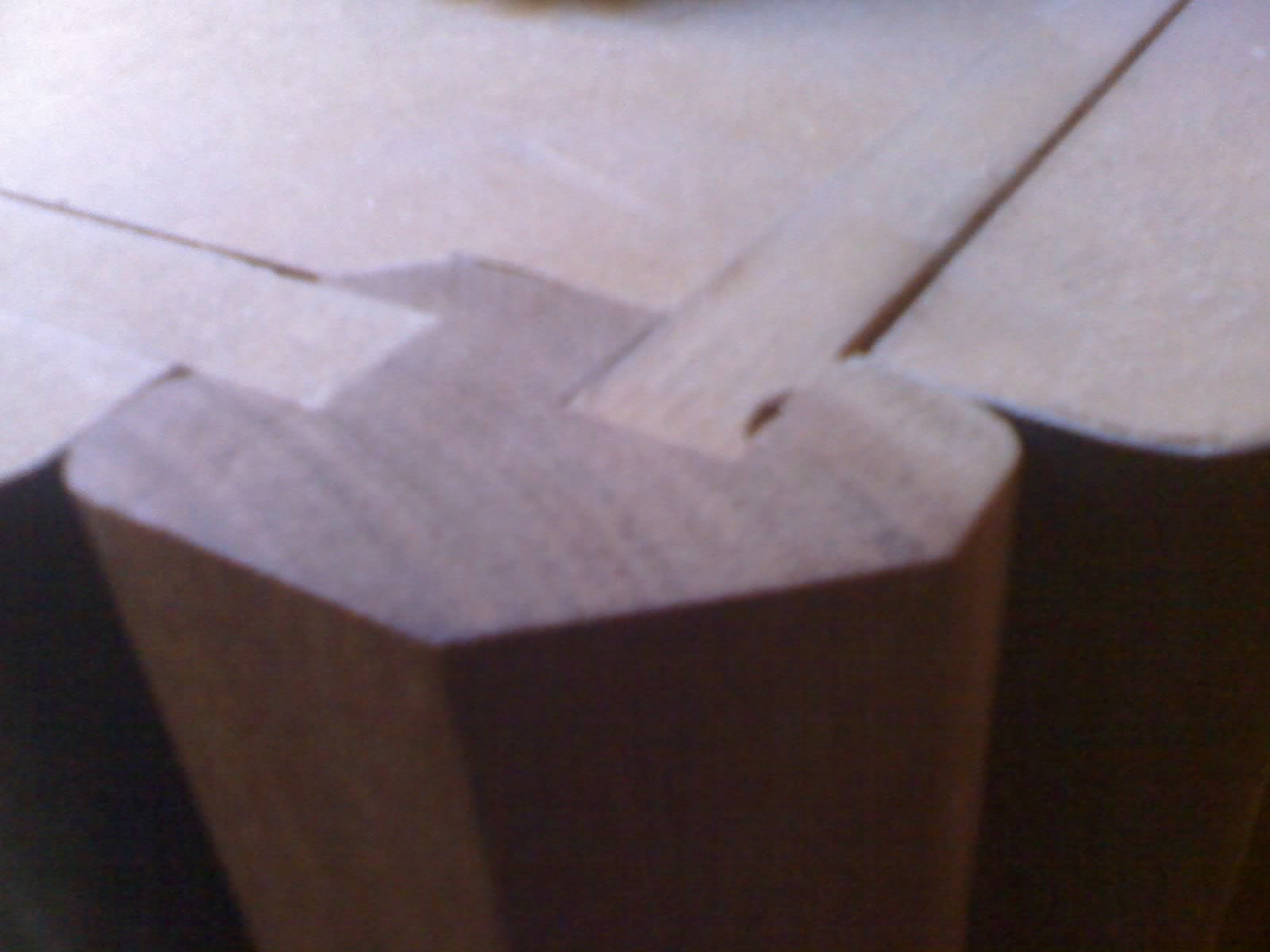

One I tried when doing R&D worked well. Two layers of HD3 bonded with 3mm sheet rubber. The rubber is usually used to water proof decks, concrete roofs etc. I used a contact cement to glue them together. The vibration energy didn't get through the rubber. Bad side was trying to fit the panels together. Only way to easily do that was to use corner sinks. These are heavy corners designed to stop any energy from going from panel to panel. Worked well but the corner had a tendancy to fix the two sides at the edges.
The attached pic is from the initial tests of using corner sinks just to explain a little better. Corner material was Jarrah, a very dense timber.

For the Green Glue to be effective, you want there to be some space between the two panels, only attach them at the edges/corners.
Ideally, you would build two seperate shells seperated by lines of green glue spaced every couple of inches - the two seperate walls of the enclosures would not be firmly attached except at the corners.
The inner enclosure would be well braced.
I used clear silicone to bond the layers together:

I was talking with the supplier of GreenGlue in Oz ,they made an internal cabinet then covered it with green glue then made an external cabinet to encapsulate the internal cabinet .The gap between the 2 layers was not greater than 0.5mm and both board's were the same thickness and material for CLD to work .
SikaFlex and LocTite make a similar product but minimum thickness needs to be 2mm .
For my own cab's I'm using 5086 alloy and ply .The alloy baffle's are light weight and very stiff no flex .
