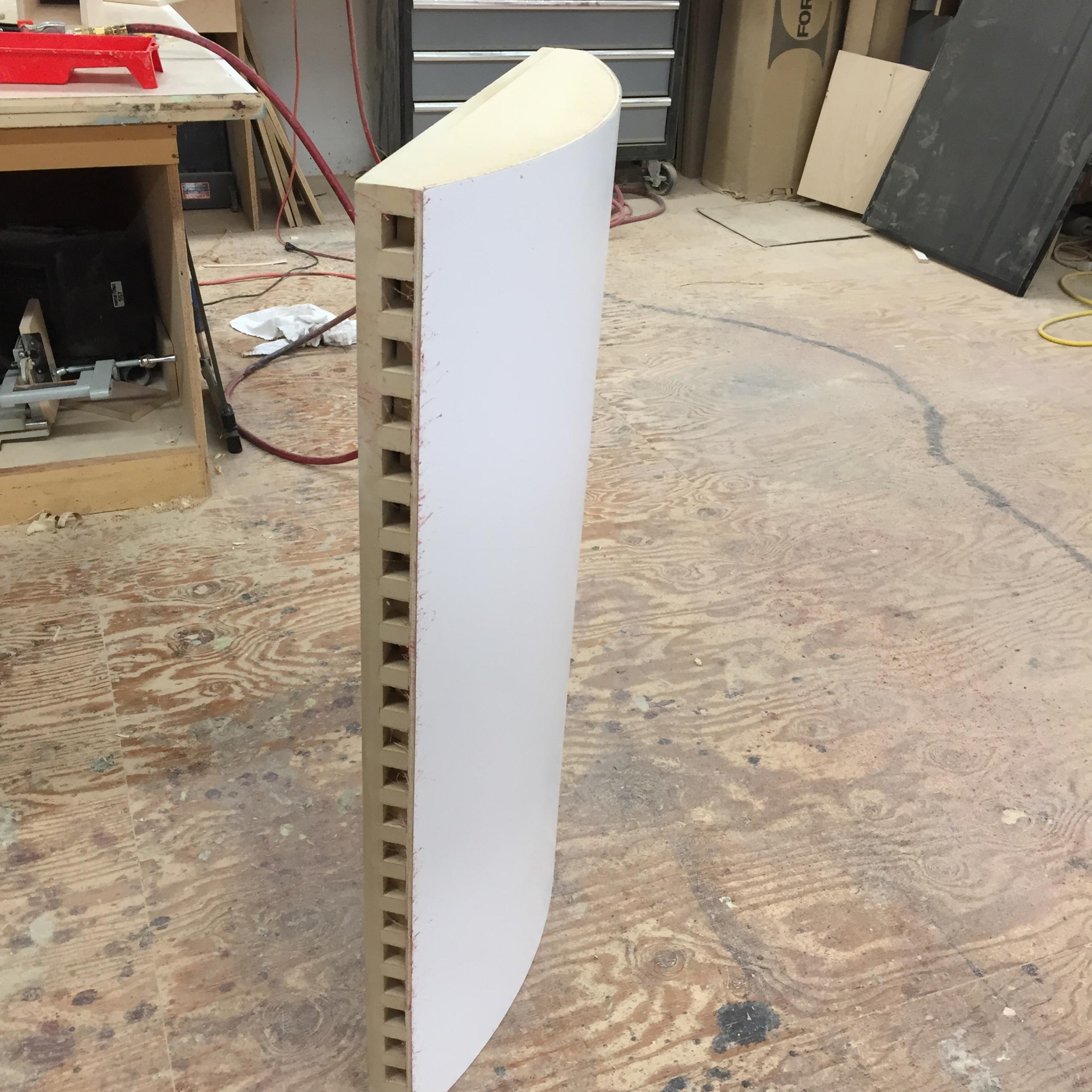

Our 1st experiment in such:

The only foam used in the Ellipses was in the vent openings - closed cell foam, I think - recycled from computer parts packing via Dave.
The vacuum bagging was for the curved panels, and was done separately. Almost as much time is required to make a sturdy enough form as for the first couple of layups. Three layers of rubber ply were laid up with yellow carpenters' glue ( Titebond I ), and pressed for approx 4 hrs each. It's the yellow glue that makes the curved panels very rigid, but perhaps the constitution of individual layers would qualify this as a type of constrained layer . Rubber ply itself is very floppy - two layers of soft meranti or equivalent veneer, with grain running the same direction, and an internal layer of synthetic rubber.
The curved panels were then trimmed and glued/clamped/nailed to plywood skeletal frame. An 1/8" layer of MDF was contact cemented to the rubber ply panels to provide smooth surface for finishing. Quarter Cut Sapele veneer with 3 coats of ML Campbell Krystal post catalyzed laquer.
All internal fill was Ultratouch recycled denim insulation, 1/2" in the isolated TL for the Alpair7, and 2" in the sealed compartment for SDX7. IIRC, there was also some loose Dacron / Acousti-stuff fibre in the TL - "tuned by ear".
Including the fabrication of the bagging form, skeletal frame, veneering, etc, there was at least 100 hrs in these babies.

The theory for constrained layer damping and restrained
layer damping indicated for boxes restrained is better.
Restrained works best in the centre of a panel, whilst
constrained works best at the edges of a panel. But
corner joints stop constrained working effectively
whilst having no effect on restrained damping.
Hence nearly all damping in speaker boxes is the
restrained type, inside damping panels on the walls.
Constrained has been used in commercial boxes,
History of the Signature speaker | Qln, note the mention
of Q board for the initial version, but how little they
actually mention it, because it doesn't well at all.
Constrained for a dual layer OB, now your talking.
But you must leave the edges of the two layers free.
rgds, sreten.
