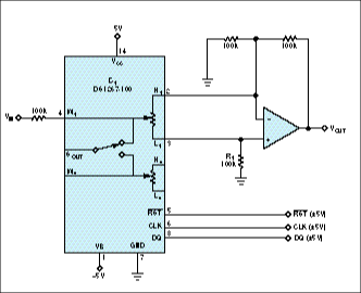

circuit of mrfeedback
Hi mrfeedback,
Your first circuit is definitely different. I suppose that the two switches form a SPDT switch (both open makes no sense, both closed neither).
In case the upper one is closed you have a normal inverting amp with gain is -1 and a shunt from the - input to the ground which has no function other than a small increase in noise. There is no voltage across that resistor; the - input is already a virtual earth. Input resistance is 100k with the given values.
In case the lower switch is closed, you get a gain of +1, because you first attenuate the signal with a factor of 2 and then amplify wih a factor of 2. But the input resistance is now 200k with the given values.
Disadvantage of this circuit is the different input resistance for positive and negative mode. Also a break before make switch is required otherwise you get a nasty plop at the output when both opamp inputs are short circuited.
I prefer my circuit. 😎
