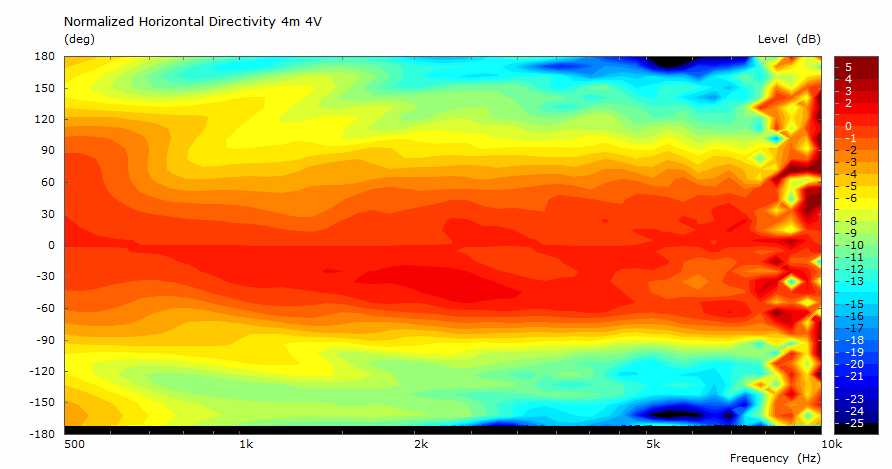

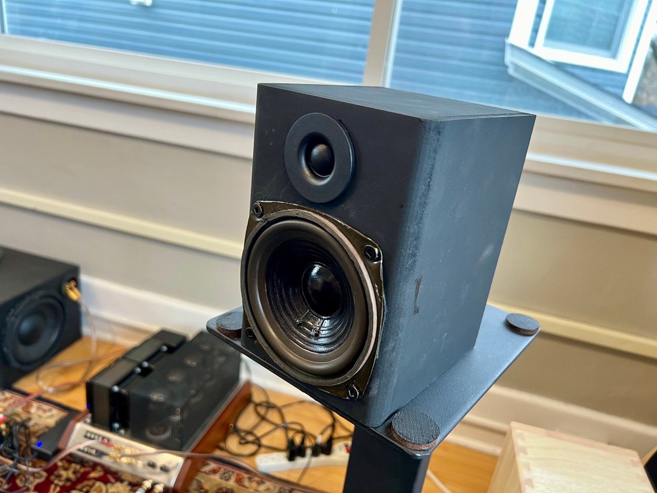

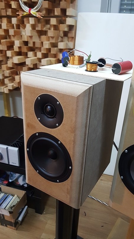

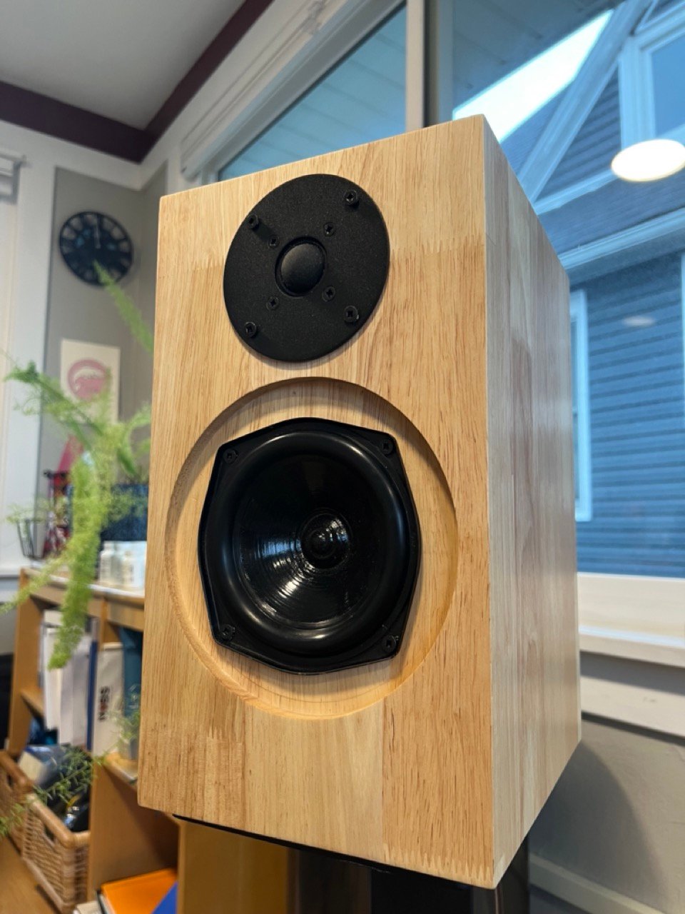

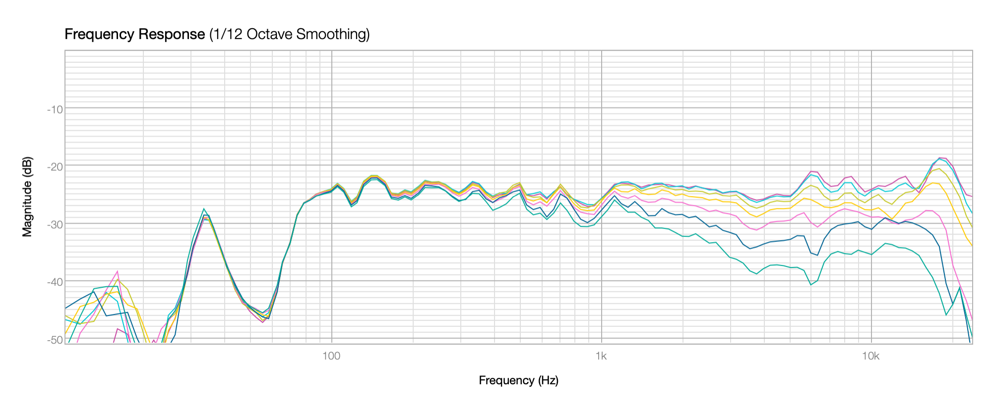

Example #1: 5” 2 way with dome tweeter. Focal 5N402DB 5" woofer + Audax TW025 25mm dome. Front baffle is 8" wide.
First I tried a 1700Hz crossover which got me this frequency response at 0, 15, 30, 45, 60, 75, 90 degrees off axis:
Notice some "bunching" around 2500Hz. This bunching comes entirely from the tweeter, as the crossover is 1700. At 45 degrees off axis, the output is +4dB higher than on axis.
BUT guess what… if I set the crossover at 4900Hz I get this:
Theory (what I thought I knew about tweeter dispersion = omnidirectional below 8KHz) said this was impossible. Simple theory would predict the woofer is directional above 1K while the tweeter is not directional until 8-10K, but as you can see here, the tweeter’s directional characteristic matches the woofer’s almost exactly.
I might have just thought it was odd and shrugged my shoulders and went on, but I noticed the same thing with another smaller system – A JVC HSA1014 + Dayton ND16FA. Cabinet is 4.5” wide and 6.5” tall.
I attempted a 3KHz crossover and got similar results as my first try above (bunching around 4KHz), but then a 7KHz crossover got me this result:
This is an almost perfect Constant Directivity result above 1KHz with considerable directionality from a tiny 16mm tweeter… which I would expect to have NO directionality!

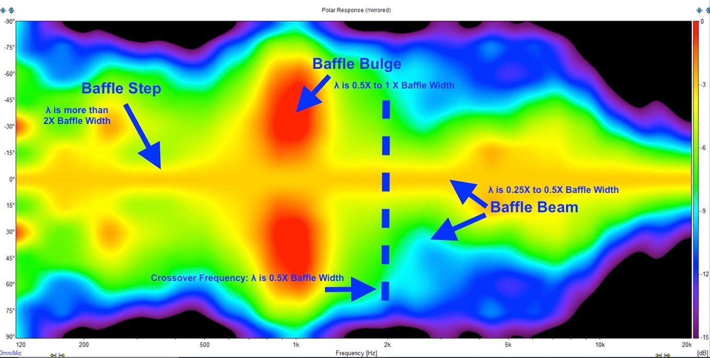

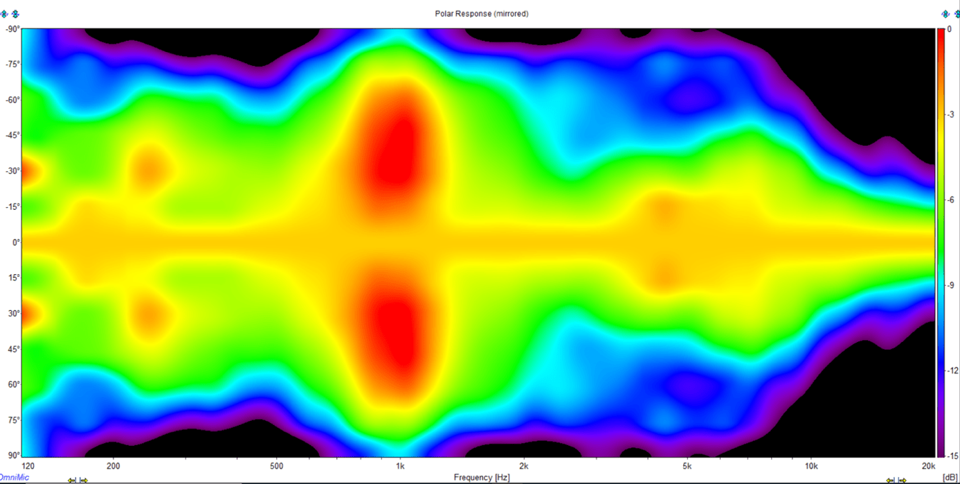

This was a big surprise. So I got curious. This reminded me of a phenomenon that I observed with the Live Edge Dipoles, which have a wide 19” live edge wood baffle and an 8” coaxial mid-tweeter. The Live Edge Dipoles have a minor but noticeable “bulge” at +/-45 degrees off axis, at about 1KHz:
On the low end, Dipoles start rolling off at λ = 2X cabinet width, and normal box speakers similarly have a -6dB Baffle Step at λ = 2X cabinet width. Lots of speaker designers know about these.
Now there are a couple of other baffle diffraction modes I don’t recall getting much attention. If you know what you’re doing, you can really take advantage of this and achieve Constant Directivity without horns or waveguides.

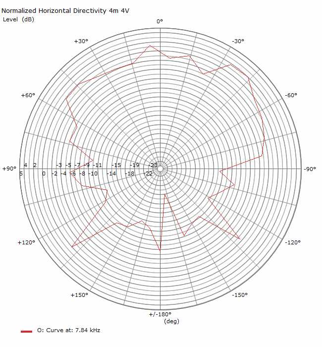

It turns out this +/-45 degree bulge at 1KHz in a 19” wide baffle corresponds to the 2.5KHz bulge from the 8” wide baffle, which also corresponds to the 4KHz bulge from the 4.5” wide baffle. I call this Baffle Bulge. It occurs across a range of λ = 0.5X to 1X cabinet width. At this frequency the on-axis response is the “normal” and “expected” but the off-axis response has a peak caused by diffraction from the edges of the baffle.
Then at even higher frequencies, where λ = 0.25X to 0.5X cabinet width, you get a Baffle Beam and over this octave, on-axis radiation is strong; but off axis drops off much like if you had a waveguide.
So if I draw these points on the polar plot above, it looks like this:
So this means in the 5” 2-way with 8” wide cabinet, most people would cross the tweeter at 2-3KHz fearing that the woofer will get too beamy, and has too much cone breakup. That’s what I did in my first attempt. But what I found was: Even the small 5” woofer begins to beam above 1K and then the tweeter has +4dB lobes at +/-45 degrees at 2.5KHz and the off axis response is very uneven.
Yet if I cross it over at 5K, the woofer’s natural beaming has already kicked in and is not as bad as I feared; also, the woofer’s beaming is not affected much by the front baffle dimensions; and then the tweeter is benefiting from Baffle Beam from 4KHz to 8KHz; and above 8KHz the 1” dome begins beaming naturally because of its dimensions; and viola, I get Constant Directivity behavior from 500Hz up. The combination of woofer beaming and calculated cabinet diffraction gets us almost identical polar patterns and CD behavior from woofer and tweeter alike.
Again:
In the 4.5” 2-way with 4.5” wide cabinet, the woofer’s beaming from 3-7K is matched by the tweeter’s Baffle Beam above 7K and even this tiny system gives me Constant Directivity behavior from 1000Hz up:
I’ve been designing speakers for a long time, so I’m conditioned to avoid woofer beaming and breakup and handoff to the tweeter at a low frequency. But it turns out if your woofer has well behaved gradual breakup modes at the upper end of its range, and you design the crossover appropriately (the woofer crossover on both of these was more complex than usual), you get the fantastic imaging that CD designs are known for and both of these systems are well behaved at the upper end of the woofer’s range.

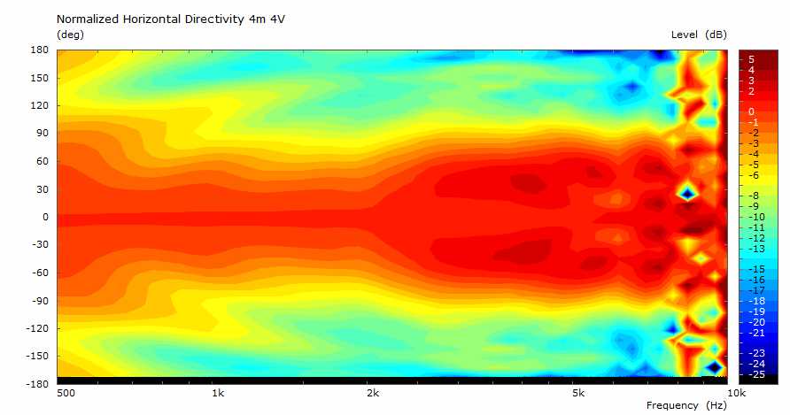

So I asked Jack Regula ( @nc535 ) to run some simulations to shed light on this. All of these simulations are of a 1” tweeter only (there is no woofer in the simulation) mounted on a box of dimensions 8” wide x 13” tall.
So let me step you through the research Jack and I did. First, Jack experimented with rounded vs sharp edges, and found that an 18mm bevel on each edge greatly reduced high frequency ripple. So all the simulations that follow assume that 18mm bevel.
Secondly, asymmetry in diffraction is also desirable. The worst situation is a tweeter in the middle of a round baffle. Second worst is putting it in the middle of a square baffle. Third worst is putting it in the middle (as I admittedly did in my small 2-ways).
When Jack put the tweeter in the center of the baffle, this is the polar heat map he got:
Notice significant “Baffle Bulge” at 2.5-4KHz which we are avoiding by choosing a 5KHz crossover.
Jack moved it off center and found a really nice spot here. The red dot is the tweeter location:
At this off-center position, Baffle Beam is working for us from 4-8K and has no nasty peaks or surprises:
[Please note that Jack’s models have irregularities above 8K that are a result of not using tons of points in the calculations, to save computer time – artifacts of the simulation.]
Jack ran simulations on infinitely wide baffles, where he confirmed at all frequencies below 8K the tweeter has no directivity and the polar plots look like this:

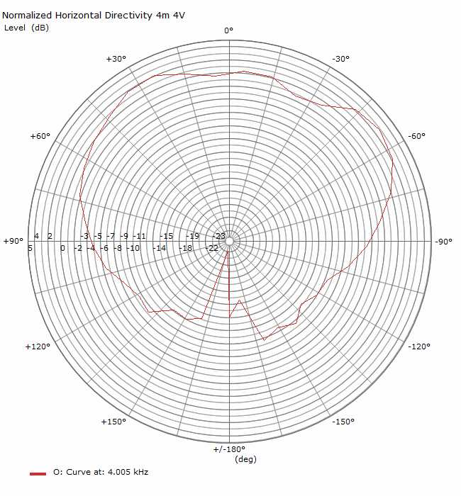

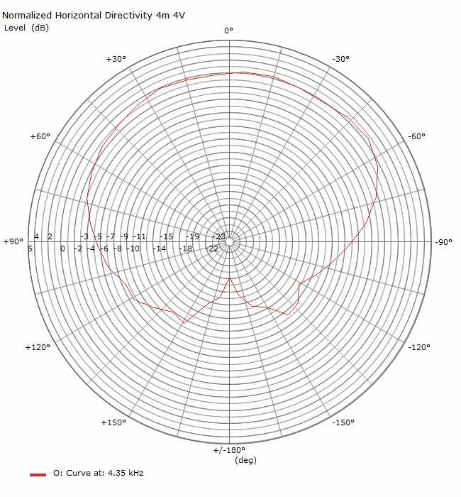

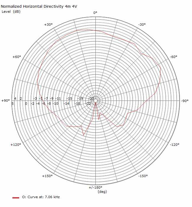

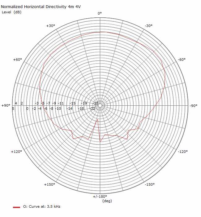

Here are the Horizontal tweeter polar plots at various frequencies, for a tweeter mounted in an 8" wide baffle:

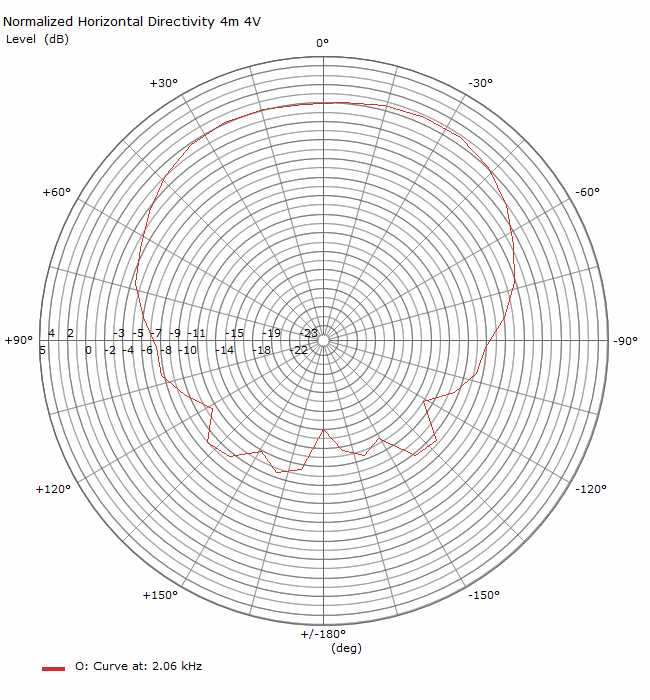

Notice Baffle Bulge at 2.06KHz, +/-45 degrees off axis, especially on the upper right (+30 degrees)

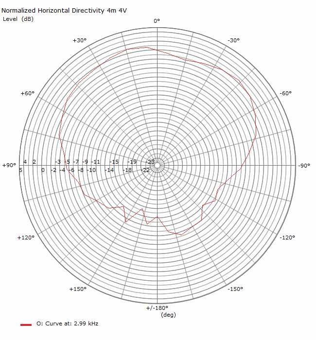

Notice Baffle Bulge at 2.99KHz
Notice Baffle Bulge at 3.5KHz
Notice baffle Bulge at 4.005KHz
Above at 4350Hz, the Baffle Bulge has almost gone away.

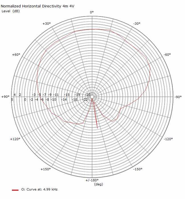

Above at 4.99K the Baffle Bulge has gone away and is starting to turn into an on-axis Baffle Beam
At 5K there's a trace of Baffle Bulge.

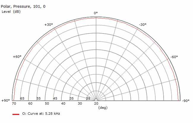

Slight beaming at 6K
Baffle Beam is tilted about 15 degrees to one side, above
Above 8KHz the dome's natural dispersion limitations start to kick in (which are NOT modeled in these graphs.) Meanwhile, as you can see, the front baffle drops the +/-90 degree SPL by 5-8dB and we get beaming from the tweeter in the 4-8K range that is similar to what we get from a woofer or waveguide.
So here’s the playbook you can use to create a Zero Horn Constant Directivity (ZHCD) design:
-You set the crossover frequency at Cabinet Width = 2.5X to 3X λ.
Handy-dandy formula in inches: Crossover Frequency = 40,000/cabinet width in inches
Handy-dandy formula in centimeters: Crossover Frequency = 100,000/cabinet width in CM

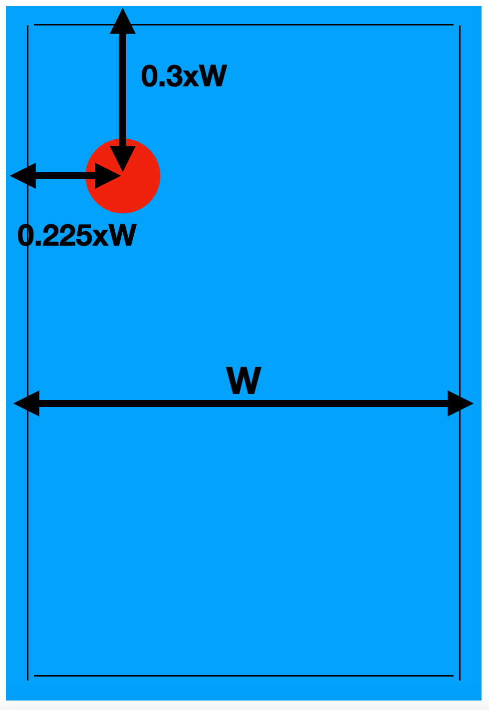

-Tweeter should be off center. A very good spot according to Jack’s simulations is:
Horizontal Position = .225W
In other words left tweeter is 22.5% of baffle width from left edge; right tweeter is 22.5% of baffle width from right edge.
Vertical distance from top = 0.3W
Tweeter is 30% of Baffle Width from top edge.

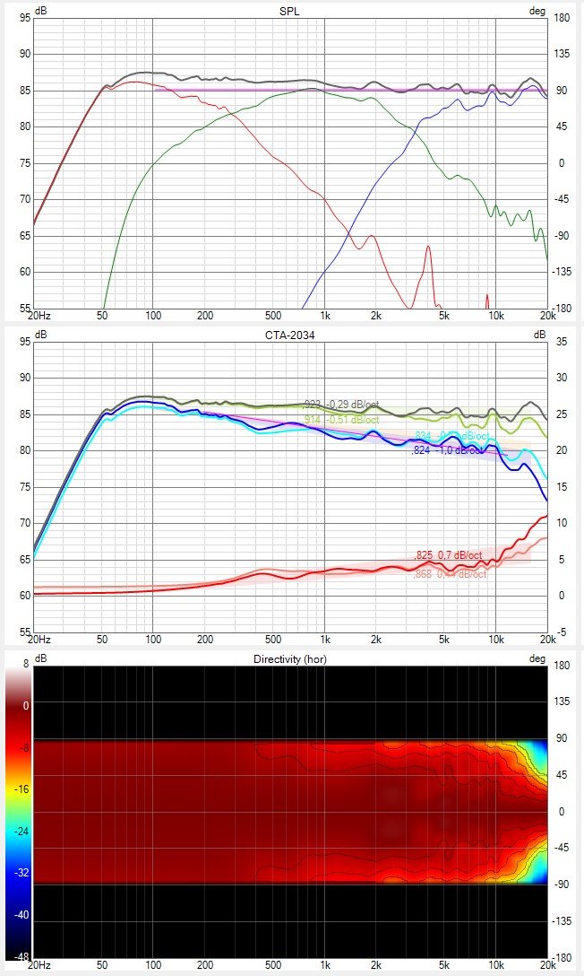

You've probably seen these threads, but I think it's on-topic here:

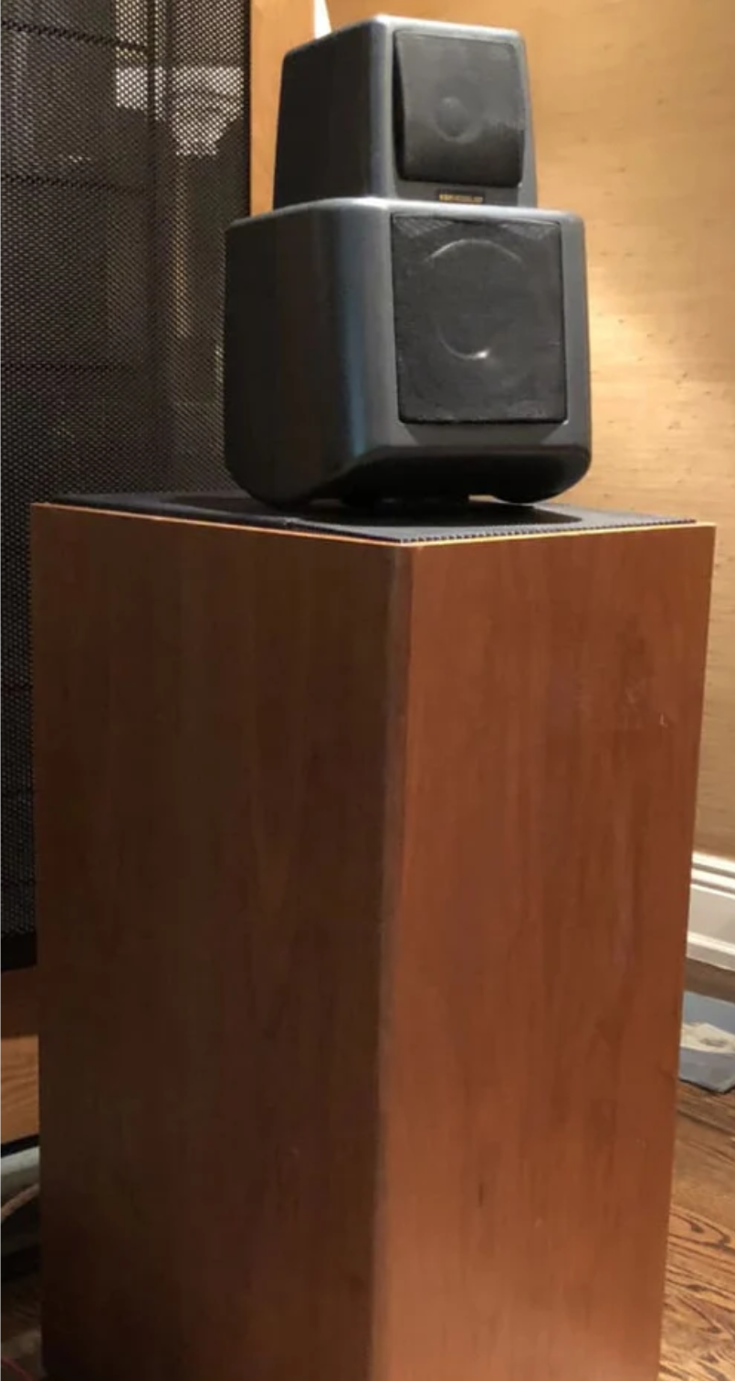

First off, I bought one of Earl Geddes' last set of the original Summas, largely based on curiosity about the waveguide and it's performance, as well as Earl generously listening to all of my noob questions for hours when he premiered them at RMAF in 2005. One of the surprising things about the Summas, was that the cabinet was arguably more innovative than even the waveguide. It's really something else. Turn the lights off, and these speakers that are the size of small refrigerator, they sound like a speaker that's 10% as large.
Second -
I think you can achieve about an octave of "directivity control" by juggling the width and the depth of the loudspeaker enclosure. I believe this happens because the wavefront that is radiated is transitioning from half space to full space but it is neither half space or full space.
It is in that 'transition zone' where the polar response looks similar to what you can accomplish with a waveguide. Tons of speakers leverage this; Revel and Kef in particular.
I believe the reason that we see this "waveguide like" effect is because the wavelengths in that 'transition zone' are larger than the width of the baffle but not so wide that they dwarf the size of the enclosure.

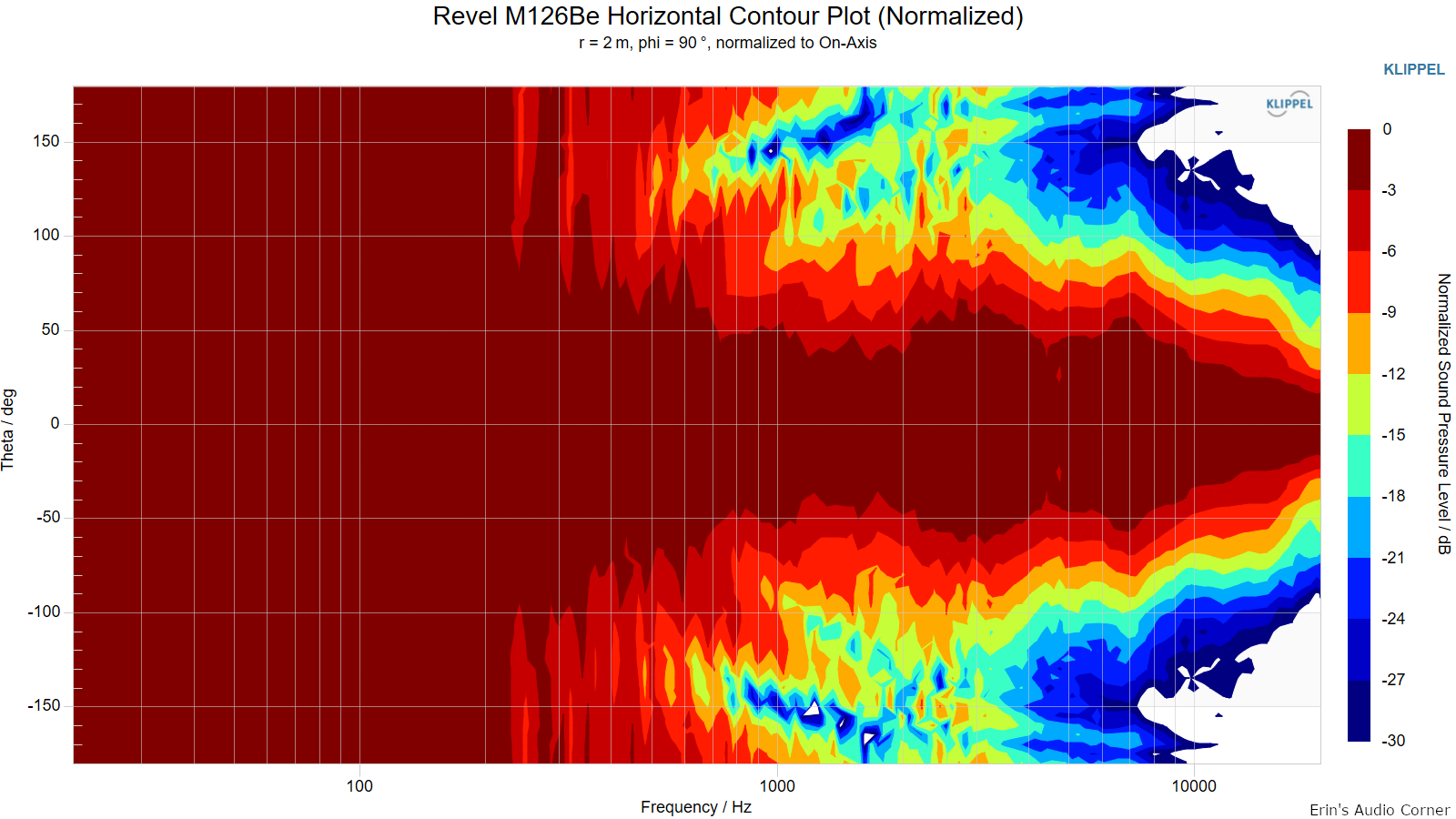

Here's an example:

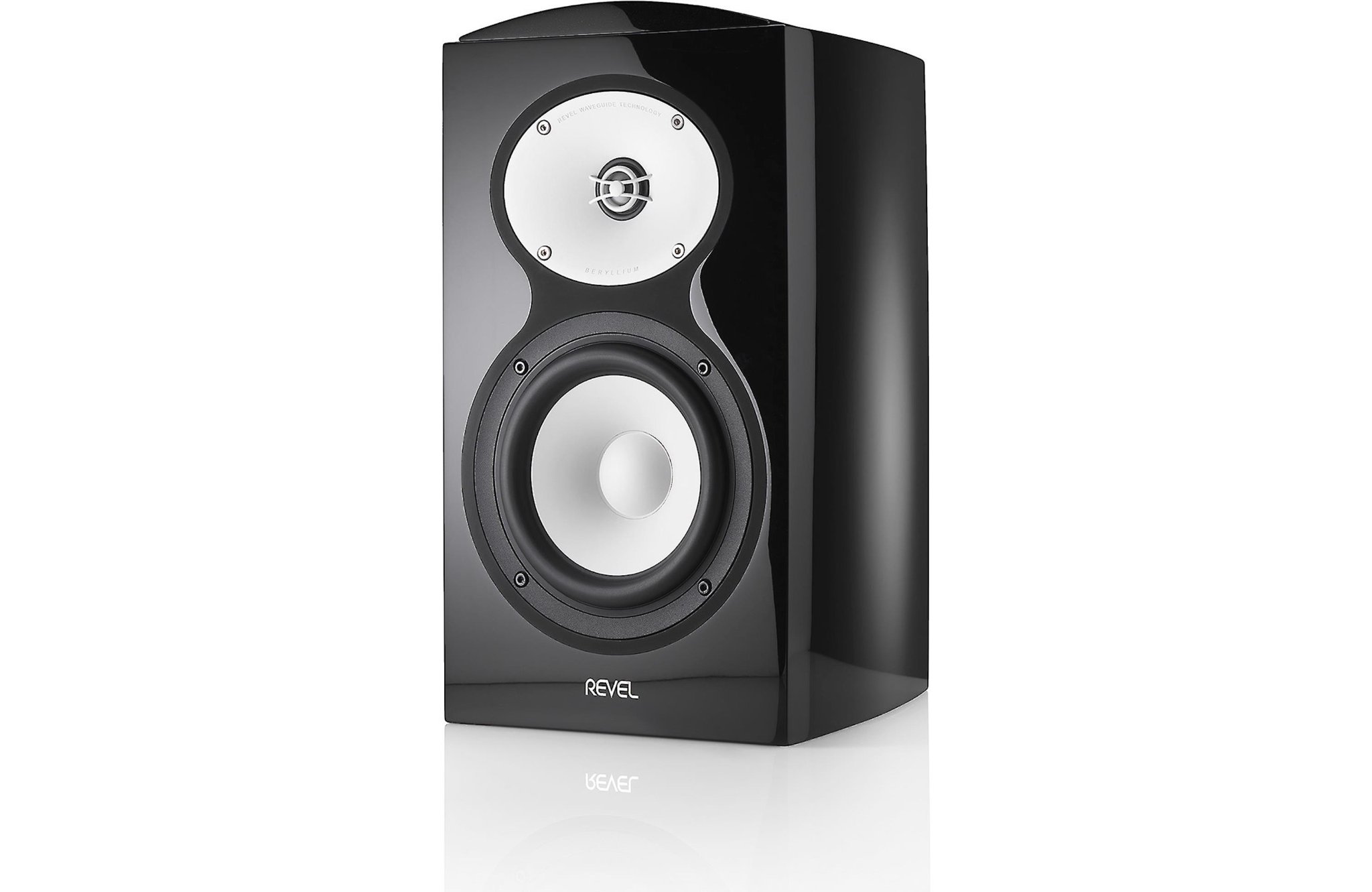

The Revel M126BE is 20cm wide. The waveguide is approximately 15cm wide. We would expect the waveguide to lose beamwidth control at 2300Hz on an infinite baffle. But the loudspeaker maintains a beamwidth of approximately 100 degrees down to 700Hz, far lower than one would expect. I believe this is due to the phenomenon described above.
Kudos to Erin for the measurements, and to Mabat for writing software that makes it possible for people who can't figure out ABEC (like me) to simulate the enclosure easily.
Something I've wondered, is if it would be possible to push that frequency even lower by repeating the process that works with the M126BE, but adding a woofer below the midbass, similar to the enclosure of the Kef 107.
If any of this sounds interesting, check out this thread: https://www.diyaudio.com/community/threads/loudspeaker-enclosures-are-waveguides.363630/

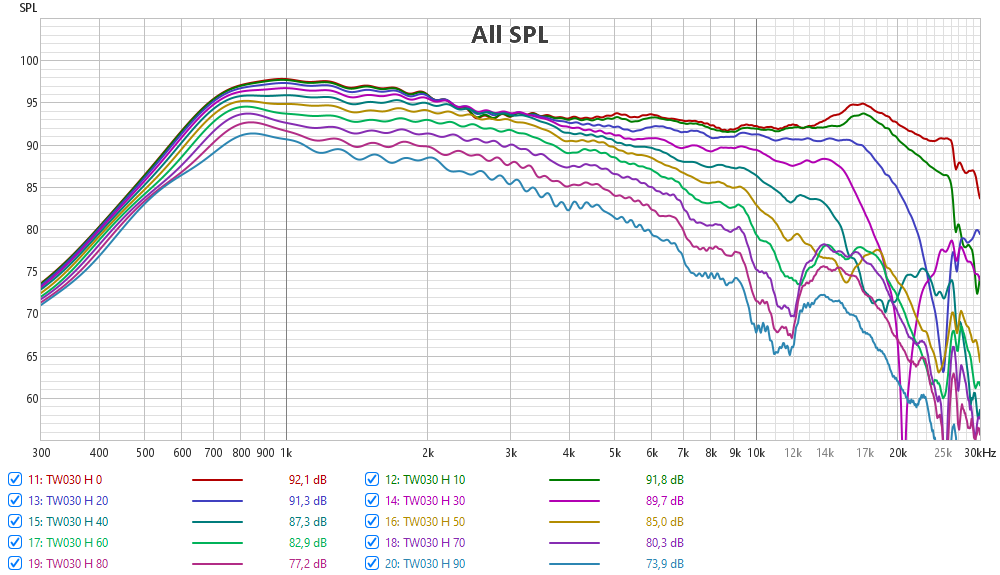

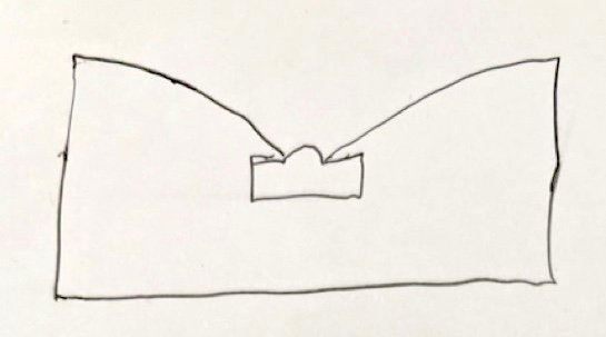

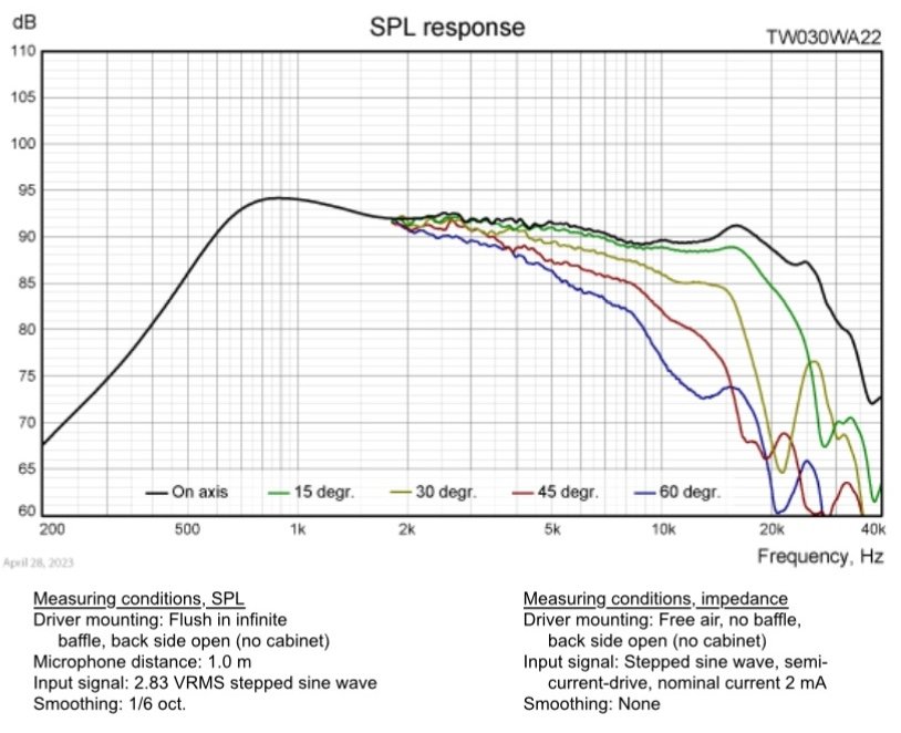

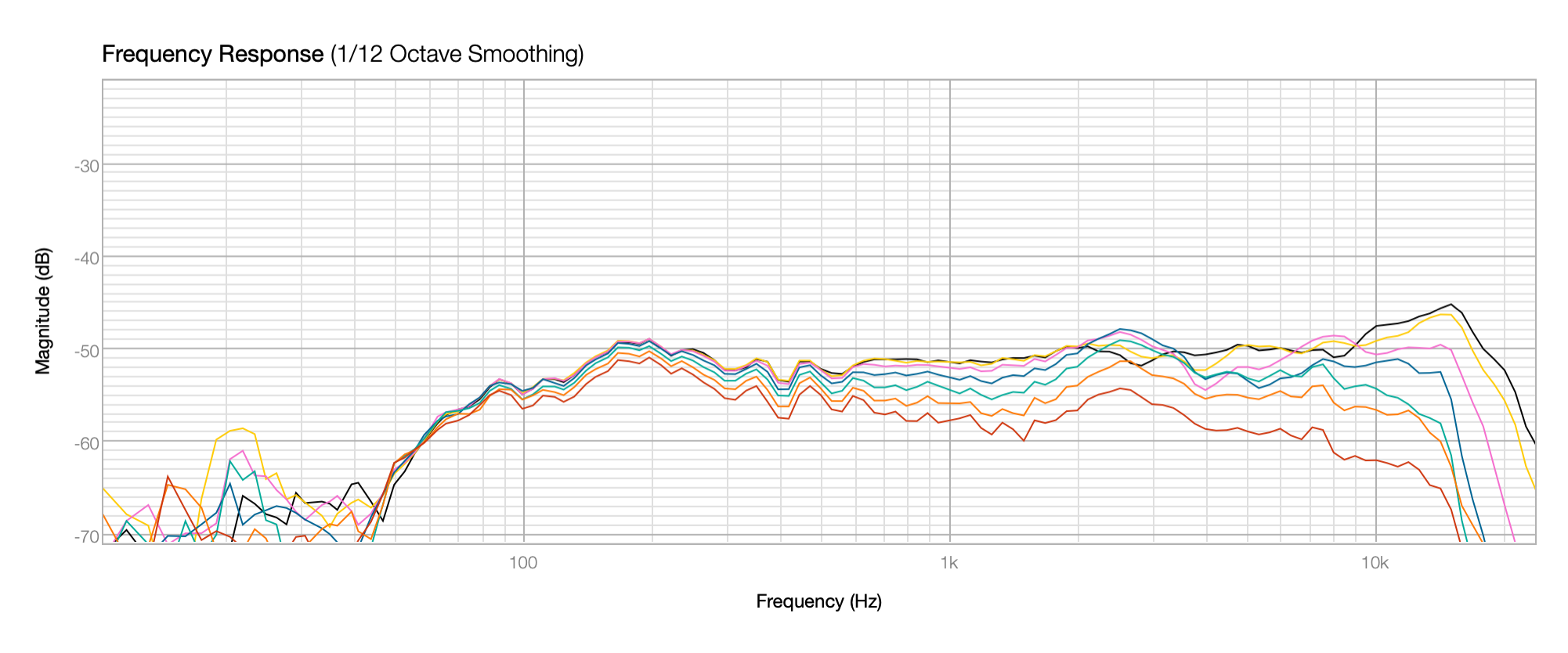

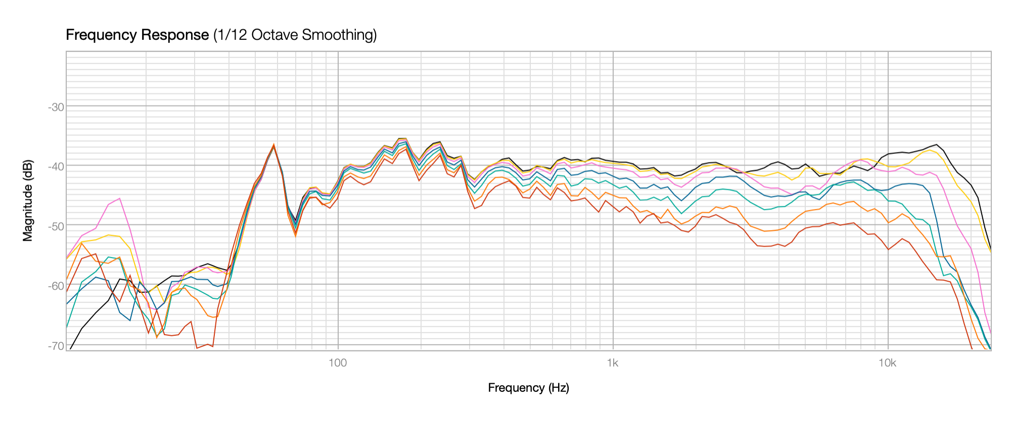

Hi Patrick, YES you're right, and in fact a Summa- or KEF 107-like speaker was a big clue to unraveling this, which I hadn't mentioned. I had a discussion with @PKAudio about some Wavecor Tetoron 30mm domes he was selling right here on the forum. He posted these curves:
...in which you see gorgeous CD behavior all the way below 1KHz. But I looked up the Wavecor spec sheet and found this:
Huge difference! In Infinite Baffle the CD behavior doesn't kick in until 2KHz and above, so I asked him about it. I asked him if it was even the same tweeter. He said:
"My measurements are from the real baffle which helps to improve the directivity and minimize diffractions a lot. Additional mild offset of the tweeter to one side would make the responses look ideal without any signs of the diffractions." He posted this photo:
His enclosure looks to be 8-9" wide, similar to mine with the Focal 5" woofers, and with generous round-overs he's basically extended the curvature of the waveguide backwards. @PKAudio made a tweeter with a 4" factory waveguide act like an 8" waveguide, using wide roundovers. Very well behaved, too.

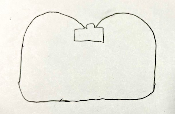

So here's the new way I've come to think of it -
This is a waveguide:
...and this is a waveguide too:
In fact #2 is arguably a better waveguide than #1.
That means we shouldn't just think of a horn / waveguide as a "90 degree" or "120 degree" or even "180 degree" device. We should think of a horn as a 270 degree or even 360 degree device!
To your point about the Revels, it has a more graceful transition from half-space to full-space than waveguide #1. And it's certainly more useful than the small waveguide.
A lot of this has to do with how much work you're willing to put into the roundovers.

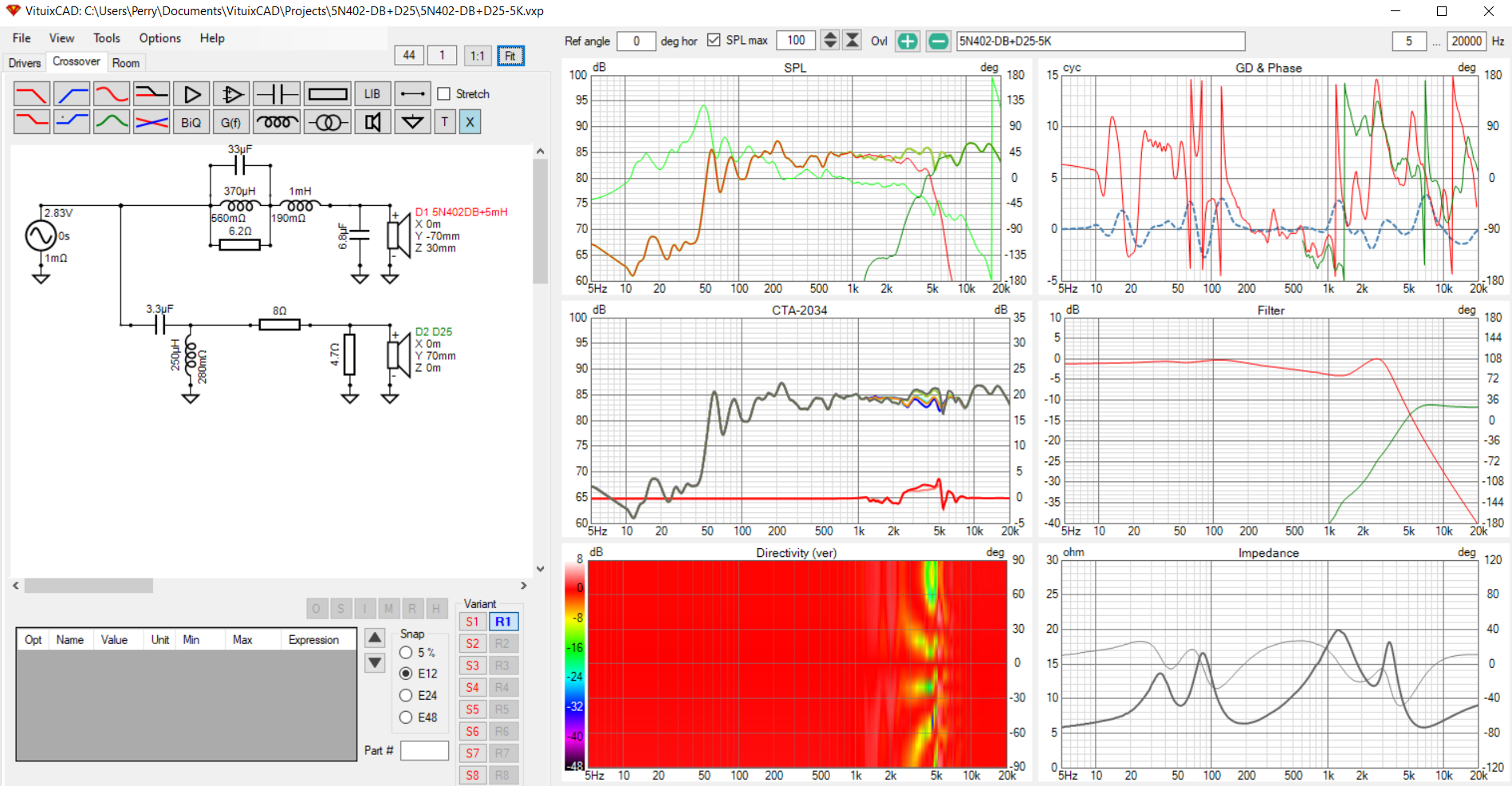

This is the crossover I designed for the 5" 2 way with the Focal 5N402-DB. The 5N402 has a dip at 2500Hz which in my original attempt seemed to help with the 1700Hz crossover. But after I abandoned the 1700Hz crossover and went for 5KHz instead, I needed the crossover to increase the gain at 2.5K which I achieved with a high-Q rolloff which peaks at 2.5K. The 1MH+6.8uF handle that part.
Here is the VituixCad screen:
The 33uF / 0.37MH / 6.2ohm notch filter on the woofer deals with the Baffle Step and corrects a peak that shows up @ 1.2KHz. This is a dual voice coil woofer and one coil has a 5MH inductor in series. This was Focal's recommended approach to Baffle Step with this driver and was the reason for the DVC design.
The driver as modeled here in VituixCad as a composite of Coil 1 and Coil 2 + 5MH inductor, with combined impedance and SPL all rolled together as one driver for this simulation.

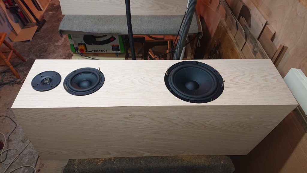

Here’s another speaker that has arguably fantastic DI and a similar concept in baffle function
It was discussed many years back here for its performance value
While never investigated as far as I know, I always believed those slot ports on either side of the tweeter had something to do with it…….likely there’s no simulation available though.
The nearly 9” woofer I suppose drags the directivity point needed for the tweeter lower and the steep filter allows for the lower XO point and directivity match?

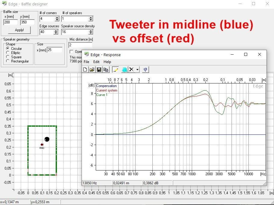

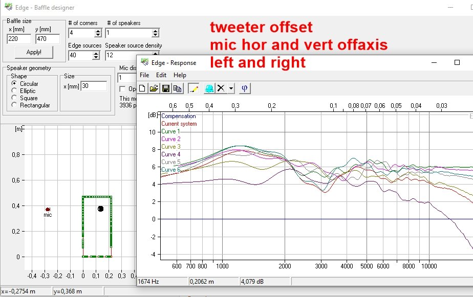

Horizontal directivity alone can be optimized by expence of vertical. Also slope order plays a role, overlapping range is interesting! Surpisingly small changes will make difference. Just comparing single driver's off-axis responses is not enough to determine ideal xo!
Baffle dimensions and driver location are also important for the tweeter (above 2kHz). Offset will improve axial response at the expense of off-axis and symmetry, but this can be beneficial for listening window average. Some designers prefer 10-15deg off-axis response as priority (before VCAD)
Some quick sims below. VCAD sims with real measurements and different xo types would be fantastic...
