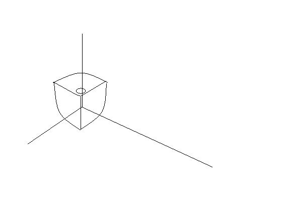

A few years back when I worked the Montreal audio show, a local guy had built some single driver corner horns of a strange configuration. But they worked really well, even though they were too far apart. Will see if I can find a photo.
Could not find any photos of my own, but here are some off the web
Made by First Octave Audio of Canada (Andrew Vanderkruk). The Angelica corner horn. As you can see, they use the corner as an up firing horn.
Don't know how constant directivity they are, but they did image well.
I believe that Andrew also made a version with the Altec 604.
